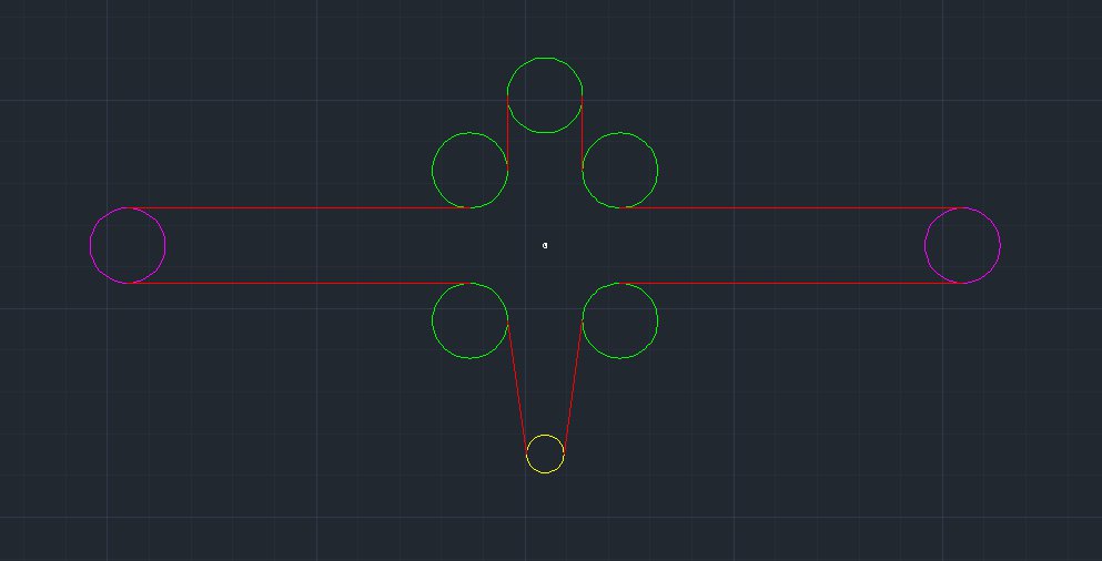

    If i use one motor and two ballscrews i have to tension the timing belt
    The follwing us a 2d plan i made in order to tension the belt
    The magenta cyrcles are the ballscrew pulleys
    The yellow cyrcle is the motor pulley
    The green cyrcles are pulleys with no tooth
    The motor and the green pulley above the motor will be movable in order to tesnion the belt.
    The red colore represent the timing belt
    And finally my questions
    1. Do you think the above plan is a good solution for my case?
    2. can you tell me what pulley width should i buy?
    3. Do you now any suppluyer with good prices an quality for such pulleys and belts?
    4. Does the timing belts have rpm threshold?
    5. If i tension the belt that way ( above plan ) would that reduse its life
    6. Cast iron or aluminium is better material for pulleys
    7. which case ( case 1 or case 2 that i discribe at the begining ) is better?
    Thank you for your time
    Vagelis

    Option 2 would be best in this case but you may find locating 15mm pitch screws difficult and expensive.?
    #1: Really You don't need the upper tensioners just make the Motor adjustable to tension belts. But yes it would work.!
    #2: 15mm belt width will work fine.
    #3 Sorry no I buy local.
    #4 Yes but much higher than 1500rpm . . Think about Timing belts in Car engines.!!
    #5 Can't see why it should provided the tension and alignment is correct, most common cause of belt failure and premature wear is incorrect tension or alignment.
    #6 Aluminium will reduce inertia on ballscrew but wear quicker than Steel but again if correctly tensioned and aligned then not an issue. I've had aluminium pulley on my machine for over 5yrs and it's still fine.
    #7 See above but Like I said before 2:1 with 10mm pitch will be fine I tell you this through lots of experience not theory.!!
