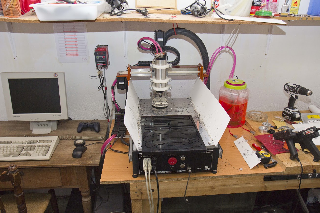

    in fact i did just the same at the beginning. It will heat and eventually break. I had a Mercedes screenwash water tank and VDO brand pump. I fixed a PC cooler fan on the pump and run it at 6v. One day it broke. It heated a lot and made a lot of noise.
    Its up to you but if you go to a local pet store for 20eur you can have a perfect 1000lph pump, if you dont want spending 32euro on the ebay one/3000lph/.
    What power spindle was that with? Mine is 800W.
    I'm actually leaning more towards using the separate pump and container as I'm not really that convinced the screenwash pump will last very long. I had a brainwave today on the tank. I've got a tall small footprint plastic food container that could be a good tank and I can make some bulkhead mounting pipe fittings using hosetail connectors and a nut and washer.
    My spindle is 800w. Thats what i am telling you, the screenwash pump will not last even if coooled by pc fan and makes a lot of noise, plus you need a 2-3A power supply at least to run it. Will not run with a smaller than 1A.
    Here is a picture of my setup. Note that at the picture is not seen but now i have a bar which is fixed to the spindle and holds together the cable and the housing straight vertical, to avoid twisting of the cable and the hose. As this bloody chinese spindle cable connection was giving me problems:
