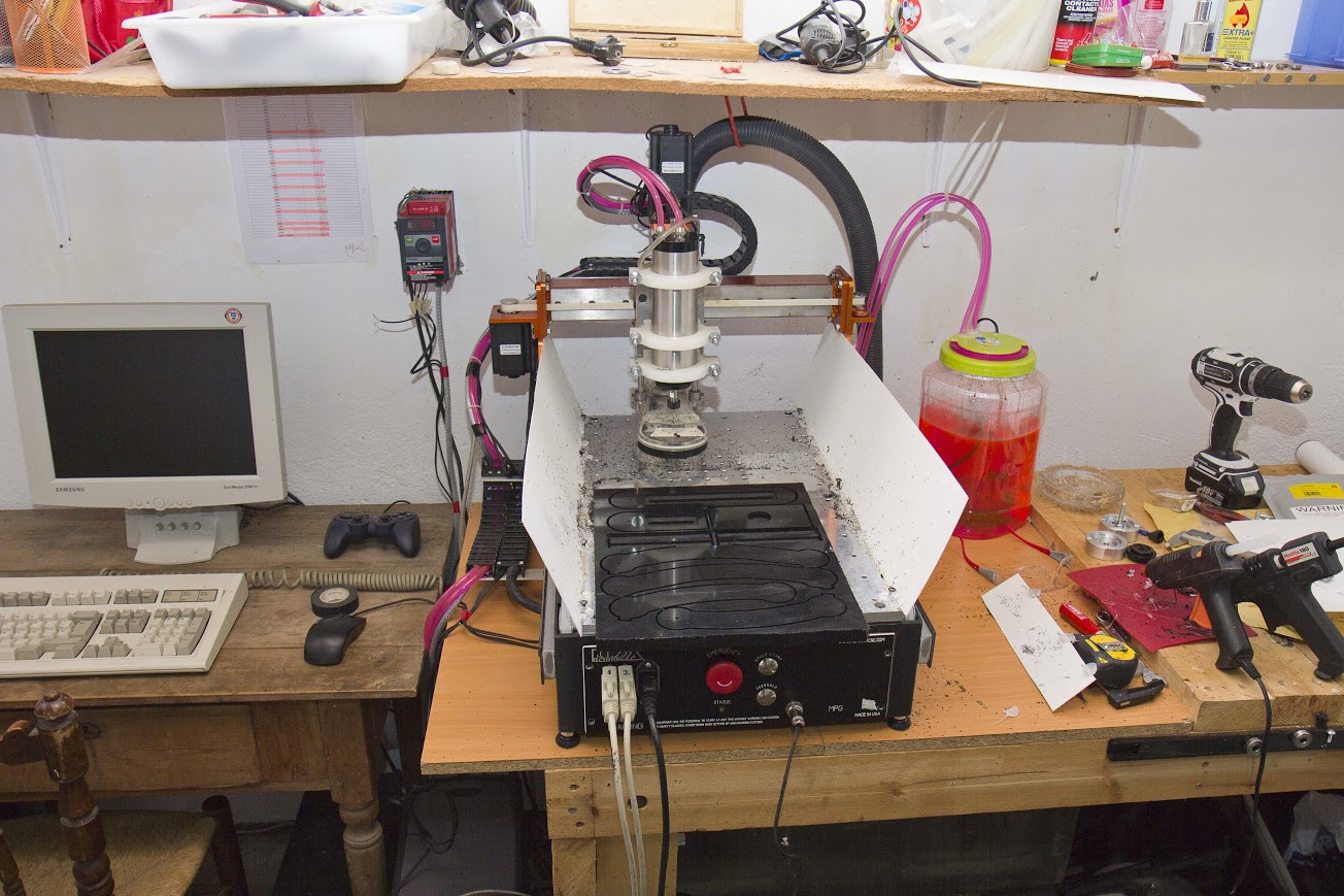

    My spindle is 800w. Thats what i am telling you, the screenwash pump will not last even if coooled by pc fan and makes a lot of noise, plus you need a 2-3A power supply at least to run it. Will not run with a smaller than 1A.
    Here is a picture of my setup. Note that at the picture is not seen but now i have a bar which is fixed to the spindle and holds together the cable and the housing straight vertical, to avoid twisting of the cable and the hose. As this bloody chinese spindle cable connection was giving me problems:
