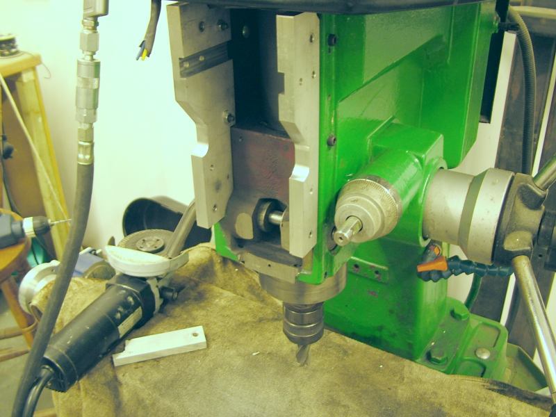

    I am still struggling to understand how the Z-mechanism will work. Does the 'honking plate' clamp to the quill flange under the head and, if so, where does the remainder bolt to on the head itself. What is the advantage of that over motorising the quill handle itself?
    On the X-axis, I can understand why the motorised element sticks out so far to allow more X travel, but again, how is that better than driving the handwheel end? And could it be done without it sticking out so far as this would give me space problems?
    I know Kip has done something similar.
    I've yet to strip it down and draw it all up to work out how to do it, but just starting to do some planning for later on this year.
    Hi Irving
    Let's not forget that trying to screw this kind of accuracy out of a Warco mill/drill puts us deep in to the realm of silk purse and sow's ear. Silly has already been left way behind
    Motorizing the Z axis handle would be much more in keeping with the machine, but you would never push the boundaries that way.
    Would you like to have the z-axis I'm ripping out? It's much the same as the one that's going in but a lot less beefy and made without the benefit of cnc.
    One more set of pics and the operation should become clear.

    I'm doing it the same way I did last time, the screw housing bolts to the honking plate. Only difference is I'm using 2 screws this time instead of one. I think it needs a bit extra to lock the screw parallel to the quill.

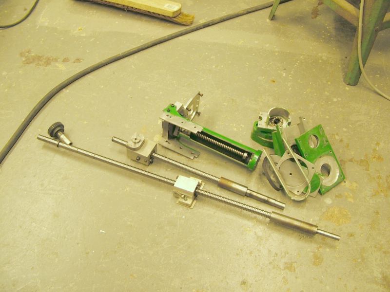

    Not exactly pretty but you can have the X and Y screws if it helps They are cluttering up the workshop, probably going in the bin next time I tidy the shelves. If I find a box I could send the whole she-bang standard parcels.
    I bought zero backlash nuts from Marchant Dice for the X and Y, odd things that you had to crush sideways to set. I never got the backlash below 3 thou. Also I didn't get the ends machined, just glued on extension sleeves with Loctite. With the benefit of hindsight, a false economy.
    The Z axis was a disappointment, nice screw off ebay but I didn't eliminate flex and it always fell slightly short of the mark. I'm hoping the honking plate will fix that.

    Honking plate is the word indeed....I'm going to aim at 63mm thick for my honking plate.

    If your thickness goes beyond the height of the lump you are clenching it on to, surely it will be in the way, one way or t'other.

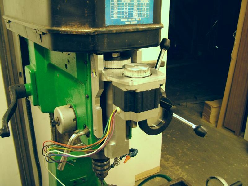

    I did cut the extra relief in the cheeks so the motor plate can slide home then bored and faced a 40t XL pulley to fit the ball screw shaft.
    Took the camera but forgot to put the memory card in it so no pic.
    Robin
    Me again
    Put the pulleys on, belt was too short.
    Checked all the measurements, I don't usually get a belt wrong.
    Eventually found I'd mounted a 44t pulley where a 40t was required
    RS seem to be taking orders at 7pm for next day. Wonder if I'll have it tomorrow. Perhaps it will it be a 44t pulley in a 40t bag, don't remember buying a 44t, fairly sure it said 40t on the bag :naughty:
    Robin

    40t pulley just arrived. RS must be slacking, I ordered it at least 11 hrs 30 minutes ago :naughty:
    You must feel awful so I'll not mention that I intend using a pair of 30mm SC30UU linear bearings to prevent the trig equation needing to be worked out :D

    My thought on the swivelly bit at the bottom..if it twists it shortens the effective length of the ballscrew=bad?
    I don't think it can twist without bending the screw, I didn't stint on the metal :nope:
    I now have the 40t pulley and belt in place with a faux honking plate fudged out of a bit of 2" x 3/4" iron.
    It feels good, any shift on the motor moves the handle, moving the handle spins the motor. I would have wired it up but when I looked for a bit of chocolate block connector all I could find was 80A
    Time for some G-code to make the real honking plate
    Robin
