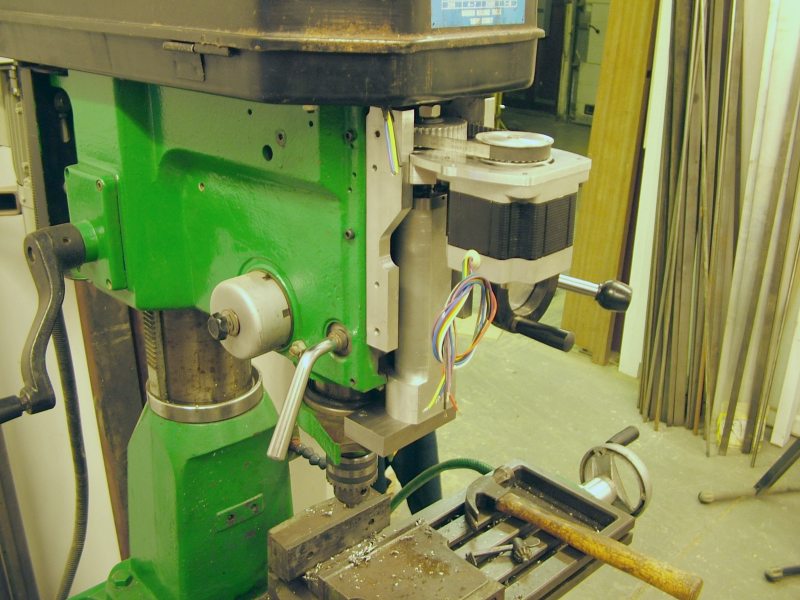

    40t pulley just arrived. RS must be slacking, I ordered it at least 11 hrs 30 minutes ago :naughty:
    You must feel awful so I'll not mention that I intend using a pair of 30mm SC30UU linear bearings to prevent the trig equation needing to be worked out :D

    Strangely true, when I looked in the box I found an empty 44t packet and a brand spaking new 40t. Nice to have a spare I suppose
    My thought on the swivelly bit at the bottom..if it twists it shortens the effective length of the ballscrew=bad?
    I don't think it can twist without bending the screw, I didn't stint on the metal :nope:
    I now have the 40t pulley and belt in place with a faux honking plate fudged out of a bit of 2" x 3/4" iron.
    It feels good, any shift on the motor moves the handle, moving the handle spins the motor. I would have wired it up but when I looked for a bit of chocolate block connector all I could find was 80A
    Time for some G-code to make the real honking plate
    Robin

    Is 'honking plate' a real term or one you made up to describe a 'big lump o' metal'?
    I am looking at the pics but still not seeing quite how the quill gets moved... and still moves the motor when you turn the quill handle...
    The frictional losses on a ball screw are low. The screw can turn the nut if you have the means to push hard enough.
    Spin the motor by pulling on the handle and you can feel if something is binding. Should be smooth
  9. Quote Originally Posted by Robin Hewitt View Post
    Ah, what is the lead on the screw... I hadn't realised it was that big a lead. But what stops the quill dropping under its own weight then when the motor is powered off? Or is there sufficient stickiness in the cogging to stop that?
  10. #40
    It's 5mm lead, the 32:40 pulley reduction gives 4mm/motor rev
    The quill return spring is there but it wouldn't drop under it's own weight anyway. You gottta pull to spin it.
