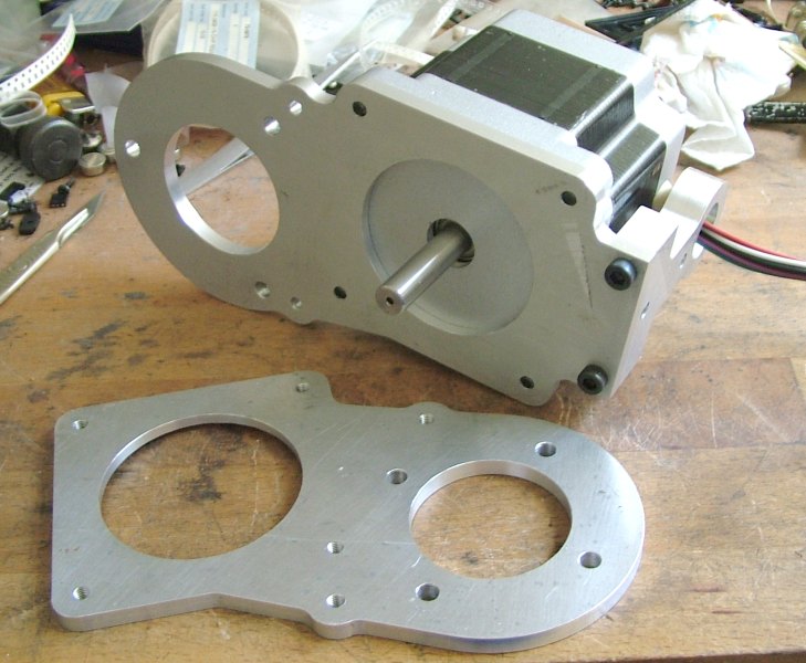

    However, 18mm/s is a lot better than I had before so I made new plates to fit them on the X and Y. Stuck a fanciful strain relief bracket on the X so I can bolt the flexy trunking to it.

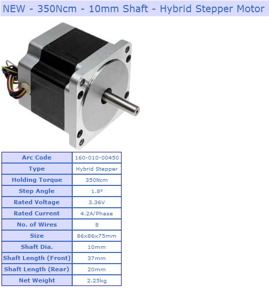

    I'm sitting looking at the motor spec sheet and it shows parallel as 4.2A/phase, but series as only 3A per pair. Sounds illogical
    If I knew what "hybrid" meant it could explain it...
    ...perhaps
  9. That motor is 4.2A in unipolar and 3A in series and 6A in parallel.
    If you are connecting it is parallel and only giving it 4.2A, you are under powering it.

  10. If I knew what "hybrid" meant it could explain it...
    As I understand it, Hybrid motors have a magnetised rotor as opposed to the soft iron cores used in earlier types.
    That makes it very unlikely to be motor saturation :(
