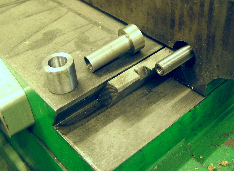

    Today I reworked the tapered Gibb strip fixings.
    The original adjusters are totally naff allowing the the Gibbs to move, so they went from tight to loose as you reversed direction on the slide :nope:
    To fix it I fitted 35tpi x 3/8" studs, screwed the adjusters on to them, (still sloppy) then bolted on end caps to pinch it all together... TIGHT

  2. That's a good idea Robin, consider it stolen ;)
    I have a small snippet of steel wedged between the adjuster and gib ATM doing the same job.

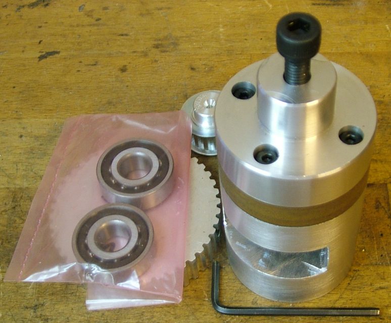

    Started on attempt #2 at a faster spindle because the bearings are unhappy if I try to run the main spindle up to credible small tool speeds.
    The fast spindle is an ER11 chuck fitted to the honking plate and driven using a 1:3 timing belt off the main spindle.
    Same axial bearings and Belleville washers that have served me well so far, but less than the 1/4 ton preload this time.
    I've been looking at those splendid tool location doo-dads based on an electrical contact between tool and workpiece. As featured on this very site
    To that end I have added Tufnol insulators to the shaft housing. No electrical contact between tool and machine body until it hits the workpiece.
ID:	933   Click image for larger version.
  9. #69
    Spindle housing now bolted together and impossible to assemble :nope:
    Have to add a bit of internal clearance so the pulley can get past the belt :whistling:
    Measured the resistance top to bottom, slightly worried when I found 8 million Ohms then realised I was in the circuit. Moved fingers and it went away
