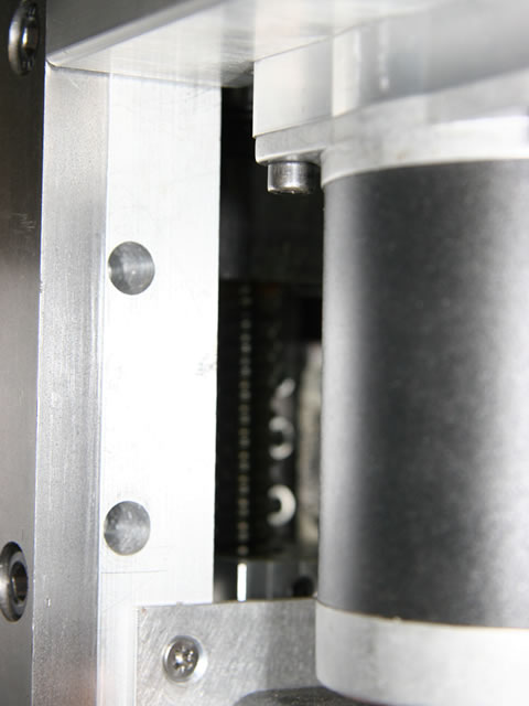

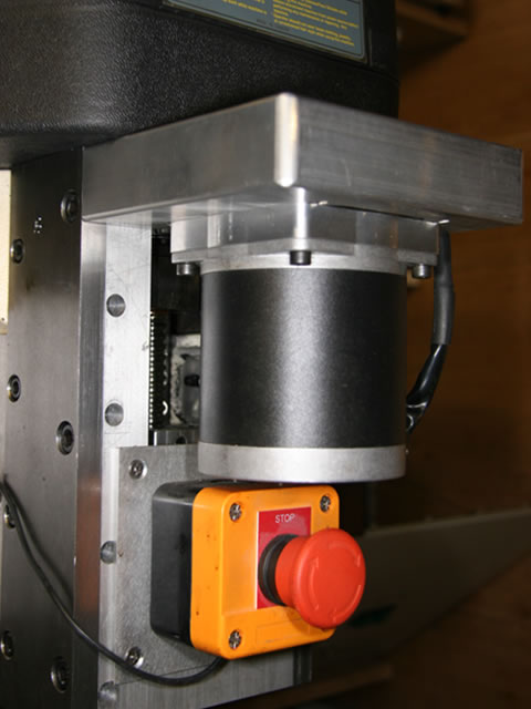

    I added the belt covers on the X, Y and Z motors.
    The factory fitted screws holding the z axis motor together stopped 3mm short of the base. Not much but enough to hold a flexi conduit fixing so I could tidy the wiring up.
    If I'm doing pretties I must be nearly there. The ultimate aim is to cut injection tooling, so thought I'd try the fast spindle and instantly found I needed yet another belt cover :heehee:

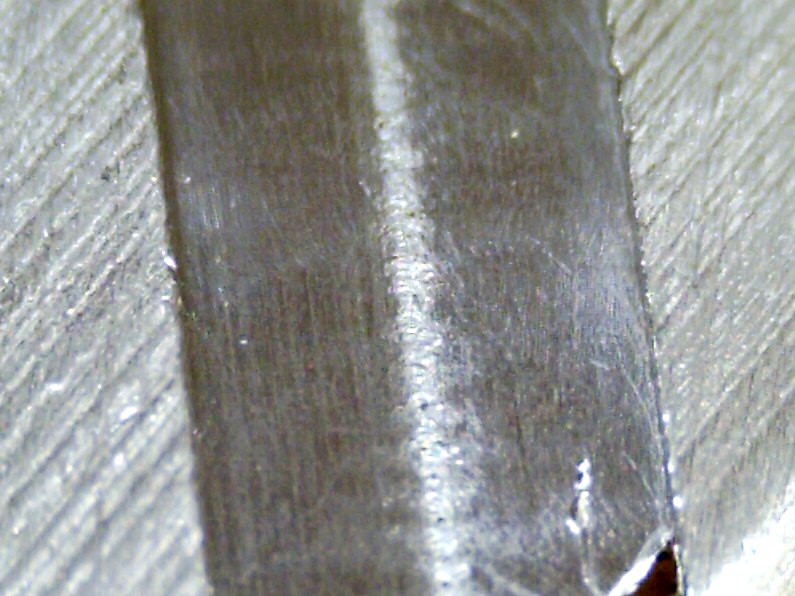

    I cut a 3mm slot 0.5mm deep across a piece of aluminium at 6100rpm. A fairly good mirror finish resulted except the centre of the cut where the tool proved a mere approximation to centre cutting
    Extreme close up of the cut below. I measured the width at 3.00 to 3.01mm so runout is around 5um, not bad considering the ER11 collet was only finger tight.

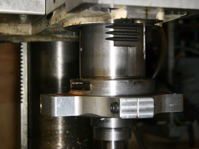

    I have read the whole build and it brought back memory's as i have a similar mill, i hope Robin does not mind me adding some info of how i tackled the problems.
    My biggest issue was the Z axis namely the play of the quill in the headstock. I also made three failed attempts at cnc'ing the Z
    My own quill had just over .1mm slack which is abysmal, i had a quote to hard chrome the quill and grind it to size of £300 and thought there must be a better way.
    I cut through the front of the headstock with an angle grinder also at the top of the headstock to allow the quill bore to become flexible in diameter.
    So now the quill was too tight, so i have adjusting screws that allow me to open the bore for the quill this allow me to get a beautiful fit of the quill in the headstock tight enough that there is no play but free enough that there are no issues with lost steps.
    To CNC the Z i based my design on a Bridgeport mill (Getting the Nut As Close To The Quill As Possible) which i have also, by machining a slot in the quill i have mounted a custom housing that takes the ball nut it is made in steel and by using two strips of steel in the headstock i can take all the wobble out of the quill.
    In fact i have the quill rotated 180 degrees in the bore as that was where it seemed to slide as easy as possible so now the the teeth for the gear are at the front.
    It has two steel cheeks attached to the headstock and looks very similar to Robin's in that respect.
    I do not suffer from flex in the column and my belief it that the flex in Robin's machine in fact comes from the poor fit of the quill.
    Although clamping the quill will minimise problems it will not eliminate it completely.

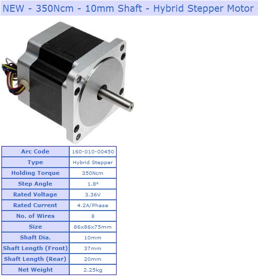

    Gary was no stock on the motors at the time so I got them from ArcEuro. I think they are the same motors wherever you go.
    I never measured the actual voltage at the motors, I soldered and shrink wrapped everything before I plugged it in. Not sure I want to measure it at the driver end either, I am a bit nervous about exploding voltmeters. I used fat wires with fat insulation, had to cut part of the wire core away before it would go in the driver connector. Overkill perhaps, but I don't expect much in the way of losses even on the long run to the Z so probably around 200VDC.
    The drivers aren't cheap but as they plug straight in to the mains you save on the PSU, also you can be fairly sure you won't have to replace everything later due to a lack of volts at the motors like I did.

    Hi Phil,
    Robin is correct. I would love to see a more indepth view of this too. (PLEASE).
    Well as I was asked so nicely I will start a new thread.
    Here are some pics to whet your appetite.
    The first is the complete assembly.
    The second shows fine lines on the quill that emphasises the smooth but tight fit.
    The third shows a close up of the ballscrew way deep inside the housing.
    Don't forget that estop button in a convenient place
    Phil
