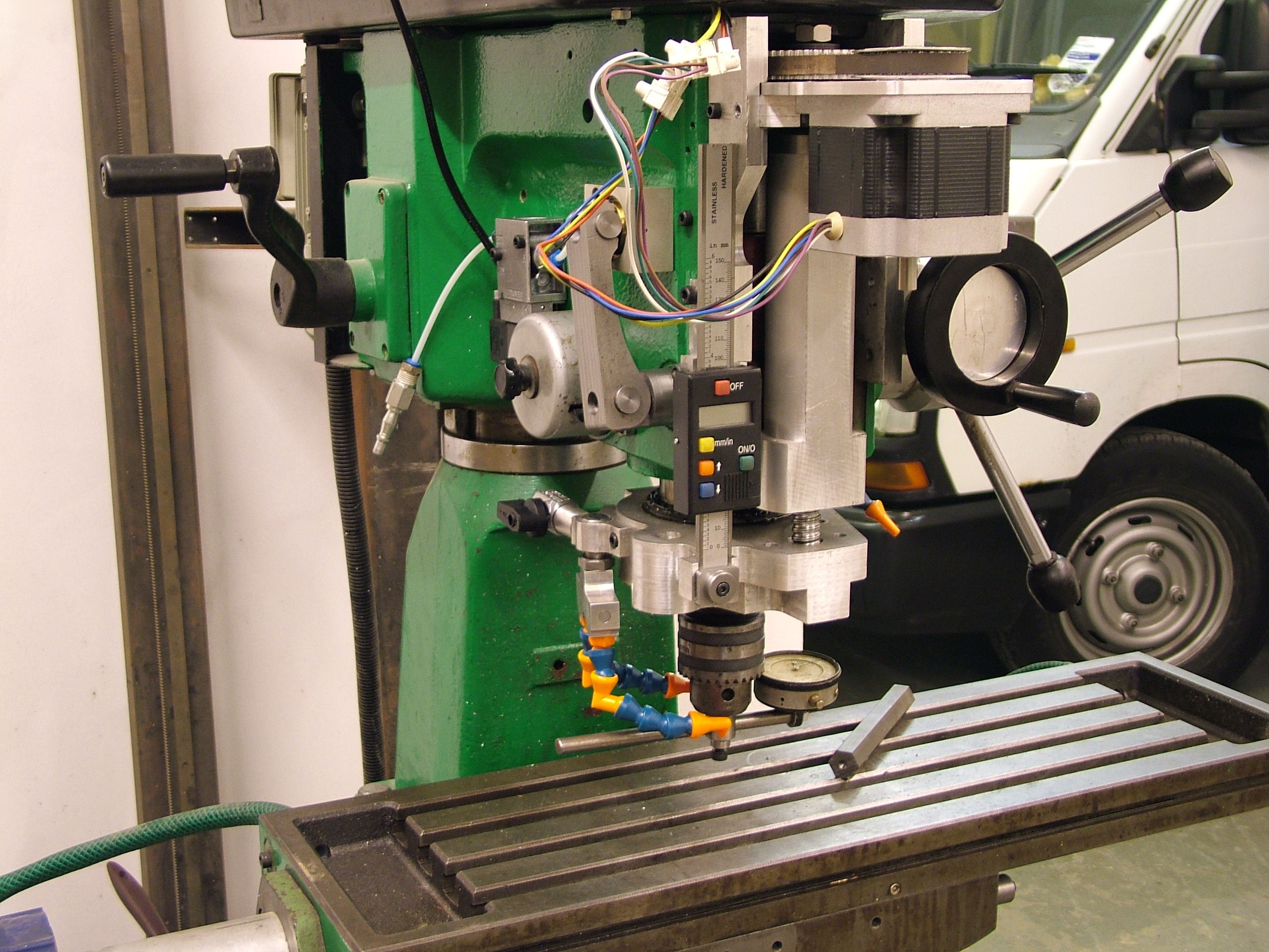

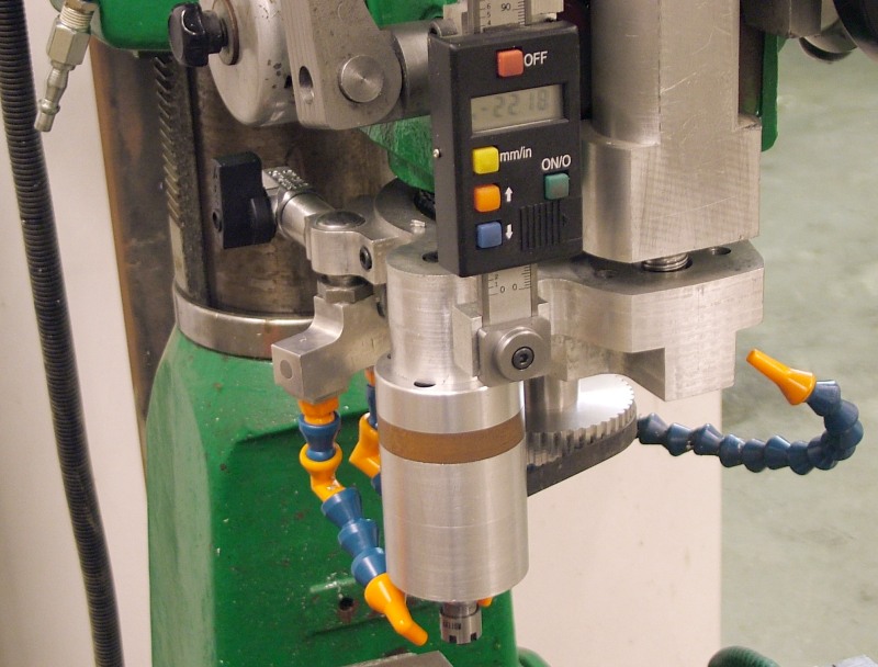

    Stuck waiting for bits
    Did add an air driven spindle lock, now working on the suds nozzles.
    Is that a spindle lock or a Z axis lock?
    Have you a picture of the whole 'honking plate' z axis? (looks good :))
    By Jingo you're right, I used the wrong word :heehee:
    You want a picture from a different angle?

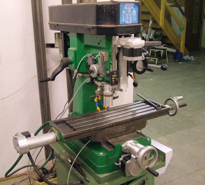

  3. You want a picture from a different angle?
    Just a wider angle showing the whole of the axis would be good :)
  4. #74
    Testing out my new quill lock then the quill jammed
    Two hours finding the problem. Thought I'd got cast iron dust in the guide when I drilled the holes for the pneumatics. Hadn't. Though the clamp was binding. Wasn't. Thought I'd deformed the quill with excessive locking force. Didn't. Thought it had to be gunge, fetched the quill out and got it clean enough to eat off. Did no good.
    If your Warco quill seizes up for no apparent reason and defies all efforts to free it I have the solution. 2 minute job, miracle cure, no disassembly required, will cost you a bottle of Hobgoblin posted to Sussex :naughty:
    Quill now tracks up and down easy peasy, the Z depth on the computer screen agrees with the linear scale on the mill +-0.01mm moving in either direction. However, cutting forces can put them up to .05mm out. Hence pneumatic quill lock.
    Yes, I know 0.05 is only 2 thou
  5. #75
    Quote Originally Posted by BillTodd View Post

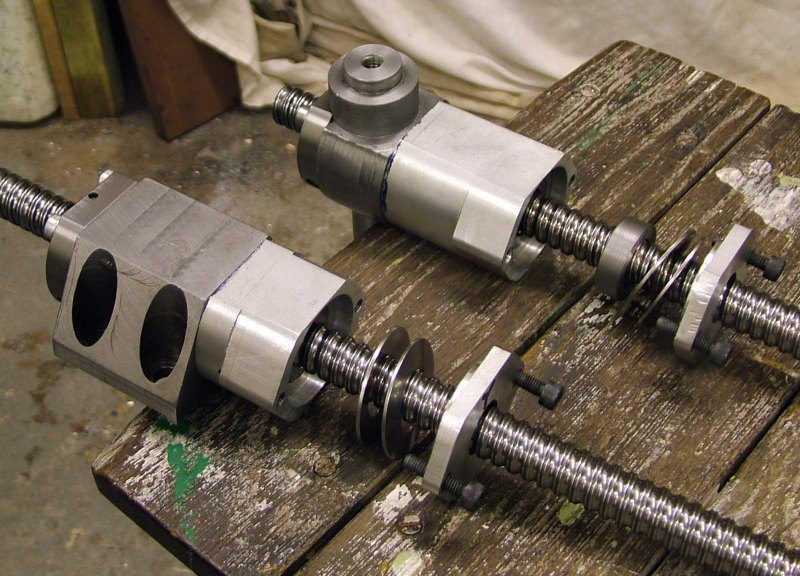

    Here 'tis, and here's a link to the 1.7Mb original image http://www.robinhewitt.net/big.jpg
    I left the Z screw detached from the honking plate, it bolts on from below sort of thing
    Next I have to fix the ball screws, I didn't look after them and 10u backlash has become 75u, at least I think it's the screws. Have decided to spring the nuts and go for true zero backlash :naughty:
    Assuming 1Nm on the screw is enough to move the table under all circumstances, that's 1256N force on the nuts, call it 280 lbf because I don't think in Newtons :heehee:
    I have the design, appropriate Belleville washers have been purchased, waiting for the oil pipe fittings, blooming postal strikes, grumble moan complain.

  6. You've made a nice job of that Robin :)
    I pre-loaded my roller nuts to about 400N per roller. There isn't any actual axial load on my lead screw; the pre load stops the roller moving axially within the nut. That seems OK for manual milling with my machine.
    It's actually hard to tell exactly what pre-load you've set with a belleville you have to guess using a displacement and trust the manufacturer's table for the spring.

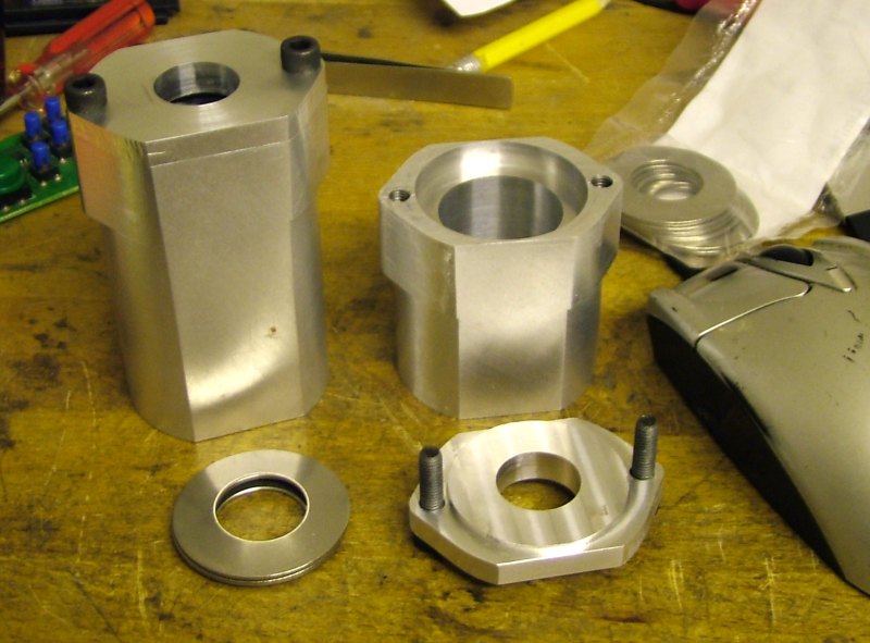

    The extended ball nut housings are now cut, see pic. I plan to rip it all apart tomorrow and try for zero backlash by preloading the nuts
    Ran the fast milling collet today at a tentative 4150rpm and looking good. I'm driving it with 44:13 pulleys off the main spindle.

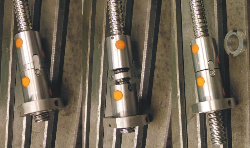

  8. #78
    ZERO BACKLASH ON X AND Y
    Well, none that I can feel anyway :heehee:
    First pic, horrible things done to Gary's ballnuts :naughty:
    Pic 2, Belleville washers just about to get bolted onto nuts.
    Pic 3, My extra speed ER11 collet chuck thingy

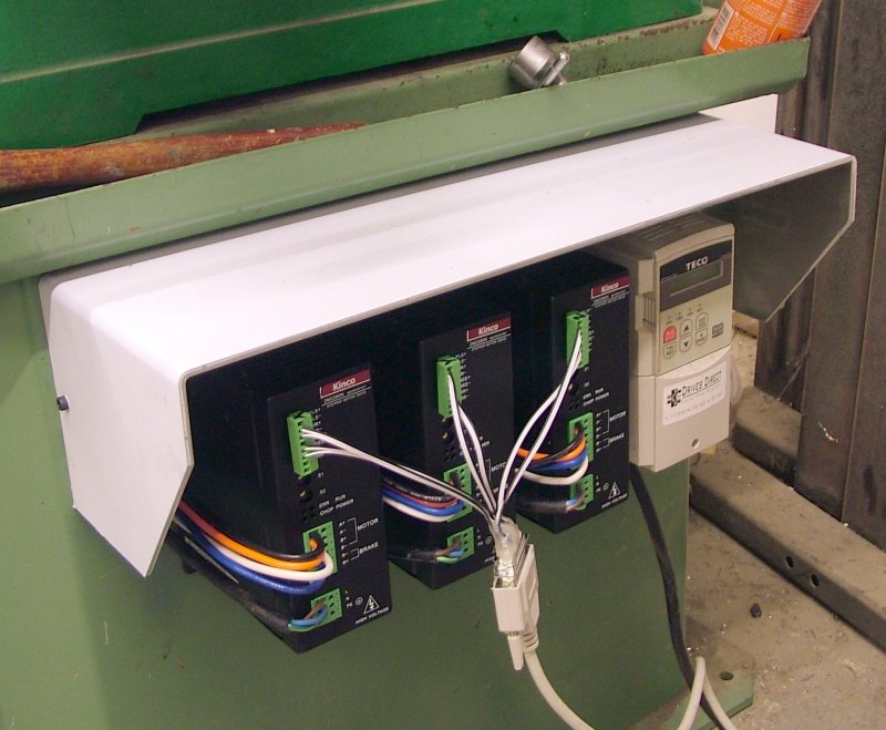

  9. #79
    Added a set of Gary's 240 VAC driven stepper drivers and a splash guard.
    Don't know how fast they go yet because my computer can't crank them up past top whack and refresh the screen at the same time.
    I suddenly feel a need for belt guards on the steppers.
    [ame="http://www.youtube.com/watch?v=bAoUW5bszRA&layer_token=c1adb91cff5d14e3"]YouTube- Noise[/ame]
    Would you describe this as "quiet"? :heehee:
