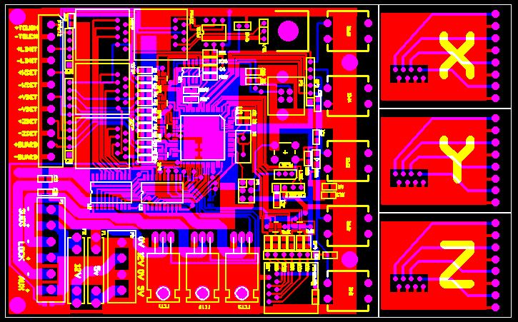

    I do like making things difficult for myself, but when it comes to the firmware I become a control freak. If it doesn't do what I want it to do then I want to reprogram it down the USB rather than fudge it. Nothing quite so reassuring as having all the source code :whistling:
    Stepper drivers, phase controller and pendant connect with RJ45 patch cords to keep everything neat and tidy, lots of buttons and well buffered I/O for everything I could think of.
    The limit switch and tool touch inputs are designed so I can short them to ground via an LED and get a visual check at the far end of the wire. Three FET's to drive the suds pump, quill lock and something I haven't thought of yet. A socket for one of Gary's jog encoder do-berries, a main motor kill switch to keep me safe while setting up, fuses on board and an input to tell me if 12V goes away. If the 5 volt fuse goes then it's goodnight Vienna so no way to monitor that.

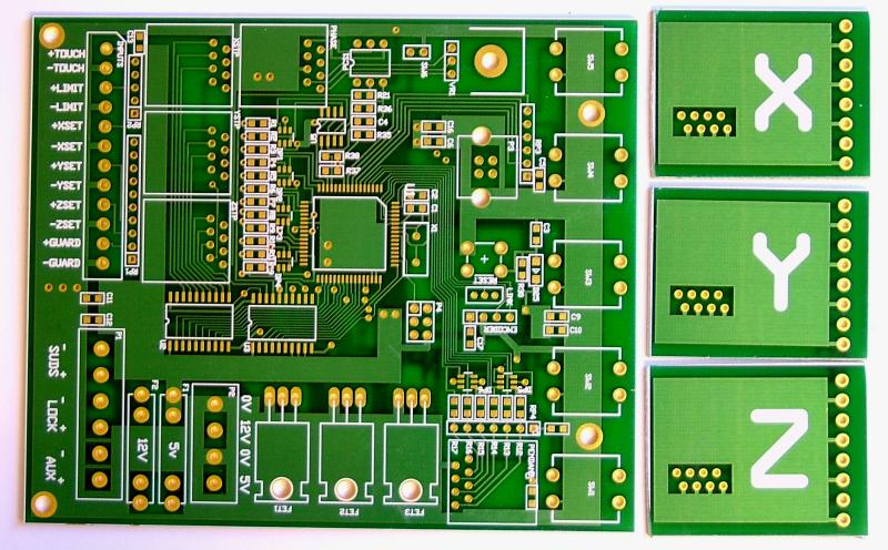

    There's my Christmas entertainment arrived in the nick of time, not bad for 35 Euro's
    I've only found one blooper so far, a 6 pin opto isolator with the wrong pinout. Luckily RS had a 4 pin part that fixed it
    Think I'll put everything down before I mount the processor, that way I can check it's connections, make sure I'm not overloading it anywhere.
    The three little boards on the right convert Kinco stepper drivers to RJ45 with all the wiring neatly out of sight, should look great if I got the measurements right :whistling:

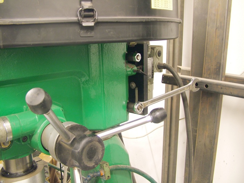

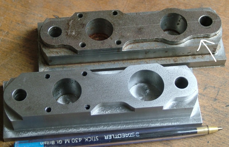

    I cut some metal and it came out a bit naff, see before and after pic, arrow points to the problem bit.
    Two changes, I wrote my own dxf to G-code software taking control of the tool path. Bubba, over on CNC zone, told me the Warco column pinch bolts were naff.
    I've been measuring the new part and dimensionally it is slightly undersize, somewhere between -0.00 and -0.05mm
    Theoretically with a bit of compensation I could get the tolerance down to .025 mm if I always used this tool and this collet :dance:
    Bubba suggested I changed the bolts. I looked at them and found they had worn badly. When I thought I was doing them up tight I was actually trying to swage a new thread. I fitted overlength M16's with spacers and anti-seize compound. I can now use a ring spanner rather than the awkward Warco offering and it seems to like it.
