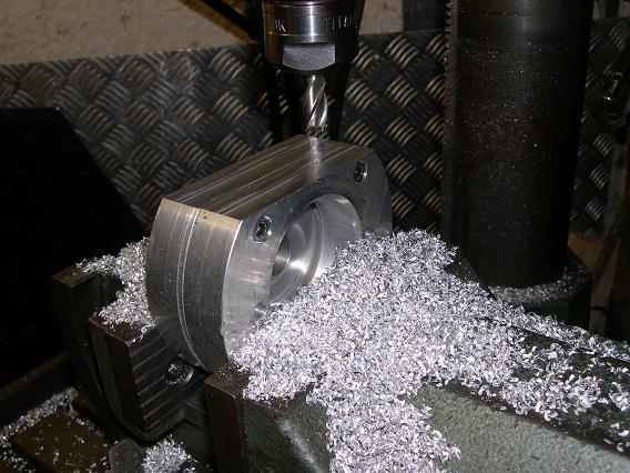

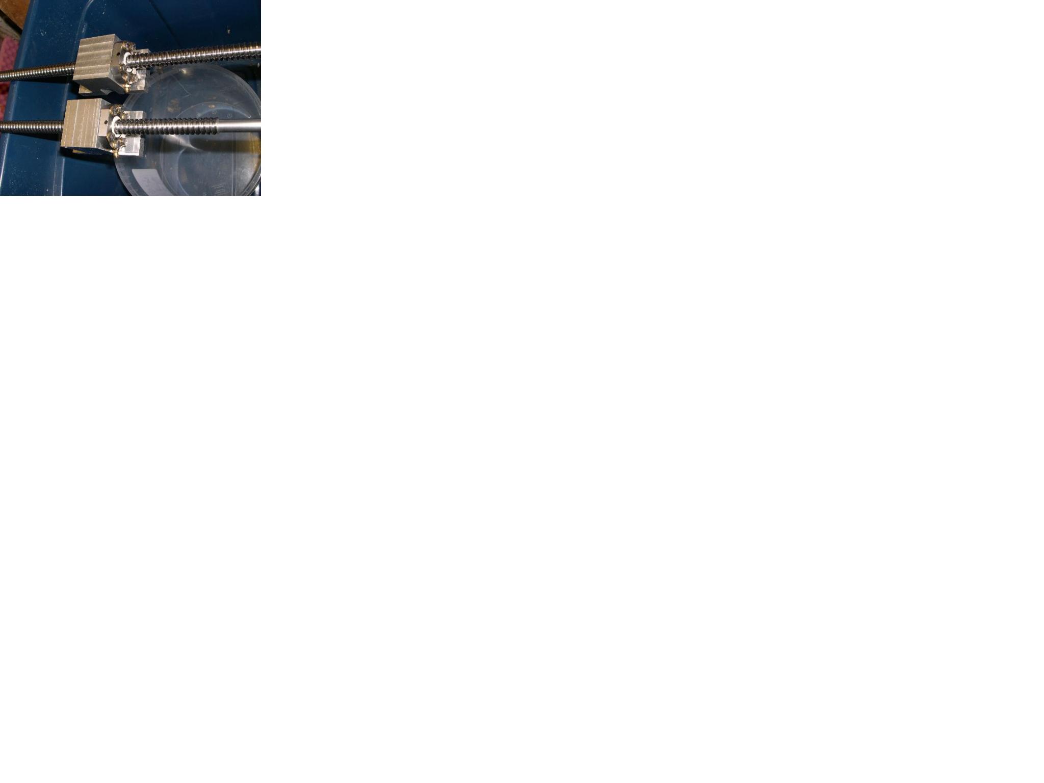

    Made blocks for the nuts, used the original bearing blocks and used a pair of angular contact bearings on each ballscrew, with the opposite end floating.

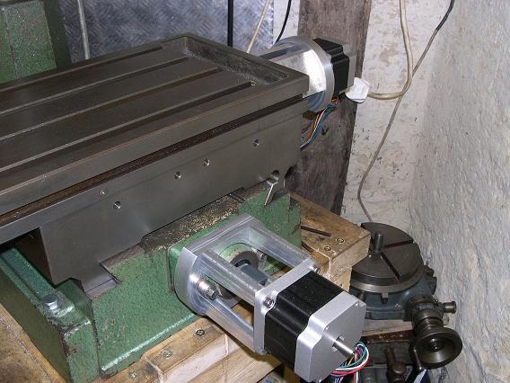

    The motor mounts
Name:	Motor mount2 sm.JPG
ID:	1725 Click image for larger version.
Name:	Motor mount3 sm.JPG
    Motors on
Name:	Motors on sm.JPG

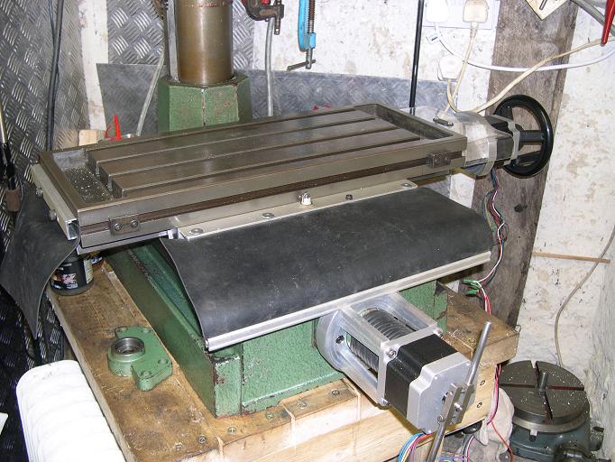

    Made sone covers for the ways, and fitted X & Y limit switches (one each).

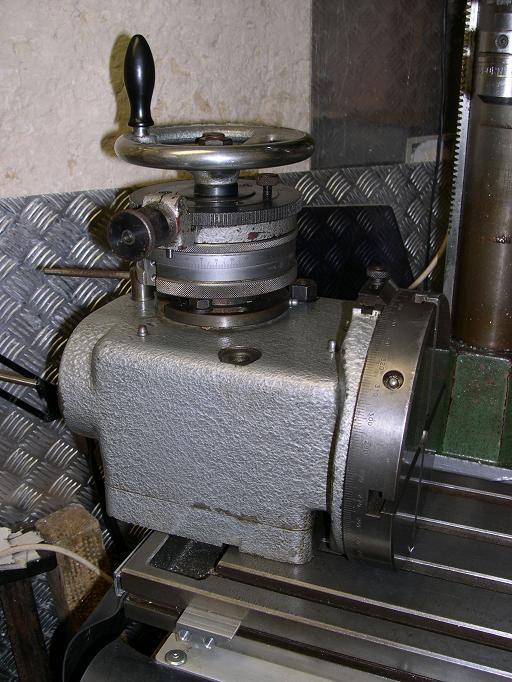

    Found another bargain on Ebay, my fourth axis, apparently from a Swiss gear cutting machine.
Name:	4th axis sm.JPG
    Boy is it heavy, must weigh 40-50 kilos!, bit worried about the balance of the table, but with the trunniun table and end support it should be OK, I hope!?

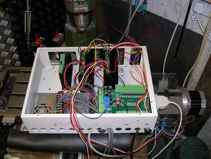

    Here is my box for the electonics (ex alarm box from a skip). It is not tidy yet because I am still sorting it out.

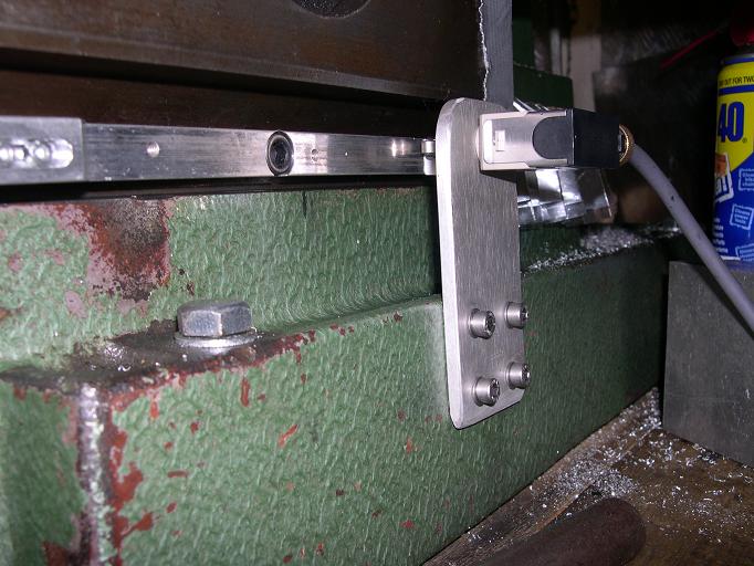

    and here is the Y axis limit switch.
Name:	Y axis limit sm.JPG

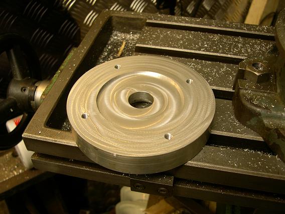

    Z is next, have a smaller honking plate than yours, only 25mm thick. It is a disk 150mm dia., with the quill bore offset.
    I have seen thinner ones, but when I saw your plate, I suddenly felt inadequate!. Do you think 25mm will flex?
