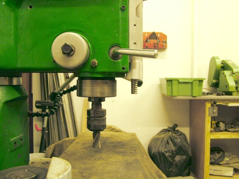

  6. #26
    Pic 1: Cheeks put in with a couple of bolts. Needed a bit of extra removing from the left cheek because the casting was far from straight. Heavy application of the angle grinder at the bottom before the ball screw bearing plate would slide home, had to cut out an extra 7.5mm
    Pic 2: Ball screw fitted, view from the side. This is as close as you can get the ballscrew to the quill. Hence requirement for honking plate.
    Pic 3: Pile of bits removed, Irvings' if he wants 'em
    Should have taken a front view with the ballscrew installed. Maybe next time.
    Next I have to relieve the cheeks a tadge so I can fit the motor plate, bit of a poor measurement there.
    Then make a false honking plate, cut the pulleys and wire it up so so I can make a real honking plate
    Robin

    I did cut the extra relief in the cheeks so the motor plate can slide home then bored and faced a 40t XL pulley to fit the ball screw shaft.
    Took the camera but forgot to put the memory card in it so no pic.
    Robin
