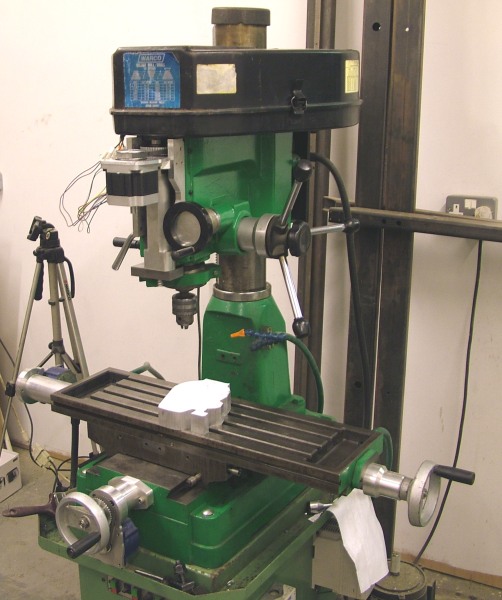

    My thought on the swivelly bit at the bottom..if it twists it shortens the effective length of the ballscrew=bad?
    I don't think it can twist without bending the screw, I didn't stint on the metal :nope:
    I now have the 40t pulley and belt in place with a faux honking plate fudged out of a bit of 2" x 3/4" iron.
    It feels good, any shift on the motor moves the handle, moving the handle spins the motor. I would have wired it up but when I looked for a bit of chocolate block connector all I could find was 80A
    Time for some G-code to make the real honking plate

    Is 'honking plate' a real term or one you made up to describe a 'big lump o' metal'?
    I am looking at the pics but still not seeing quite how the quill gets moved... and still moves the motor when you turn the quill handle...
    It's actually British Standard Honking Plate.
    John S -
    The frictional losses on a ball screw are low. The screw can turn the nut if you have the means to push hard enough.
    Spin the motor by pulling on the handle and you can feel if something is binding. Should be smooth
  5. Quote Originally Posted by Robin Hewitt View Post
    Ah, what is the lead on the screw... I hadn't realised it was that big a lead. But what stops the quill dropping under its own weight then when the motor is powered off? Or is there sufficient stickiness in the cogging to stop that?
    It's 5mm lead, the 32:40 pulley reduction gives 4mm/motor rev
    The quill return spring is there but it wouldn't drop under it's own weight anyway. You gottta pull to spin it.
    Tentatively wired the hybrid Z axis motor up today, a bit of light relief after doing the VAT return.
    Only had 2 Amps spare for it to play with but it doesn't seem to mind one jot, even though it is moving the quill at twice my normal speed
    Also rough cut the honking plate on a bandsaw, see pic, don't know if I'll get anything done tomorrow.
    Robin
