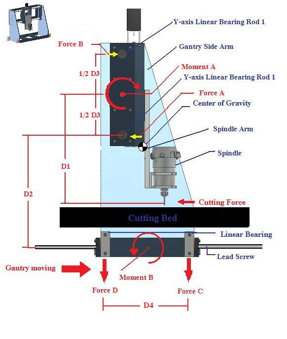

    reading this will answer your questions about the forces in play. what you suggest will not work , as you have to decrease moment B and the best way to do it is to increase distance D4.

    Hi
    Wont be a problem as it will have equaL up forces from the guide underneath
    in that drawing, my x would be were moment A is, and were the two yellow arrows are ( d3 ) would be the top and bottom connection to the X Rails.
    The Y gantry, will be between the 2 x rails ( above and below ) , putting its COG were moment/force A is. I think i will only need the tool going below the gantry, not the spindle, the aim was always to get the bottom point of the spindle finnishing at the y gantry and bringing any material up to it
  6. #25
    At the bottom of that drawing is Force D and Force C, these are are right angles to the rails.
    With your proposal these forces would be along the rails, parallel to them and pointing in opposite directions

  8. #26
    Eddy - yes exactly, and if i increase the distance of the gap on the bottom rail bearings, that should change the force angle a bit. ( cutting force ).
    Also, the rails can run on the top of x, and the side of x, if its to hard to get the bottom level to the top. The intention being, the second rail would absorb some of the stress, and the ammount of extra stress relief should be proportional to the allowable gantry weight reduction.
    If it will work this way, i can loose loads of weight from the gantry but maintain its rigidity. I still think there must be something am not seeing,

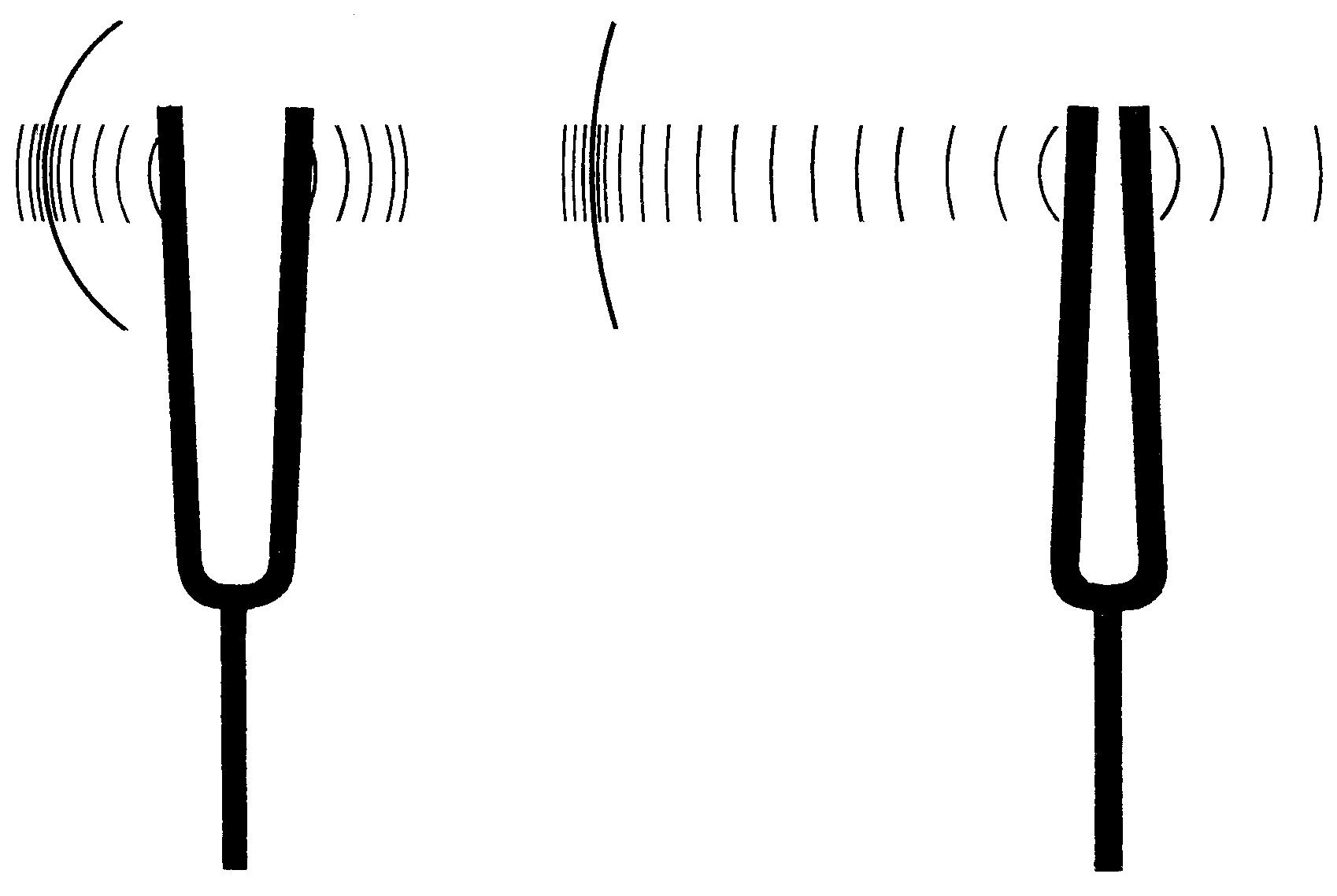

    Yes, yes, they will change direction/the forces. But... on a typical router the bearings that move the gantry are spaced 260-300mm/including, if rectangular supported/. On a heavy duty, like my current build for example, they will be spaced 400mm and above. So you have to space them obviously. What you are not taking into account is the overall height of that and the gantry and what i am speaking of is RESONANCE. It will resonate like crazy cause the forces of the tool and the assembly will be in paralel lines. Something like this resonator , where one fork will be the tool and its plate and the other the gantry assembly

    there are some other forces which you don't take into effect- inertia and gravitation. Which are not problem in normal L shape gantry.
    Just imagine a tank speeding on its noze vertically, when it has to stop. Tanks are low and long. Thats what best sturdy gantry design is.
    While gravity and long L take care of the balance spreading it over the bearing blocks, the non achievable balance will f^^^ck what you propose. Vertical tank on its nose, it doesn't matter that it will be supported in the middle. if not that, then the resonance.
    I am music instrument maker and here what will tell you. to lower resonance, you divide a long force arm into short ones and put each of them in different plane, so they will not help each other
