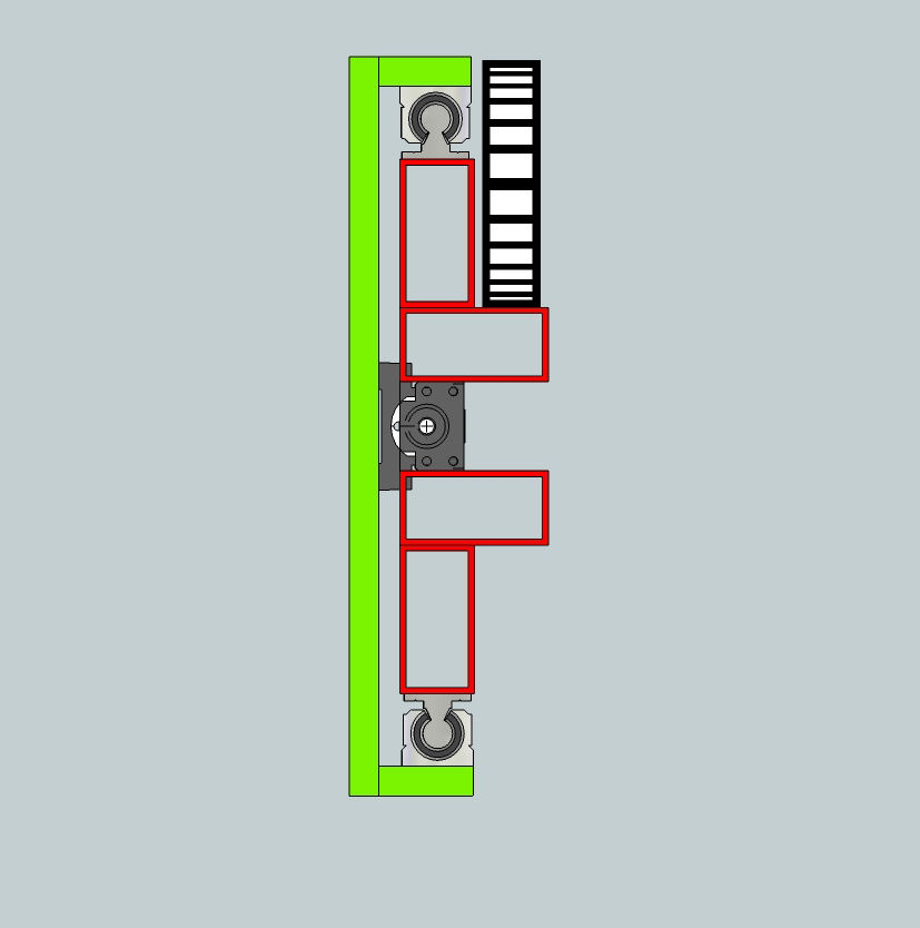

    This is not a build log, I'm just wanting to know if this design is any good. I've read that the L shaped gantry is good but it tends to put the ballscrew too far back so this is a double L shape made from aluminium box section with the ballscrew mounted centrally. The black & white object is the energy chain, sizes of the box sections are probably not correct yet.

    I no expert but all the strength seems to be in the centre of the gantry, yet your rails are top and bottom the weakest points.
    I may be wrong though.
    Jim
    Yes I see what you mean, there will be end plates so I'm expecting these to resist any twisting, there will also be blocks mounted on the end plates behind the ballscrew to support the horizontal box sections.
    Don't let the ball-screw being slightly further back put you off the L design.!!. . . In reality it makes very little difference it works fine and makes for a very good stiff gantry. It also very neat and keeps screw out of arms way and makes cable management easy.
    Your design would be too tall making for a weaker design.

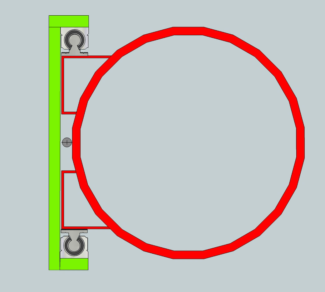

    So before I set off down the L design how about this one ? pipe + 2 bits of channel
    I'm also thinking that any hollow material could be filled with builders expanding foam to act as damping as it's very lightweight.

    Your tube design would be hard to fabricate, particularly when it comes to getting the rail mounting surfaces parallel. However it would be exceptionally strong as a tube is the strongest shape in torsion.
    To make it easier to make you could put the rails on the front flat surfaces, as they could be machined or leveled with epoxy. If you did this you'd want to use profile rails to reduce the overhang.

    Looked @ it earlier and liked it but as jonathan says its the manufacturing that's going to be a bit tricky, are you near any Engineering shops with a long bed surface grinder ?

    OK how about this, if you have a lathe that will swing a couple of inches greater than the pipe you intend to use you could manufacture a faceplate mounted fixture that will hold suitable size blocks of steel, preferably machined square on all faces, set up in the fixture and produce the radius to conform to your pipe OD.
    Then you want substantial section gauge plate to use as the mounting surface for your profile rails, drill&tap the support blocks rail ect attach the two end blocks to both rail supports & align them on pipe, tack them up and add the remainder of the blocks & tack also,REMOVE mounting rails to prevent twisting ect, finish weld the blocks to pipe, using your support rails and blue marker, file & scrape the blocks so you have a flat datum,fix one rail, measuring from that set to on the opposite side and finish the faces on the other blocks to bring them parallel, rail support beams can now be fine tuned with brass shim.
    Does that make any sense ?

    mekanik, it makes sense but I think I am over exaggerating the pipe diameter, perhaps Jonathan could advise on what would be required for a gantry say 1m wide ( I am only intending to go 600m cutting width.)
    Maybe this, I'm thinking the brackets would need to be welded onto the pipe to prevent crushing and slipping.
