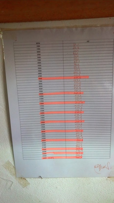

    A bit more heads up:
    The Speed and corresponding frequencies in HZ, measured carefully with a device, you r can be slightly different but not so much. Open it in new window to see it better and enlarge it with "control" + "+" , or PM if you can not read it:
Name:	VDF speeds.jpg

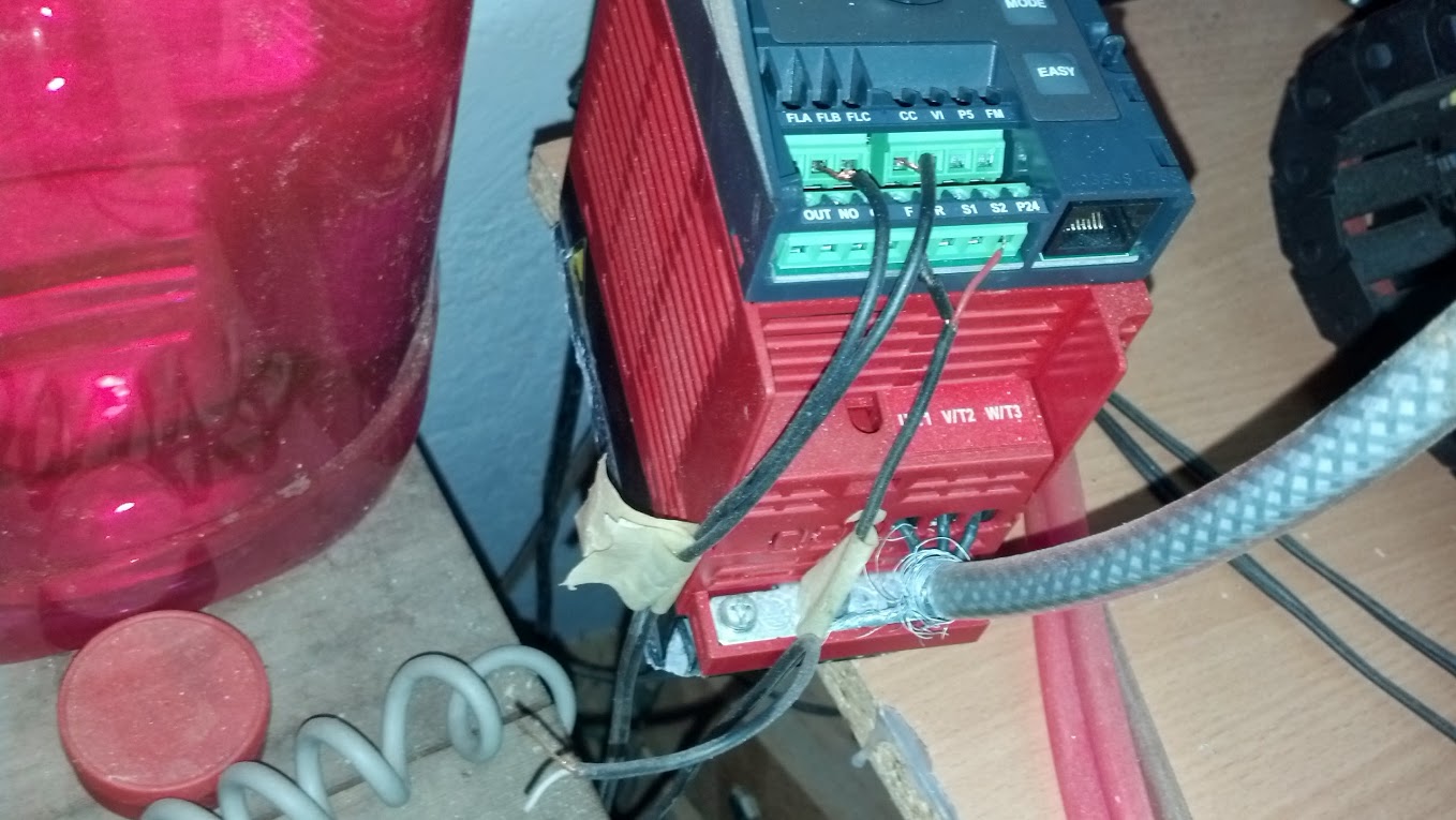

    The typical connection / check well the manual/
    cables from left to right
    - trip ,
    - PWM control,
    - ??? i forgot , not so sure, but it was enable to the BOB, in case of power loss it stops everything/
