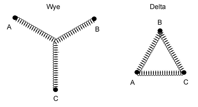

    Also, back to the spindle internals....does anyone have a link to a diagram of the typical coil arrangement inside?
    I'm 80% certain it's the spindle...begs the question has anyone upgraded & got an 800W water cooled spindle lying around they wanna sell?!

    Didn't spot this bit...
    Quote Originally Posted by HankMcSpank View Post
    It'll be one of these:
    Just to be clear, you did check that the 3 resistances are the same? If off by more than about 10% (complete guess) then you've got a problem.
