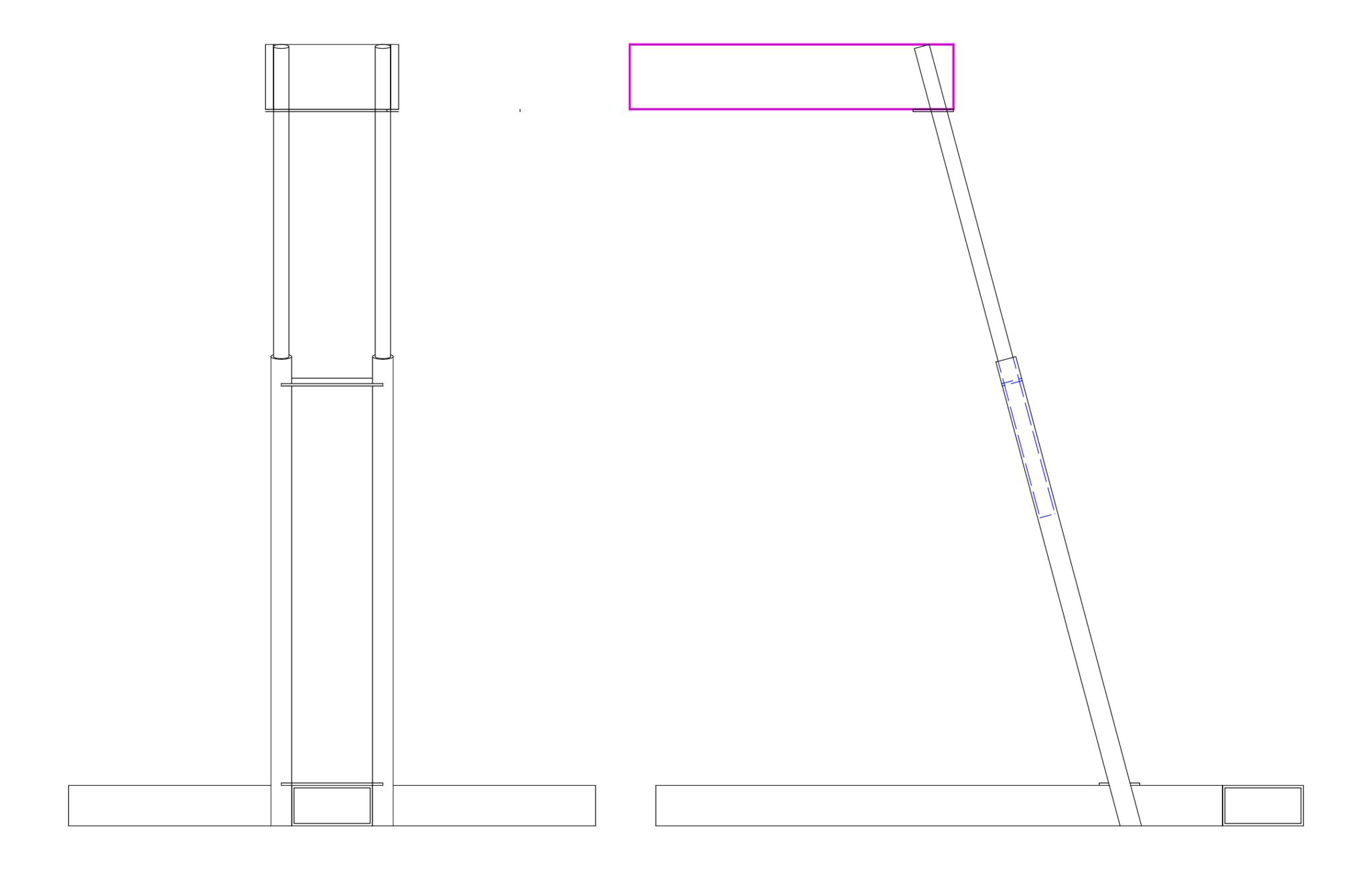

    In the meantime, using Phill's suggestion of 25.5mm steel tubing/19mm rod I have come up with this:
    Uses two tubes with cross plates welded just below top (leaving room for locking collars, not shown) and at bottom. The T-shaped foot is made of 2 bits of 3mm wall 100 x 50 bolted together with 3mm angle and flat plate joining pieces (not shown) and the tubes are bolted into the foot from the side (2 x M8 bolts each side, not shown) and the bottom cross plate bolted into the top of the foot (4 x M8 bolts, not shown).
    At the top, 2 x 19mm rods are welded to a cross plate which bolts into the underside of the upper units 10mm walls using 4 x M5 bolts and also sideways through the rods into the walls of the unit using M8 bolts.
    Maybe able to shorten foot once I've checked C of G of whole assembly...

  10. @FF: Yes, I'd already looked at AW but as you say, long lengths :( I only need 600mm or so of each size. Been looking in eBay for offcuts but nothing suitable seen so far. Also there's no info on size tolerance so hard to tell if one fits inside the other or how well. Yes it would be possible to skim the outside of the inner tube, tho not many have a lathe that can do 600mm between centres on a 50mm tube. Not sure how you'd skim the inside on that length as you implied.
    The steel tube/rod approach as drawn has the advantage of a simple welded/bolted construction. Large dia aluminum tube will need a 'plug' of some sort thus adding to the cost. Also there are plenty of examples of 20mm steel rod and 25mm x 2.5mm steel tube on eBay.
    Now I've done the c of g calcs the foot can be reduced to 500mm long and 500mm wide (from 700 x 650 as drawn).
