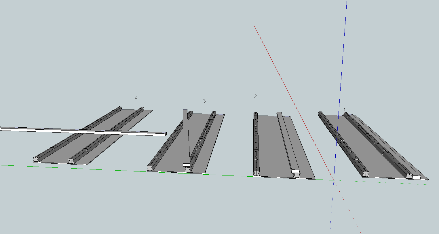

    You almost got me there :-) . But isn't it that a square straight edge has 4 edges that could be used for that against the ones that have only 1 sharp edge?
    I believe their purpose is a bit different and definitely i believe i need the square- to compare between rails in all directions / the twist i mean/ .

    maybe you misunderstood me because of my English. I meant there are 2 types, beveled/like a knife/ and ones that look like bar. So as far i understood, you said that the beveled is better, cause you can see easier the light, when touching some surface to be measured.
    So what i believe, the square could be more useful for me, constructing a cnc, because it has 4 edges versus one of the beveled.
    First it can serve as a master guide to straighten the first square shaft supported rail when mounting on the red axis, fig 1 , so its true straight
    Then check the straightness on blue axis, fig2 /hence proper tightening on hopefully straight surface or if not-if properly shimmed.
    Then check twist/ green axis/ fig 3 and 4.
    With a beveled edge i don't see how you can perform and alight twist, as many of the beveled edges i saw are straight only at the knife beveled blade. fig 2 is where the beveled edge shines, but if i simply flip and use one corner, its the same.

    I've got both and the bevelled edge is far more versatile and the one used most.
    You cannot angle the straight edge like you show because your straight reference edge is lost because it's bending and will just follow the curvature of the surface. The reference edge is only meant to be used in one direction and must be 90deg to surface your checking any tilt/bend and error is introduced.

    Thanks, i get it now. Ok, i will look for a beveled one.

    This is only my opinion and i am sure others may disagree but i would forget about the Maun straight edge, i couldn't see any thickness quoted so it's more than likely a bendy one,the other bevel edge rule is quoted as steel and galvanised and i didn't see any tolerance/flatness quoted, i would stick with the magic numbers DIN 874/2 a parallel straight edge of reasonable thickness should be fine you can see the smallest of gap by placing a light behind the straight edge.
    Take no notice of e-bay sellers the DIN 874/2 rules will be checked under controlled temperature conditions in a tool room using some rather expensive gear. a box for your precision straight edge is a must buy.
