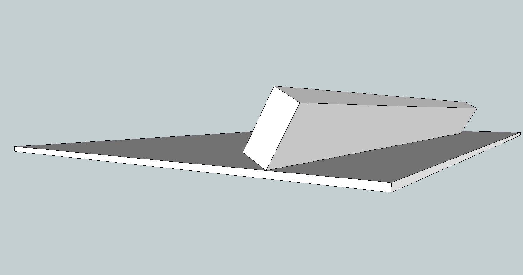

    You almost got me there :-) . But isn't it that a square straight edge has 4 edges that could be used for that against the ones that have only 1 sharp edge?
    I believe their purpose is a bit different and definitely i believe i need the square- to compare between rails in all directions / the twist i mean/ .
    If I'm reading you correctly you mean this;

    But if you angle the straight edge on the left it will bend and not be straight any more.

    maybe you misunderstood me because of my English. I meant there are 2 types, beveled/like a knife/ and ones that look like bar. So as far i understood, you said that the beveled is better, cause you can see easier the light, when touching some surface to be measured.
    So what i believe, the square could be more useful for me, constructing a cnc, because it has 4 edges versus one of the beveled.
    First it can serve as a master guide to straighten the first square shaft supported rail when mounting on the red axis, fig 1 , so its true straight
    Then check the straightness on blue axis, fig2 /hence proper tightening on hopefully straight surface or if not-if properly shimmed.
    Then check twist/ green axis/ fig 3 and 4.
    With a beveled edge i don't see how you can perform and alight twist, as many of the beveled edges i saw are straight only at the knife beveled blade. fig 2 is where the beveled edge shines, but if i simply flip and use one corner, its the same.

    I've got both and the bevelled edge is far more versatile and the one used most.
    You cannot angle the straight edge like you show because your straight reference edge is lost because it's bending and will just follow the curvature of the surface. The reference edge is only meant to be used in one direction and must be 90deg to surface your checking any tilt/bend and error is introduced.

    Thanks, i get it now. Ok, i will look for a beveled one.
