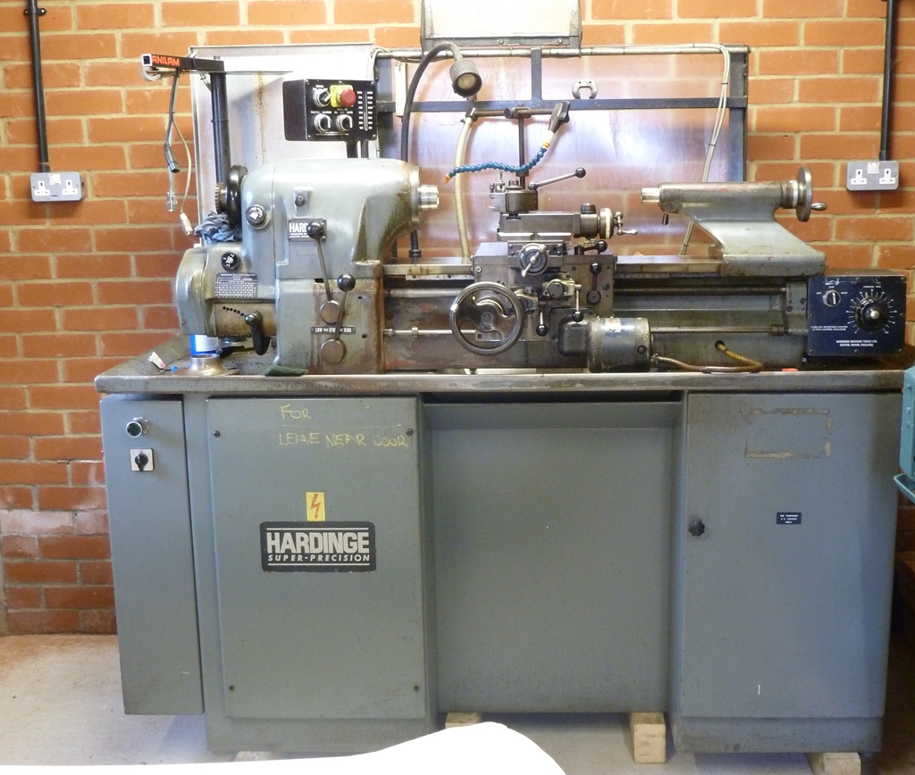

    I have fairly recently been lucky enough to get hold of a Hardinge KL-1 lathe, and though it would be good to share some of my experiences with it.
    I know the history of the machine for most of it's life as it came from the company at which I work, so most of what I plan to write about is, at least initially, about getting it to function.
    I hope this will also be a record for myself as well for what I did, so I apologise if some of the things I write about have already been covered!
    This is going in my garage, so no 3-phase there. It's the conversion to single phase - that's the first job.
    Here is the lathe:
    I'm not entirely sure of the manufacture date, as the serial number lists seem to be for US versions, not UK versions.
    Searching the various forums tells me:
    The main motor is a dual speed 0.5hp/1.5hp 415V_ac 3 phase motor.
    The speed change motor is a dual voltage (240V_ac/415V_ac) 1/20hp three phase motor.
    The coolant pump motor is also a dual voltage (240V_ac/415V_ac) three phase motor.
    The carriage feed motor is a 90V_dc motor.
    My initial aim is to power the dual speed main motor, really just to prove that the lathe is actually functioning, and there’s nothing seriously wrong with it.
    Paul.

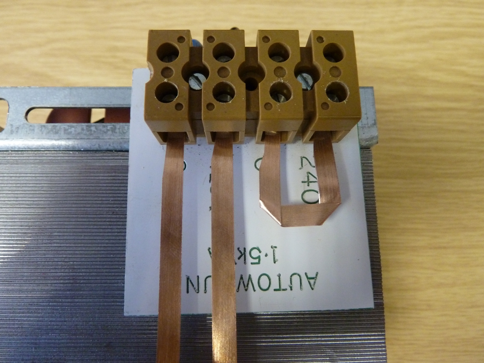

    The main motor is something that I definitely want to use due to it's quality, and I've read that I need a step up 240V_ac to 415V_ac transformer and a 3-phase input VFD to run it.
    I the months waiting for the lathe to arrive, I gave up waiting for a transformer to appear on ebay, so decided to get a transformer manufacture to make me one.

    Some calculations for the transformer :
    The motor is 1.5hp which is 1.1kW (1hp = 0.746kW)
    Assuming a 90% efficiency of the VFD then 1.1kW/0.9 = 1.22kW required.
    Approximately, Transformer kVA = 1.22kW/0.7 = 1.74kVA.
    However, this rating would be for heavy, continuous operation, which I'm just not going to do, so I have gone for a 1.5kVA Autowound Transformer. This will keep costs and physical size of the transformer down to an acceptable level.
    An isolation transformer will be bigger and more expensive, and I've been told it's just not necessary.
    This will step me up from 240V to 415V, then this will connect into two of the connections of a 3 phase input VFD.
    I'll common up two of the inputs to share the loading on one AC cycle a bit more across the VFD rectifier diodes.

    I've never heard of this done before. Devices inside the drive use a particular phase for synchronisation, that's why they specify which terminal to use if you are on single phase input, also a 3phase rectifier relies on phases being 'out of phase' for the return current but 2 of yours would be 'in phase'.
