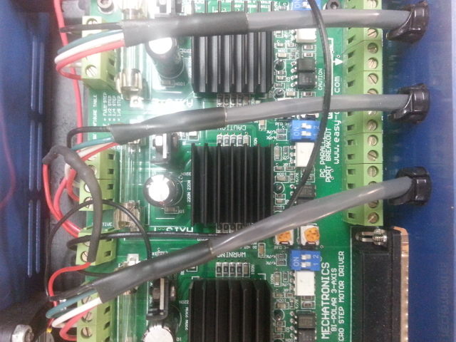

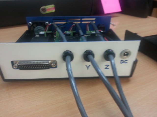

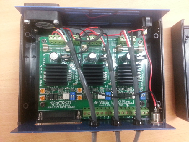

    Hi JazzCNC,
    Thank you very much for your reply.
    I know that we managed to use the software and make the machine move but it wasn't following our instructions properly. And recently it's not moving at all.
    We used Mach3 as you already guessed but we had problems with it. Maybe you could advise us on where to find it? Maybe more recent version of it?
    I will attach the pictures of the control box. If they are not enough I can send more.
    Thank you for your help,
    Valeria

    I'm quite familiar with that particular mechatronics board (it was my main board until recently)
    A couple of obvious questions....
    1. The DC plug needs 24V ....you do have a 24V PSU don't you?
    2. Also, do you have a 25 way ribbon cable & a PC with a parallel port to connect it to?
    If so, then this will be surely mach3 config that's the problem.

    Valeria,
    First you need to confirm the board is alive so plug it in and see what happens.? Watch for lights and listen carefully if motors make any noises or if they go stiff or twitch.
    I don't see any other wires or sockets for external connections going to the Boards inputs so thinking there must not be any E-stop buttons or Limit switches etc on the machine.
    This could actually be the cause because if the Control Software(Mach3) is set to watch a certain pin on the board then it won't allow Mach to restart.
    So provided the board is still alive, which would imagine it will have some Led or light to show(Hank should know where to look) So Does Mach3 Restart.?
    If yes to Board working and Mach3 restarting then like Hank says chances are it's a Setup problem if no movement.
    So if you have no idea how to set Mach3 Motor inputs etc then best option would be for you to post Mach 3 file you use and we can check it out for you.
    To find this file go to the Mach3 folder and look for file ending XML and with the Same name has the Profile you click on when starting Mach3 IE Mach3Mill.XML
    Then you may need to ZIP it up to post. With this we can see how it's set and make any changes and post back for you.
    Provided the boards not fried then we should have you moving easy enough.

    Lol, well during the time I owned it..I never has all three ICs blow at once (they blew in staggered formation - to cause the most inconvenience!). To be fair 50% of the IC blow outs were my fault (ignorance/sloppiness) ....but that particular board is not a great design because the IC holder contacts get dirty over time, leading to poor pin contact (result = no workeee as you'd want)
    That said one of the beauty's of this board is the important bits that blow are easy replaced.
    which is a blessing but also a curse because like I say, I don't think the IC holders are up to it. So it's sort of circular problem ...i.e. the board doesn't work well because of the design, but you can change the ICs out easily because of the board design!
    I still think (assuming 24V is plugged in to the board & a 25w ribbon connecting the control box back to the PC is in place) that if *none* of the axises are working, then it's likely to be a Mach 3 config problem (cos from recollection it wasn't that simple to configure the mechatronics board as a n00b in MAch 3)
