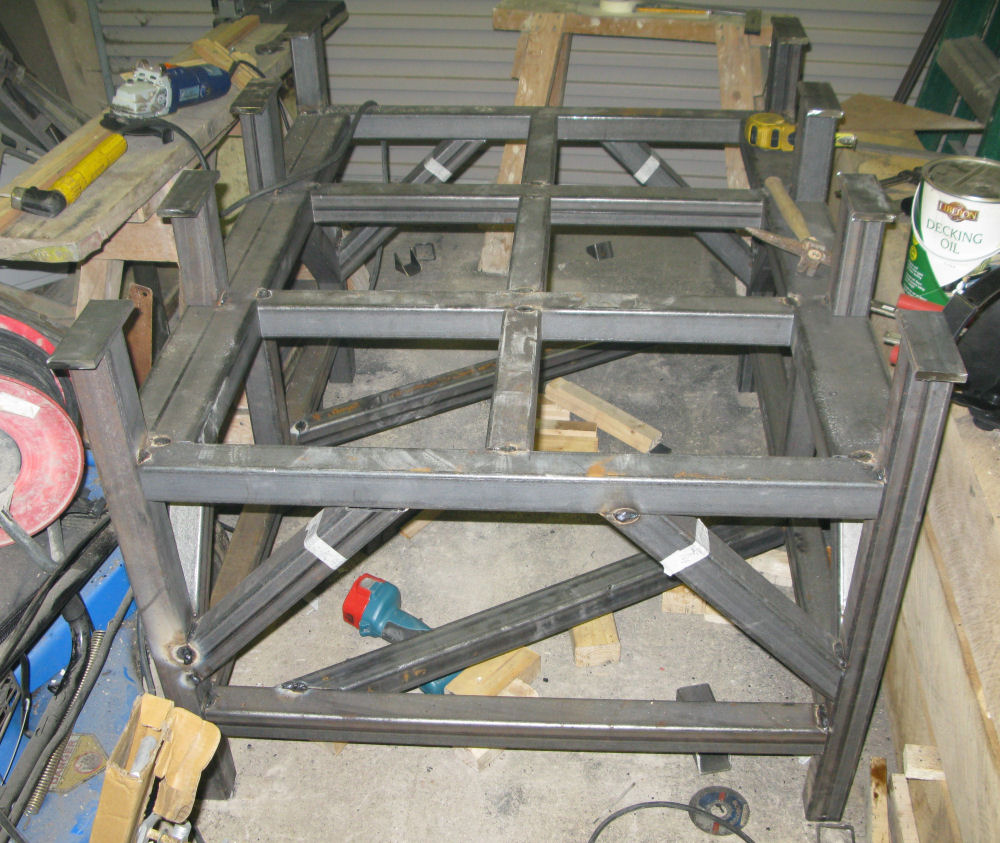

    Got most of the frame tacked up this week just using small stick welder ready for MIG welding ASAP.
    It's taken 18 metres of 50x50 box section and about 5m of 100x50 box, plus some 50x10 and 30x6 flat bar, the wife is going to struggle getting into the van.
    Pictures to follow shortly I hope.

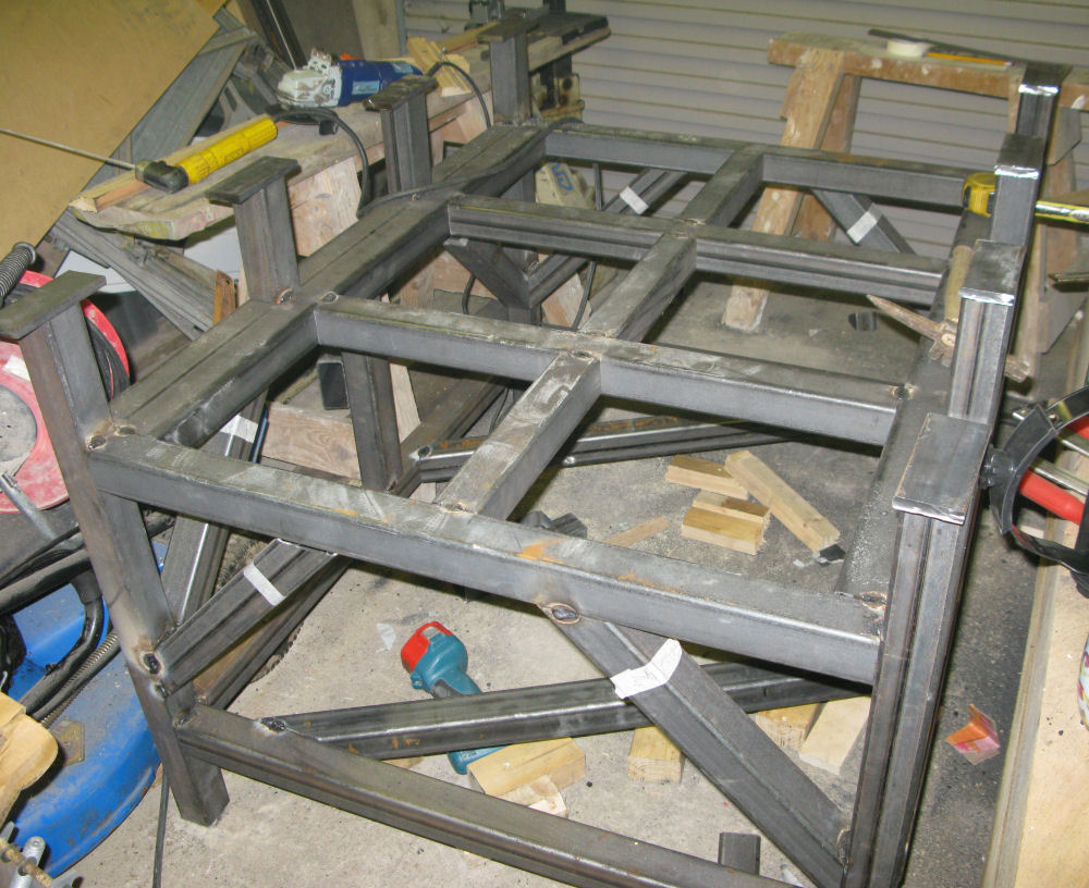

    The frame so far, don't be zooming in on the bird shite welds, it's holding together fine until I get it to the MIG welder.
    Only bits missing are the two top 100x50 box sections that will carry the rails, these bolt onto the 8 pieces of flat plate and hence adjustable.

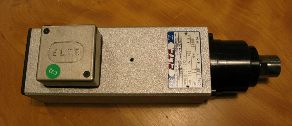

    You can see my vast work area, also pic of the spindle.

  5. #95
    That is looking like one very sturdy frame. Very nice

    You might have read in another thread that I'm having trouble getting my spindle running in Vector Speed mode, I've tried everything so have had to finally contact ABB.
    Also I got the frame moved out of garage to workshop and it reminds me of the time we bought a three seater reclining sofa, it looked just right in the showroom but when we got it home it was as big as a tank so back it went !. Anyway it means I need some structural alteration so I've got the lintels (it's a double skin block wall with cavity) and intend cutting a doorway from the workshop through into the adjoining wood store. This will be 're-purposed', as they say, into a 'consumables and wood' store which will allow a reshuffle of machinery and hence space for the cnc router. It all sounds very grand but the consumables and wood store will only be about 3m x 1.4m
