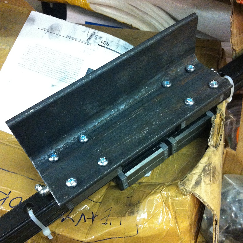

    It does say low viscosity, but as you say is it really worth it? Does look like it'll fit the bill mind! I'm just drawing fences on my frame to see what volume I'll need...I've emailed them to see if it's equivalent to the Wests System!

    Oh feck it....rush of blood to the head.....should have some winging it's way to me shortly. £33.36 inc P&P for 1.5kg of resin and 0.5kg of slow cure hardner. Will have a play and let you know how it pours. I reckon that I'll need 0.63 litres of mixed epoxy for 5mm depth so the standard pack should do nicely!

    Don't worry about it Eddy...I compared and they looked pretty identical...so in a rush of blood to the head bought some. You'll probably be using it before I do anyway as I've got 44 x M5 holes to drill and tap for the rails and before I can do that I've got to make a plate so I can get the linear carriages mounted to get the rails in the correct position on the box section. At the rate I'm going at the moment it will be summer by the time I've done that
