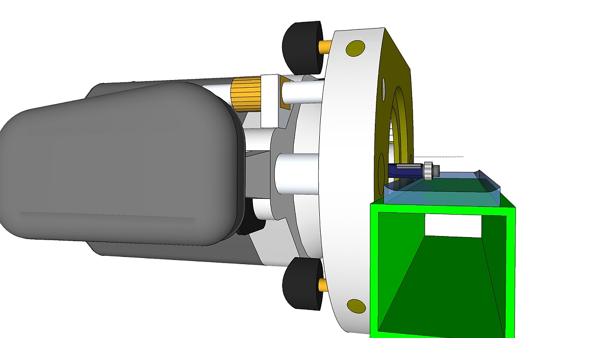

    I had those thoughts myself but decided to epoxy onto bare metal. I had put metal primer on the box section beam but before putting the moat on I sandpapered it off the top. My intention is to fit the linear rail and paint over everything up to that.
    I'll take the paint off where the epoxy will go with a flapper disc on the angle grinder so it's back to bare metal. I guess the epoxy would be OK when the paint was in the oven (180°C) but will get it painted before just in case.
    I know this is somewhat less than scientific but I just had a play with the sample epoxy pour I did 3 days ago, a scriber barely scratched the surface and a centre punch made no more of a mark in it than it did in the steel box section. Overall I'd say that stuff was rock hard.
    That's good to know that it sets rock hard. Will be interesting to hear how you get on with the filing the meniscus off, I can imagine it clogging the file. I might have a go at how Graham (Wobblycogs) suggested getting the meniscus off with a router. If you have a bit with a guide bearing and ran the bearing on the epoxy surface and the router plate on the side of the box section I can see it being quicker. Might have a play when I get there...
    A course bastard file works great, then finish off with fine sandpaper wrapped around a wooden block, making sure not to contact the middle area.
    You're on your own with that idea, keep some bandages handy

    I think a bearing guided bit would work but that wasn't quite what I had in mind. I'd try a chamfer bit with the depth set slightly less than the depth of the epoxy. Run the fence of the router along the edge of the steel. You'd probably need a couple of passes as the leading edge of the router would ride up a little but I'd guess it'd take longer to set up the router than it did to clean up the epoxy. I think this would probably work better with the more often used clamping-wood-to-the-steel method of keeping the epoxy in while it's poured as you wouldn't have to be quite so careful about correctly setting the depth of cut.

    This is what I was thinking of...
    That would work until you get to the end where the router body stop the cutter getting to the end. You could do this with a file in a few minutes
