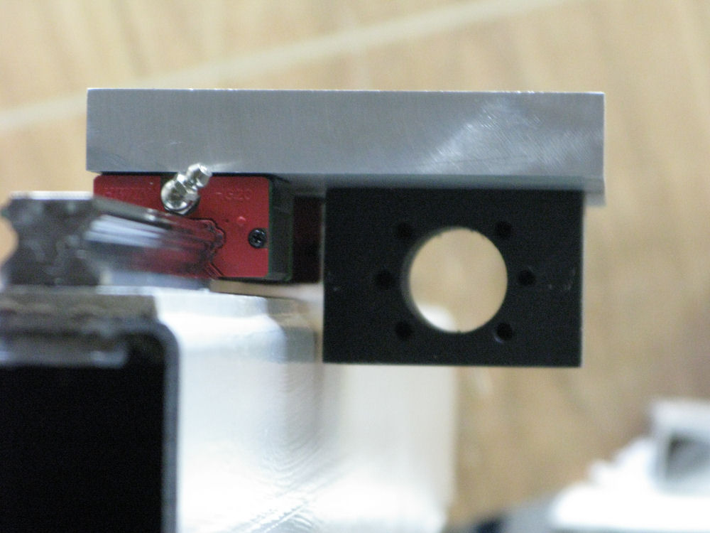

    It took only a few minutes to remove the meniscus using a course file, because there was 10mm each side of the rail it meant there was no need to get it perfectly flat across the whole width. I did run a bead of liquid nails down each side of the epoxy just to give a nice transition onto the metal.
    Got the rails on, one support beam painted, 20mm aluminium gantry support bracket fitted and ballnut bracket attached.
    Ball screw temporarily installed just to show actual position. Tried to keep rail and ballscrew in same horizontal plane as much as possible.

    Showing end of beam with rail, epoxy, 6mm internal flat bar to give extra thickness for rail mounting screws, glued it in with Gorilla Glue and worked great.

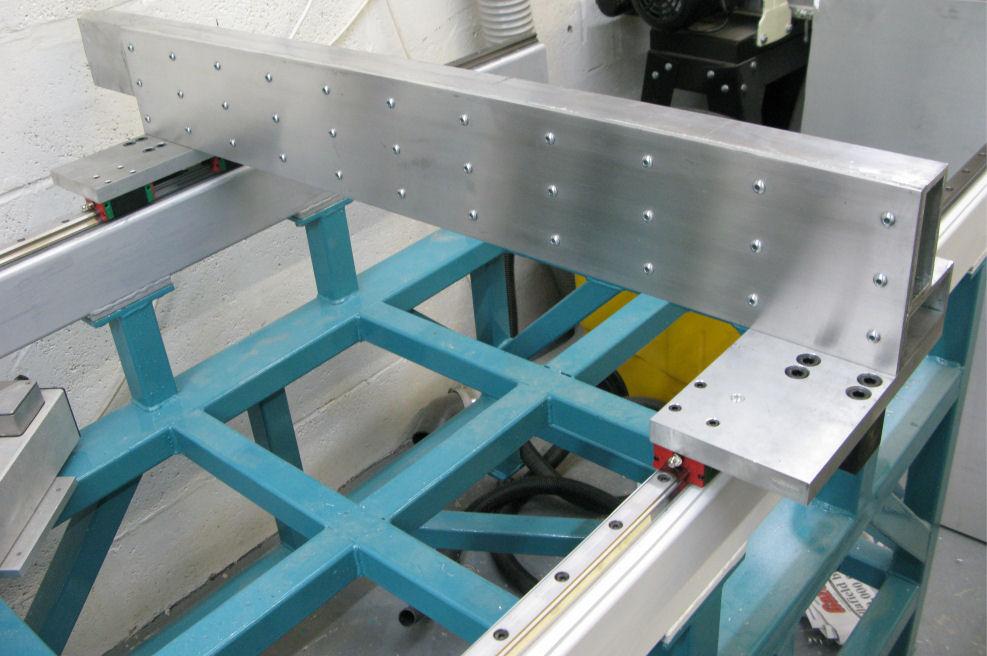

    There seems to be two main ideas, one is to bolt the beams like I did then level the top using shims between the bolted flanges. The other idea is to fully weld the frame then use epoxy to level the top.
    What I found was that after welding the flanges to the top beam it made it bend, this was expected. I bolted it to the frame and got it almost level but there was a downward dip at the overhanging end. I decided therefore to epoxy the top. Once the epoxy has set you do not want to be doing anything with the bolts holding the beam otherwise you could make it not level again.

    Aluminium, L shape using 100x50x6 aluminium box, faced with a 6mm x 150 aluminium plate. All glued with Gorilla Glue then bolted. (thanks to kingcreaky for ideas and info, http://www.mycncuk.com/forums/gantry...ine-month.html)
