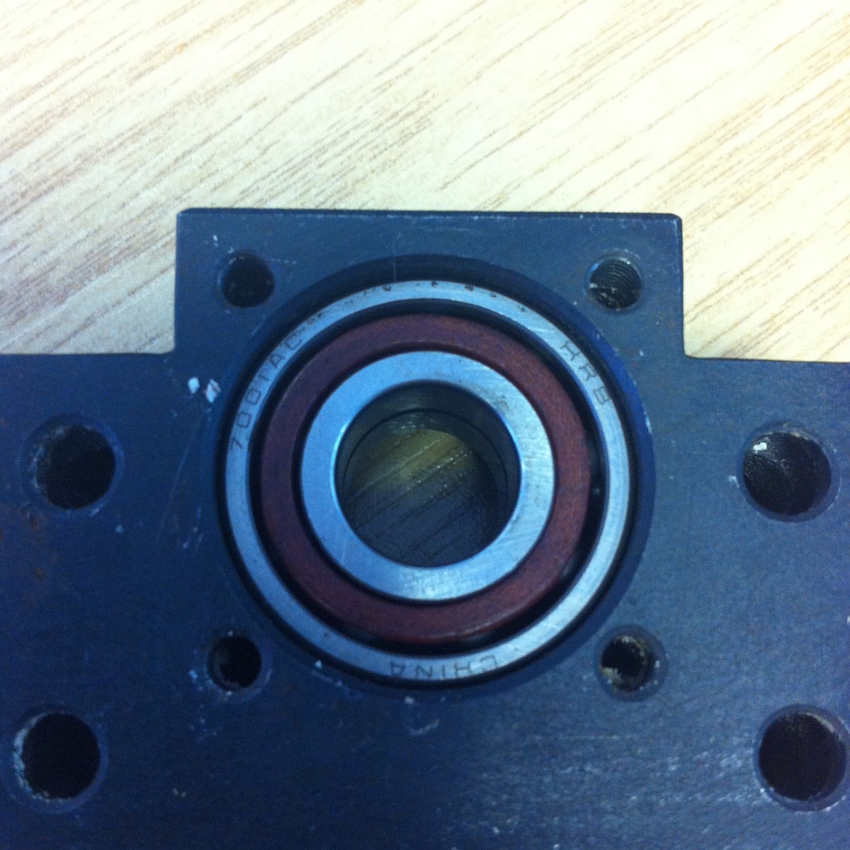

    I just stripped a couple out, one had Japan bearings the other China bearings, one had the bearings facing opposite directions, one had both bearings facing the same direction (keep in mind these are angular contact bearings), the China bearings had no grease whatsover in them.
    So it's a good job I stripped them down but now they have to be sorted out.

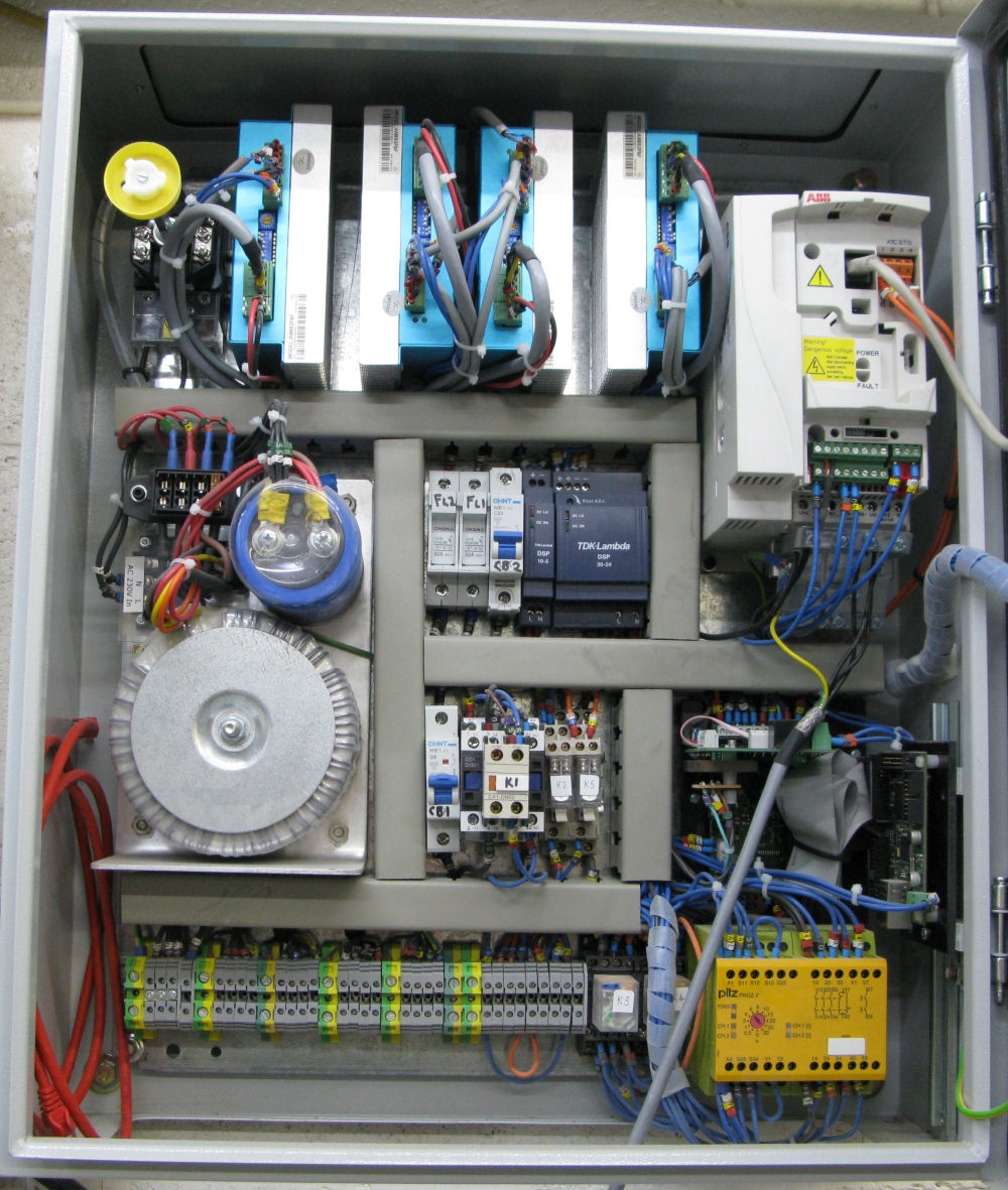

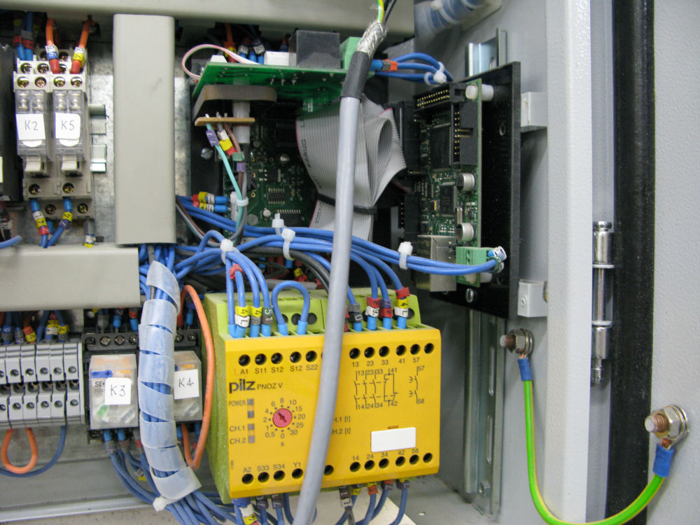

    As requested layout info for panel, please refer to schematics posted previously.
    Starting top left.
    Panel isolator, AM882's, ABB Inverter
    PSU for stepper drivers, FL2, FL1, CB2, 5V PSU, 24V PSU
    CB1, K1, K2, K5, Breakout Board with spindle board and K6, Smooth Stepper (mounted on panel side (aargh I hate that))
    Terminal rail, K3, K4, PILZ Safety Relay

    On the close up photo you can see 3 wires (77,75,24N) going to a piece of vero board located on a stand-up on the bob, that's K6 the transistor relay for flashing the lamp (see schematic)
    It got a bit crowded and I've not got the fans in yet ! the grey wire hanging down is just the spindle I have lashed in temporarily.

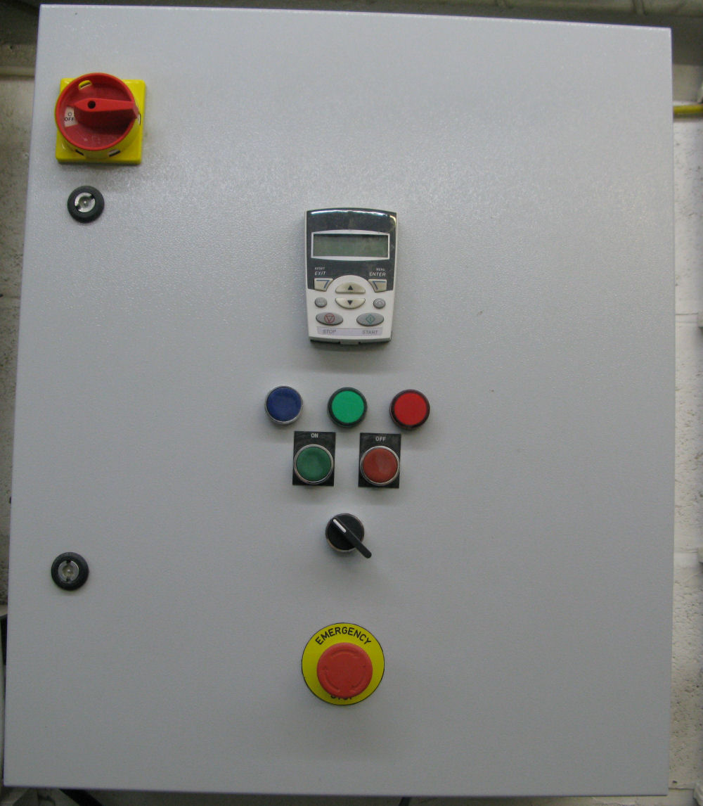

    Added a limit override switch (it's a spring return type so you can't accidentally leave it on), still need to label up everything on front.

    Clive, you're not talking crap but in this case the spacers are okay, it's the bearings themselves, the inner and outer races are dimensioned wrong so there is no gap for preload. I've been reading that the bearings should be obtained as a pair.

    Yep....chinese bearings (ungreased) and face to face so the inner races were not being tensioned...need a shim and some grease and see how they fare...
