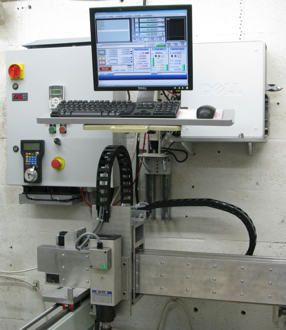

    All being well it should be ready to do a test cut tomorrow, the bed isn't fitted yet but that won't stop it having a go. Edit: just thought, I might not have suitable cutters for anything detailed.

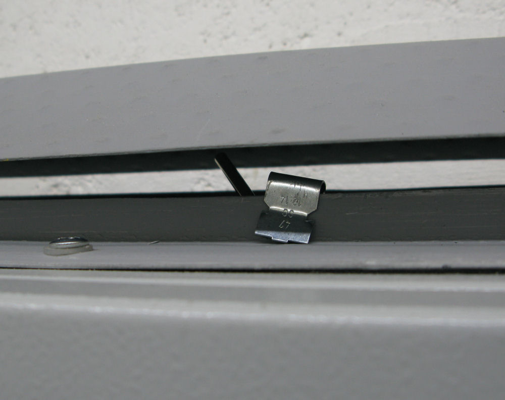

    Got the temperature controller fitted, ideal for under £9, it brings the fans on at 25 degC at the moment, it was 21deg ambient in the shed today (logs were good burners) so they were on and off quite regular.
    Second photo shows the remote sensor in the ventilation hood, it's held in place with a 'girder clip' for cables.
    Also I moved the monitor/keyboard arm further up the wall so that it clears the highest part of the machine when moving, it looks a bit mental but Aldi had a nice little 2 step set of caravan steps just the right height for comfortable access, plus it's a bit of physical exercise.

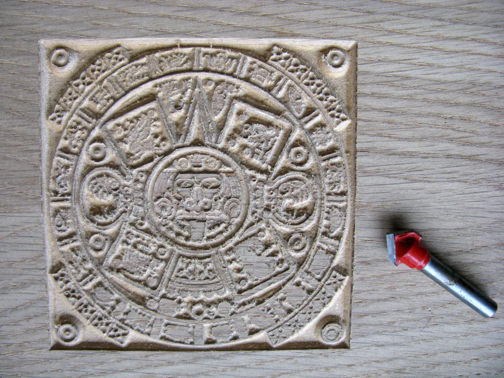

    I was forced to cut something today !
    Small Aztec Calendar, http://www.mycncuk.com/forums/worksh...html#post53632
    Using cutter shown which was best I currently had, machine bed consisting of one piece of 18mm plywood held with one clamp to frame, mdf workpiece held with double sided tape.
    So rather crappy but it works
    According to Mach3 it took 55.35 minutes to cut (if that's what you can call it)
