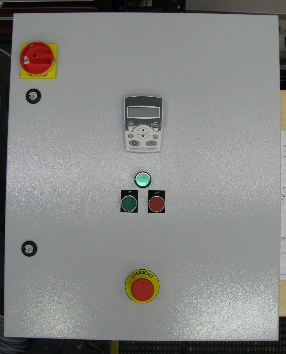

    How many people build the control panel first ? Just got it finished today, I decided I would wire the spindle cable directly to the Inverter later on without going through a set of terminals.
    The door interlocked isolator is in a position I would not normally use but layout and segregation of components dictated the design.
    I'll also install a cooling fan at the bottom blowing air into the enclosure via a replaceable filter and an outlet at the top. It's better to blow air in, than suck it out, this maintains a positive pressure inside the enclosure keeping crap out, the only access point being through the filter.
    Wow eddy, that's a great looking control panel! I am especially interested as I am in the process of boxing up all of my hardware (currently all screwed to a bit of old mdf that has seen better days!).
    I would love to know a bit more:-

    • I see you have an EStop on the front but do you have any other provision for machine mounted estops/limit switches/home switches?

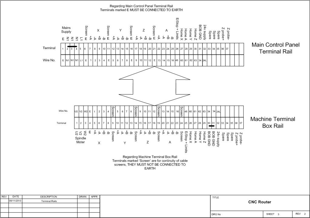

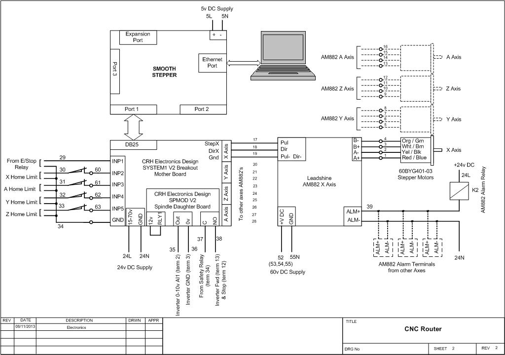

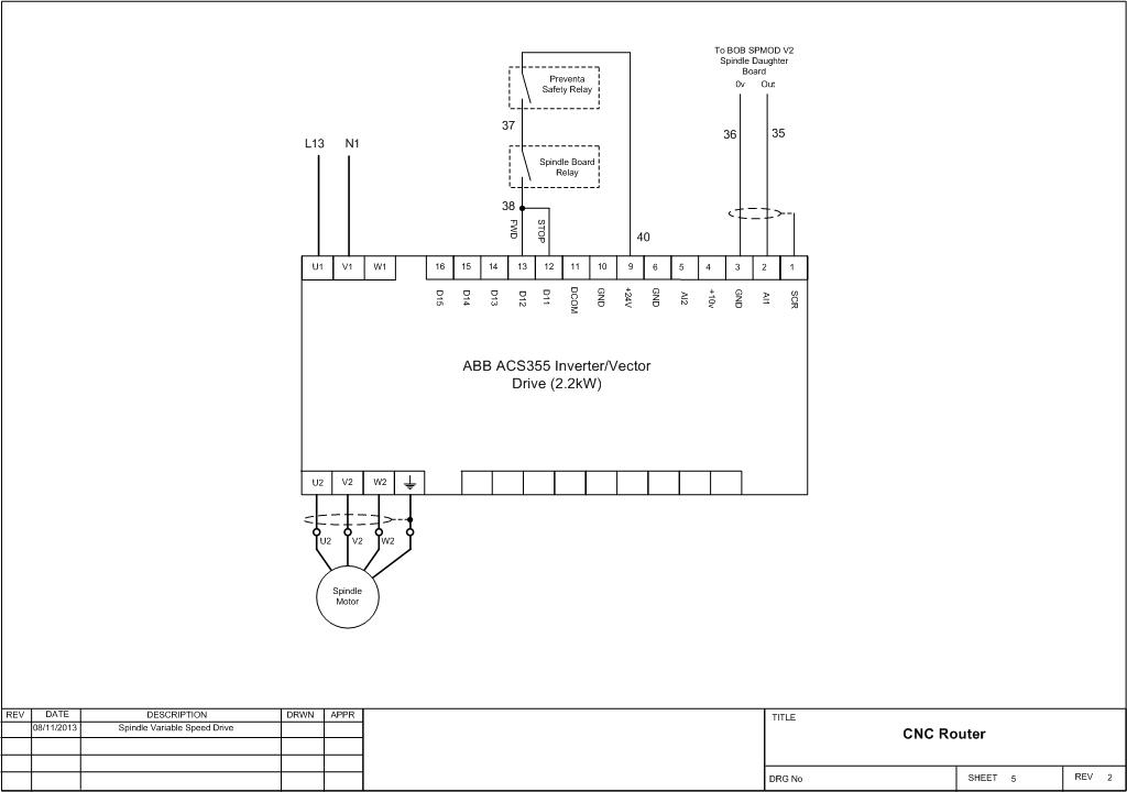

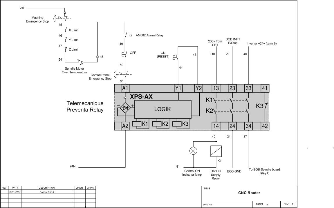

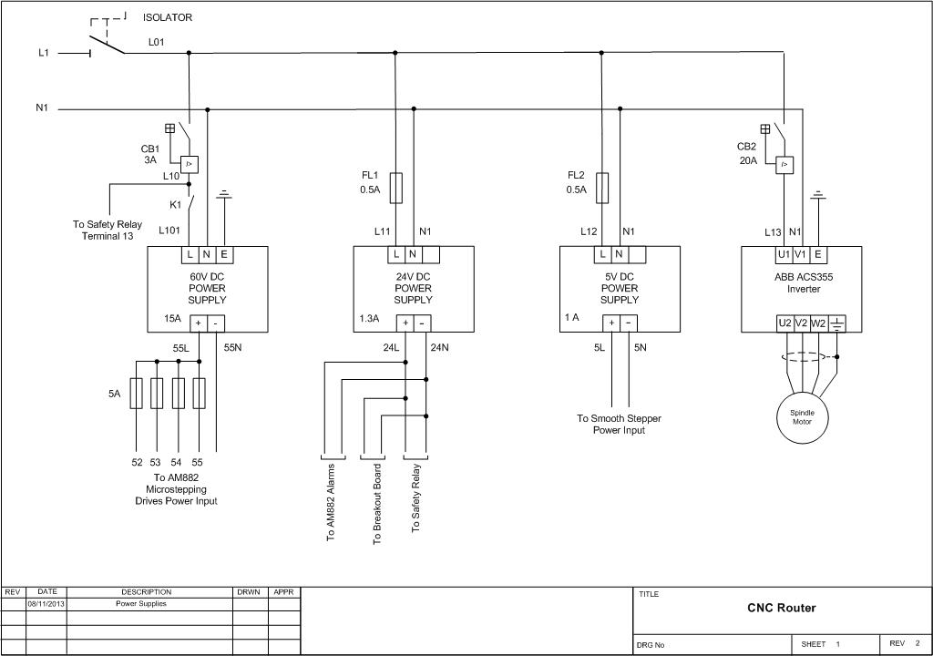

Name:	CNC Machine - Rev2-1.jpg
ID:	10721Click image for larger version.
Name:	CNC Machine - Rev2-2.jpg
ID:	10722Click image for larger version.
Name:	CNC Machine - Rev2-3.jpg
ID:	10723Click image for larger version.
Name:	CNC Machine - Rev2-4.jpg
ID:	10724Click image for larger version.
Name:	CNC Machine - Rev2-5.jpg
    Quote Originally Posted by cncJim View Post
    Where are you planning to mount the various connectors? I guess the bottom panel?
    No connectors, I'll be glanding off the cables at the bottom and wiring into the DIN rail mounted terminals
    See drawing, yes, I'll probably include in the E/stop circuit the following; ultimate travel limits, machine mounted E/stop button, spindle motor over temperature sensor, AM882 alarms.
    The homing limits are wired separately they are not in the E/stop circuit.

  5. #34
    Thanks again Eddy, you have saved me many hours/days of Googling!

    I like the idea for the spindle motor over temp. Have decided how you will implement this at the spindle?
    The spindle is an ELTE 2.2kw TMPE3 12/2 and has a built in switch for temperature.

    Eddy Save your self some inputs and just wire the Home and limits in series. If using separate home switches to limits you'll just need 2 inputs and if sharing same switch just one.!
    Not sure if your aware or not but by default when Mach homes it just moves one axis at a time so can be wired in series with no problems. You only need on separate Inputs if you change the homing script so all Axis home together. It's actually better leaving in default mode because it's very easy to damage tools etc because when you press Ref all home then all 3/4 axis set off homing at same time and it's very easy for tool to catch something because the Z axis hasn't lifted enough before X or Y drag it into clamps or material etc.
    Mach's default homing first lifts the Z axis then Y axis followed by X axis making it safe. In practice when wired in series this also means tripping any switch can set the axis being homed at that time.? Ie pressing X axis switch while Z axis is homing still sets Z axis home position.? Mach doesn't know or care which switch is pressed, all it cares about is seeing the input state change then setting the coordinates for the axis it was homing at that time then moves onto the next axis etc.
    Also spotted you have the ABB 355 vfd same has me. I don't see any reference to the water pump on your schematic and I also don't see any reference to it from the VFD so not sure if your using WC spindle or not.? . . But What I do is use the On board relay on the VFD to turn pump on/off this way it's only on while spindle is spinning.
  9. #37
    Thanks, yes, I found out about that while testing the setup here.
    http://www.mycncuk.com/forums/market...html#post51374
    Air cooled ELTE spindle, yes good idea to use the relay for that.

    Following Dean's reply and also my tests in another thread I have updated 2 of the drawings so that the X,Y,Z home limits are in series but the A home limit needs to be separate because it's slaved off X as I'm using 2 individual motors driving two ball screws. I'll still bring 2 core cables back from each switch to the machine mounted terminal box but I'll series them up at the terminal rail. (leaves option for later if need be)
Name:	CNC Machine - Rev3-2.jpg
ID:	10730Click image for larger version.
Name:	CNC Machine - Rev3-3.jpg
    With regard to safety, final, ultimate limits (whatever you want to call them) then it is not a good idea to involve software which is why I have them in the hardware E/stop circuit.
  12. #40
    Yes this crossed my mind, I may change this strategy at some point. To be honest I just included that option at the last minute without much thought. Just a quick thought, maybe if it was an input to the breakout board it could tell Mach3 to close down in an orderly fashion home itself then stop the machine.
    Nice thought! As a result of the input would it be possible instruct Mach to issue a Feedhold, raise to safe z and shutdown the spindle? Would be nice to be able to continue the job after checking things out?
    My machine also uses two motors driving x - interesting to see how this should be wired.
    That's a good idea. I have quite a bit of Cat5 cable and I was thinking of using this. Figured the twisted pairs would be good for noise rejection. Second thought, the Cat5 is also shielded but I am thinking the cable may be too bulky/stiff...
    Agreed - I haven't designed my safety circuit yet but was planning on basing it on the example circuit in the Mach 3 manual.
