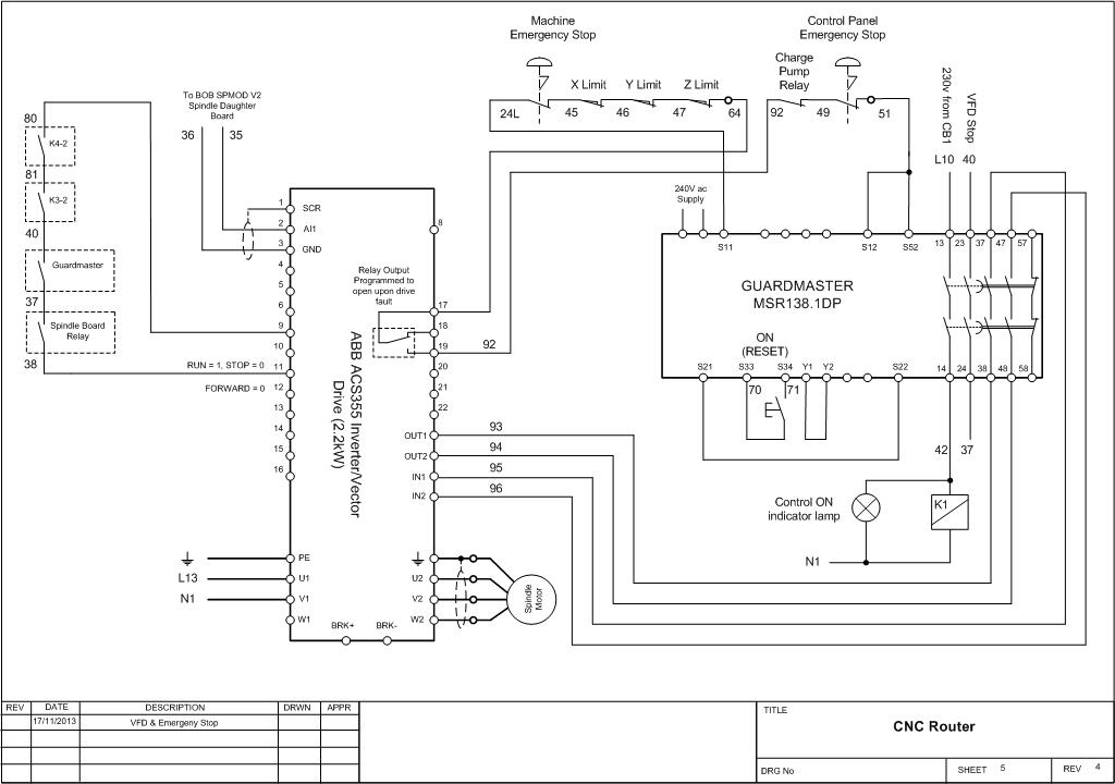

    finding a suitable off delay for the VFD contactor AT THE RIGHT PRICE is proving a challenge right now. There are some cheap ON delays which could be used but would not be fail safe.
    This seems to be the document required, have not read it yet but the title is "Application Note
    Interfacing AC Drives with Safety Relays"
    http://www.ab.com/support/abdrives/p...lays_Rev04.pdf
    Excellent doc eddy, spot on. Also very handy as it details hooking up a AB msr138dp which I have just bought on ebay for £30! After looking into the specs there are 10 different varieties (various voltages/delay ranges) and I think this is the right one/most useful (hope so, I've bought it now!) - 440R-M23143 (24v - 0.15 - 3 seconds delay)?

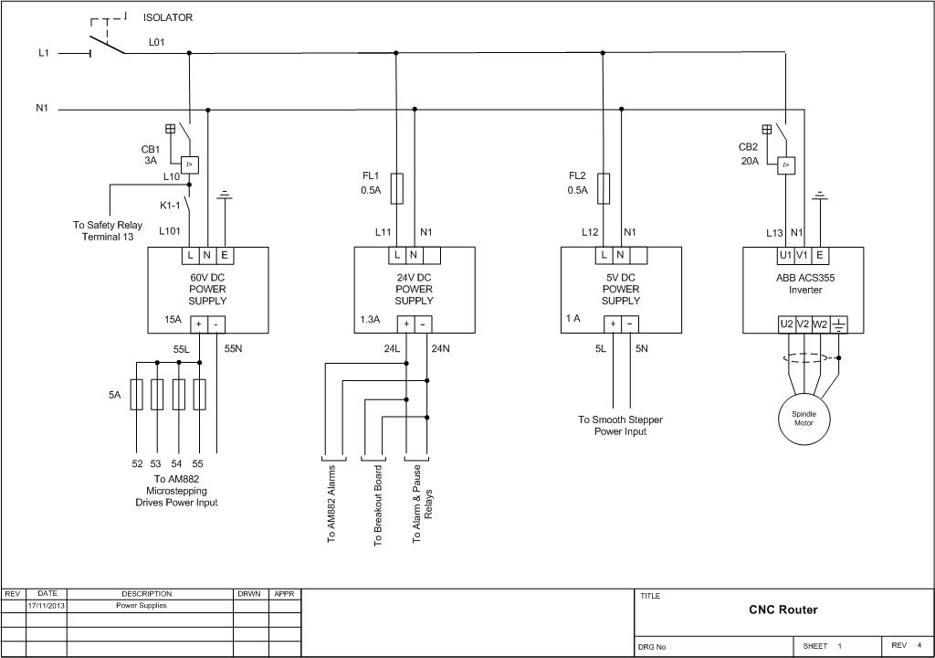

    Good timing lads !
    @silyavski, the temperature switch was already built into my spindle, it is closed normally and opens at high temperature.

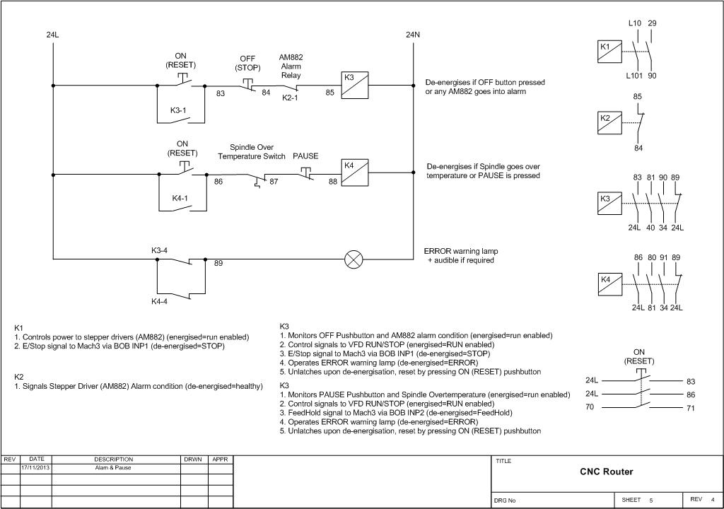

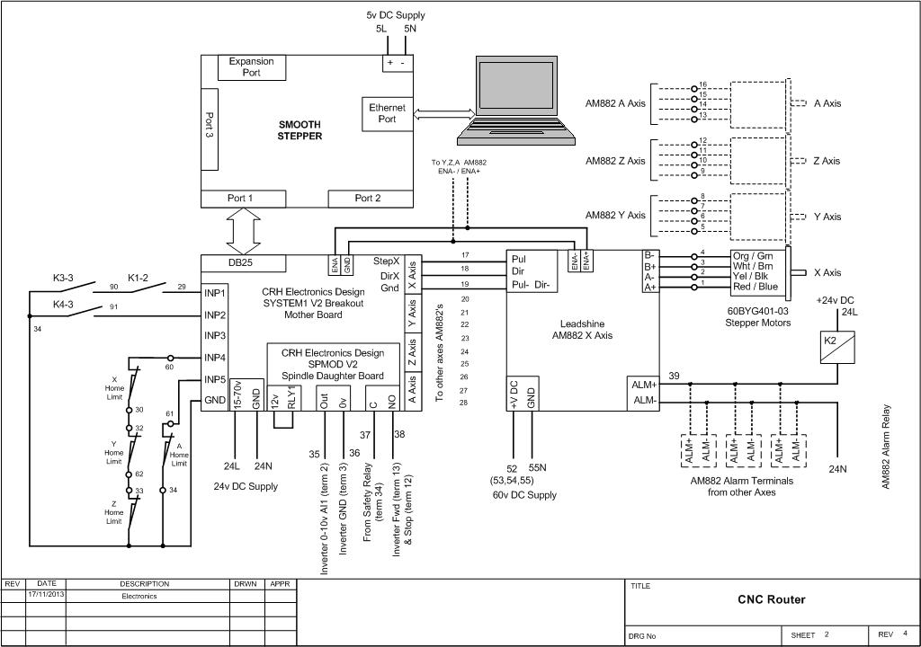

    @cncJim, see latest drawings
    Here are my latest drawings
Name:	CNC Machine - Rev4-1.jpg
ID:	10806Click image for larger version.
Name:	CNC Machine - Rev4-2.jpg
ID:	10807Click image for larger version.
Name:	CNC Machine - Rev4-4.jpg
ID:	10808Click image for larger version.
Name:	CNC Machine - Rev4-5.jpg
    Features
    Strategy 1
    * Emergency stop immediately signals VFD to stop and several seconds later (time to be assessed but possibly 6 seconds) delayed contacts of Guardmaster safety relay open to operate STO (Safe Torque Off) feature of VFD which disables control voltage and power semiconductors.
    * Power removed from Stepper Drivers via Guardmaster safety relay and K1
    * Stop command issued to Mach3 via K1 (even if Mach was still active the VFD and Stepper Drivers would still be disabled)
    Strategy 2
    * Stop signal sent to VFD via K3 relay
    * Stop command issued to Mach3 via K3
    * Enable (ENA) signal activated via Mach3 and BOB to disable stepper drivers
    Strategy 3
    Not implemented - same as Strategy 2
    Strategy 4
    * Stop signal sent to VFD via K4 relay
    * FeedHold command issued to Mach3 via K4
    Strategy 5
    Not implemented
    Notes:
    Strategy 3 could be implemented by incorporating a relay contact from K3 into K1 coil circuit however because all 4 contacts of K3 are being used another single contact relay would have to be connected in parallel with K3.
    Strategy 5 could be implemented by removing the Pause push button and having only K4-4 contacts operational.
    * A PAUSE push button has been added, this will stop the VFD and send a FeedHold signal to Mach3, to continue the ON (RESET) push button is pressed.
    * A Charge Pump relay has been added to the Emergency Stop circuit this so the system can initiate an Emergency Stop if the software stops or communication is lost.
    * If the Circuit Breaker for the Stepper Drivers trips then K1 will de-energise and send a STOP signal to Mach3.
    * ENA signal now connected from BOB to all Stepper Drivers
    ( ** As yet I have not cobbled together the Charge Pump relay but I think a small 5v coil one will do the job as my BOB can source 20mA. **)
    Relays K2,K3 and K4 are these
    http://www.ebay.co.uk/itm/1set-Base-...item5d388b7d84

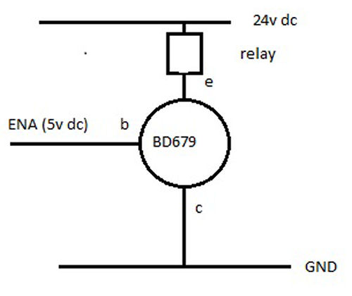

    I'm thinking this is going to be my Charge Pump relay circuit. My BOB ENA signal is active low so the relay will be in the 'healthy' state when de-energised, this is not fail safe and I could have inverted the signal but it's going to do. The BOB is supplied by 24vdc and so GND is common to the 5v and the 24V.
  6. Quote Originally Posted by EddyCurrent View Post
    You have C and E swapped over. Its an NPN so E is always to -ve rail.
    with only 3 or 4 more components you could make it failsafe and i would...

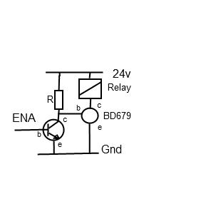

    Irving, you are right, I just threw the drawing together on Paint and I have indeed got e and c crossed over. What would your plan be to make it failsafe ?
    Maybe this ? (sorry for poor drawing, no tools at hand on this pc)

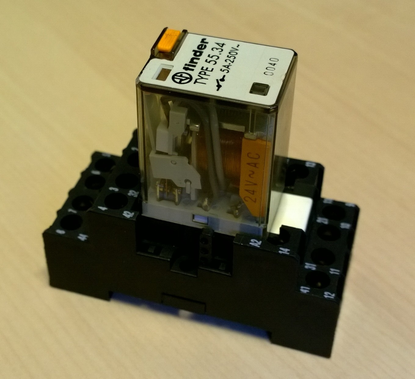

    Good stuff EddyCurrent, I'm still working my way through your diagrams trying to fully understand :) - Do you have any provision for activating your estop circuit from the controlling software? I suppose the argument could be made that its not needed unless the pc a distance from the machine?
    I have just acquired 10 of these from a control panel I stripped down (7x 24v and 3x 230v) which seem to be a similar spec to yours:-
    Finder TYPE 55.34
    The 5A rating, is that for the entire relay or for each contact?
    There are also 4 contactors which I haven't taken out yet. Are there any practical/safety differences between a relay and a contactor?

  9. Quote Originally Posted by EddyCurrent View Post
    that'll do it. i'd put a series resistor between BOB and base of transistor, value depends on pull-up on BOB. If there is no pull-up (i.e. its an o/c output) use 10k to 5v rail.
    R needs to be something like 2k7 0.5W rating if connected to 24v, or 470R 0.125W if connected to 5v rail.
    BD679 is fine as output transistor if a bit of an overkill. Any small signal NPN with a gain >50, Vce >40v and Ic >200mA will do for the input transistor e.g 2N3904, BC337 or similar
  10. #70
    If the breakout board output is open collector, why not reduce the component count by using a PNP transistor to invert the signal?
    e.g:
    Edit: Also don't forget the back-emf protection diode!
