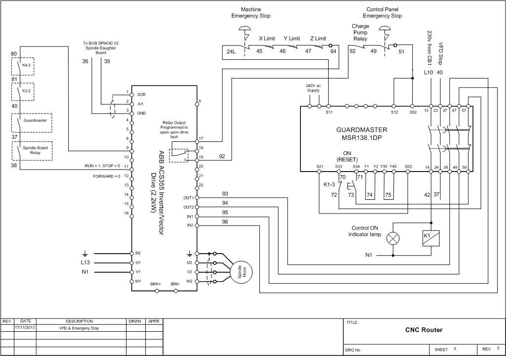

    Drawing updated, (added a link missing on E/Stop relay, added K1 feedback contact and E/Stop relay N/C contacts into RESET circuit). This will be the last update of drawings until the project is finished and I shall post the 'as built' version.
Name:	CNC Machine - Rev5-5.jpg

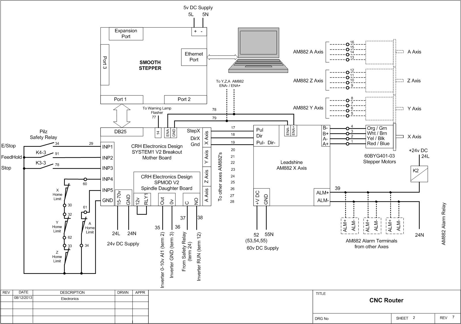

    Mach3 Brains have been used for the control panel pushbuttons and the control panel red led for alarm indication.
    I used 'output 1' from Mach3 which is configured to 'pin 14' of the breakout board and constructed a relay using one 2k2 resistor in series with the base of a BD679 (overkill but I already had some). The Mach3 Brain logic then controls output to this solid state relay which in turn controls the red led.

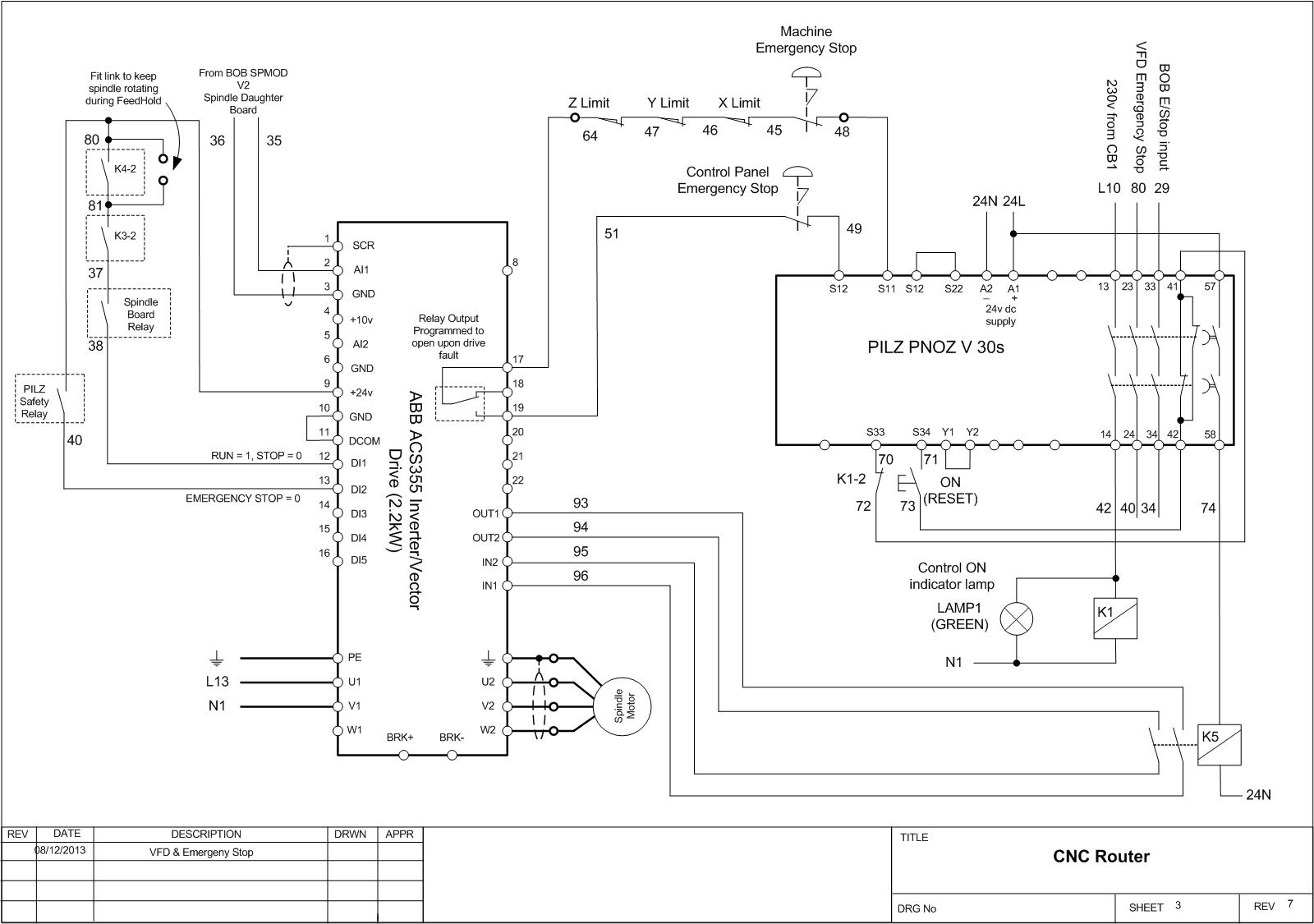

    I also revisited the Emergency stop circuit and the Stop / Pause ' Reset functions, they now operate as described below.

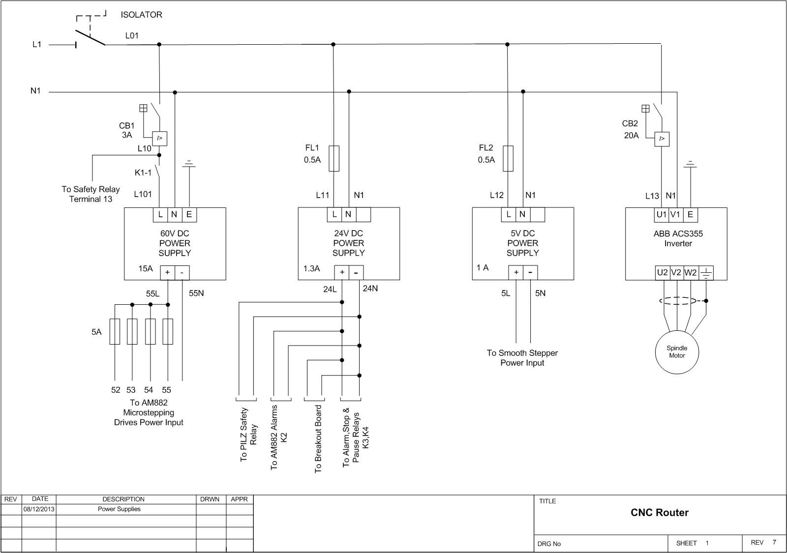

    Attached are the schematics and in the Zip file are the Mach3 Brains for pushbuttons and alarm indication also a spreadsheet showing the logic used.
    Emergency Stop circuit
    consists of 2 emergency stop buttons, one machine mounted, one control panel mounted, machine limit switches, VFD fault relay.
    Upon activation of the E/stop;
    1. The VFD uses special emergency stop ramp (faster than normal stop ramp) and after 6 seconds it's STO function is activated via the PILZ relay and K5
    2. K1 is de-energised removing power to the AM882 drivers
    3. E/Stop signal sent to Mach3, charge pump stops and breakout board uses 'enable' output to disable all outputs to AM882's and spindle.

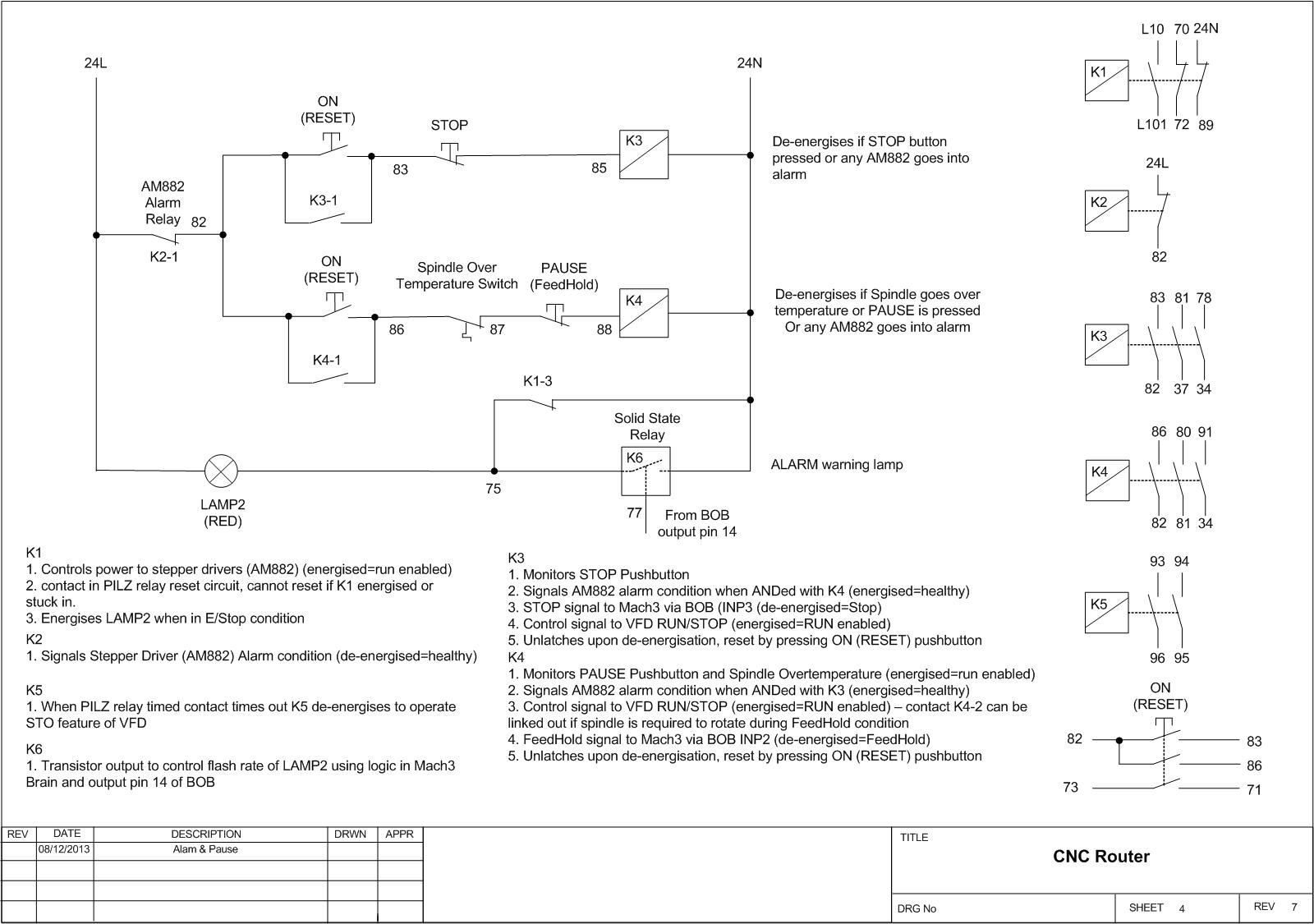

    'Stop'
    Stops operation of machine by de-energising K3, sending Mach3 a 'stop' signal, also stops the VFD by removing the RUN signal.
    Can be activated by;
    1. using control panel red push button
    2. any AM882 going into alarm
    'Pause'
    Pauses operation by de-energising K4, sending a 'FeedHold' signal to Mach3
    can be activated by;
    1. using control panel blue push button
    2. spindle over temperature switch.
    3. Any AM882 going into alarm will de-energise K4 because it's going to stop the machine in any case. The Mach3 Brain uses K3,K4 logic for alarm indication.
    If the spindle is required to keep turning then a link can be connected as shown in the schematic diagram.
    'Reset'
    Resets the PILZ emergency stop relay also K3 and K4 via green push button.
    1. If the machine has just been switched on the green pushbutton will reset the PILZ relay and K3, K4, sends Mach3 a 'reset' signal
    2. If the machine has been 'paused' the green push button will reset K4 and send Mach3 a 'Cycle Start' signal.
    3. If the machine has been 'stopped' the green push button will reset K3 and wait for user intervention to restart via Mach3 screen.
    green led (power on)
    indicates the PILZ emergency stop relay is energised
    red led (alarm/fault)
    provides indication by means of flashing at different rates for;
    E/Stop was pressed
    'Stop' initiated from Mach3
    'FeedHold' initiated from Mach3
    'Stop' initiated from Control Panel
    'FeedHold' initiated from Control Panel
    AM882 Driver in fault
Name:	CNC Machine - Rev7-1.jpg
ID:	10981Click image for larger version.
Name:	CNC Machine - Rev7-2.jpg
ID:	10982Click image for larger version.
Name:	CNC Machine - Rev7-3.jpg
ID:	10983Click image for larger version.
Name:	CNC Machine - Rev7-4.jpg
    Attached Files Attached Files
