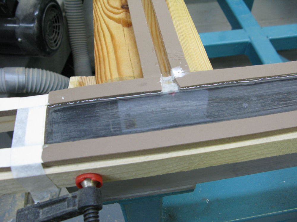

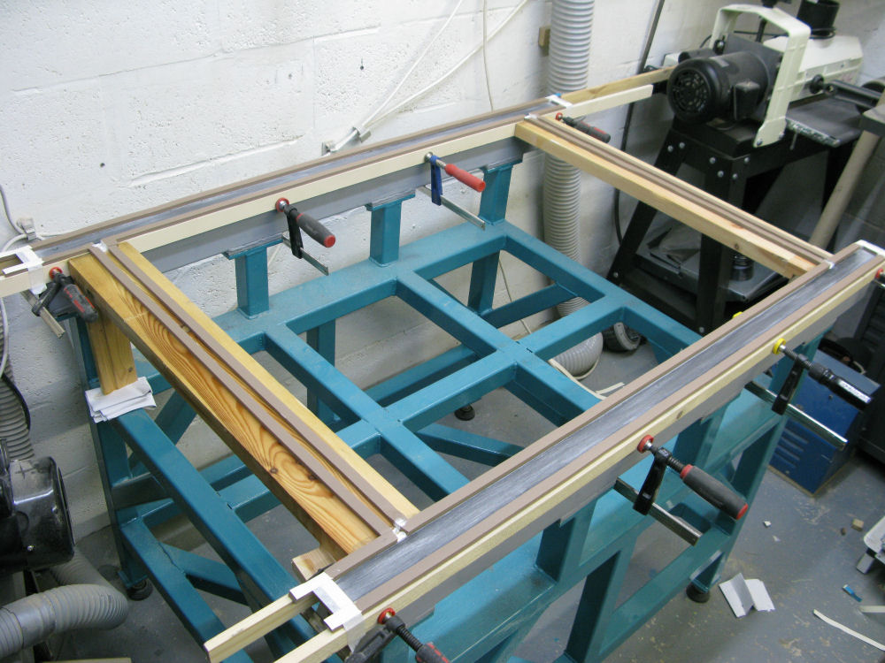

    This is before showing the moat in place. Clive S recommended 10mm epoxy each side of the linear rail so with my rail being about 20mm wide the epoxy bed has to be 40mm wide. Because my support beam is 50x50x3 box section it only left 5mm spare each side which meant the draught excluded would have been on the radius of the box section, that's why I clamped strips of wood each side so as to fully support the draught excluder. You can see I've coated the joints and any gaps with sealer.

    This is after the pour, you can see the meniscus. There were no leaks and there was never any risk of it overflowing the moat. The epoxyducts were about 10mm wide and I'm thinking they could have been wider, definitely no smaller, the reason being that with this viscosity it needs a decent channel to flow down otherwise I would not be confident that the whole surfaces were at the same level.

    Eddy That looks nice re the moat I did find that my moat could have been a little wider although I did have two of them. I am sorry that I forgot to mention that before but you have plenty of width now in the centre even you don't get rid of the meniscus. ..Clive

    I think the meniscus extends about 5mm across the width so with that each side it leaves a 30mm flat section in the middle, as you say that will be plenty for rail mounting. A file will soon sort out the meniscus removal later.
    I forgot to mention that I had an epoxyduct at each end, plus, and it might be going extreme, I gave the epoxyduct pieces of wood a coating of sanding sealer thinking that the bare wood might soak up some of the epoxy, unlikely though it might be.
