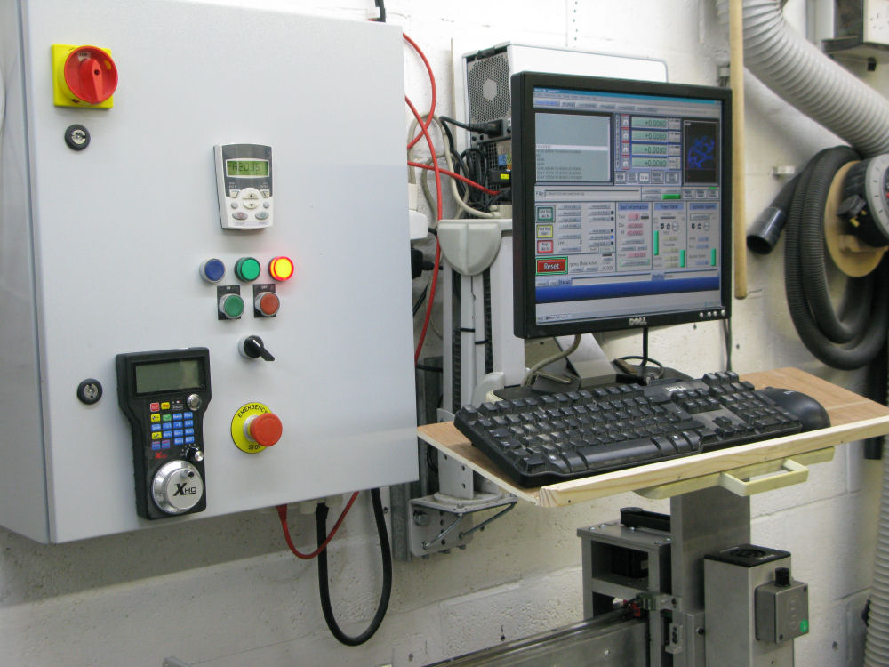

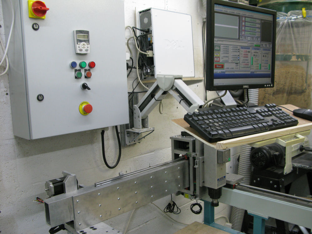

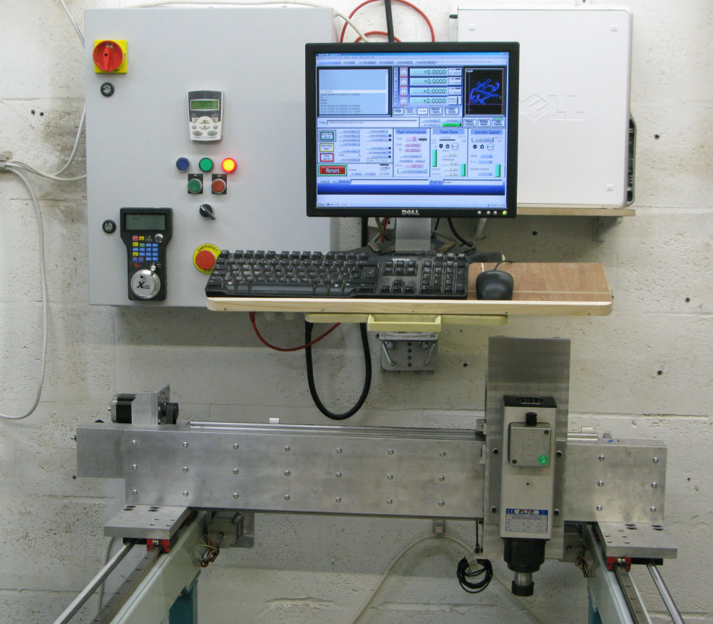

    Thought I'd have a play with other stuff while waiting for the energy chain to arrive.
    As I'm a hoarder I've had an old TV wall bracket in the attic for years, it can be extended out quite a long way and swivels side to side. As it is, the keyboard can be accessed easily from each side of the machine and from the front.
    The wireless MPG has magnets built into the back allowing it to 'stick' to the panel.

  10. #229
    Very nice set up Eddy. I assume the keyboard and monitor swing around to the side so you don't have to lean over the bed to get at them?
    Looks like you are into woodwork as well, if I'm not mistaken that's a Jet 16" drum sander in the background. I'm planning on making a drum sander once the CNC (and workshop) is built. It'll probably turn out to be cheaper to buy one but where's the fun in that.
