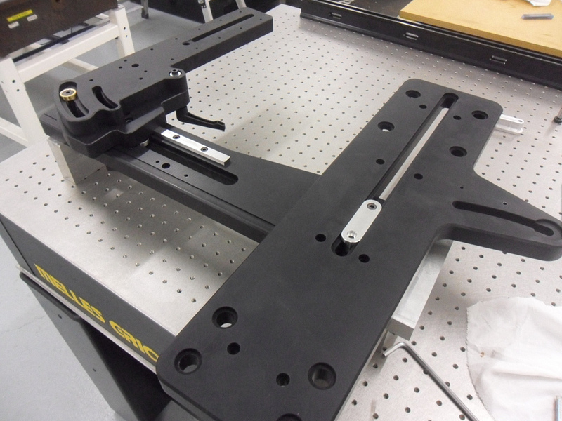

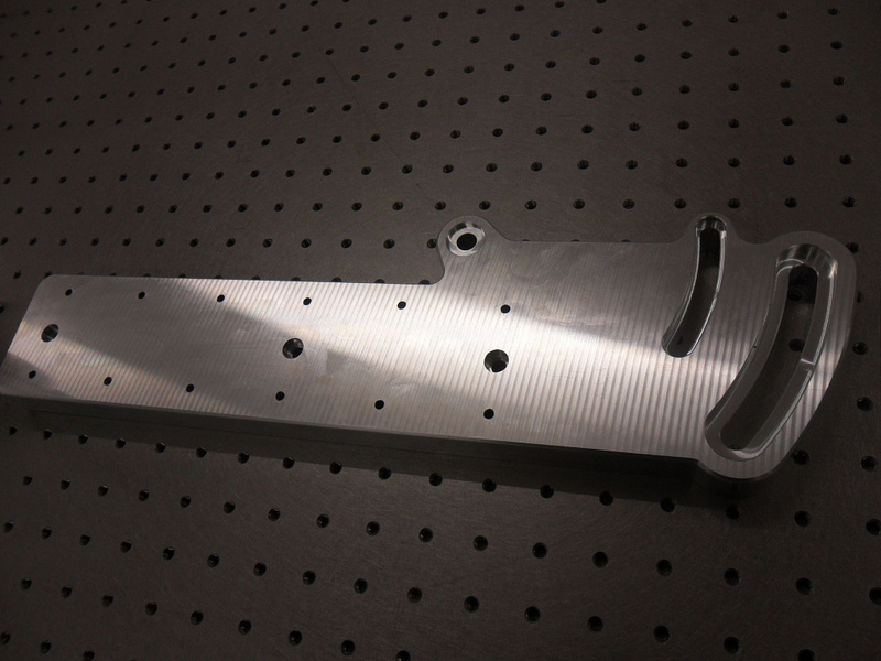

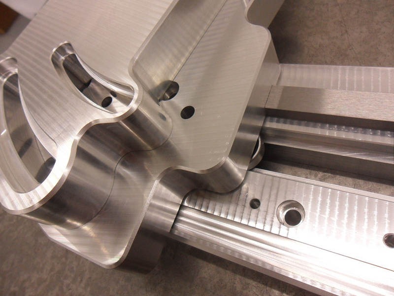

  1. Hers something we have been CNC machining lately its a jig for building bicycles on:

    Huh that fixture table looks expensiveeeee and I bet those Jigs weren't done on a Diy build. . Lol
    What coating did you put on those nice shiny tooling plate jigs.?
    any chance of a photo of a bike in a jig?

  7. Quote Originally Posted by JAZZCNC View Post
    Hey Jazz its an optical alignment table your quite correct , they were done on a hurco
    I am designing some cnc controlled fixtures and machinery though for the shop but without an industrial cnc its kind of hard to make them
    Its simply hard ano with a coating called marbocoat applied after to stop epoxy and the like adhering
    Do you mind revealing what cutters you used to get the seemingly good finish?
  9. Quote Originally Posted by Jonathan View Post
    Jonothan
    i use the aluminium specific WNT milling cutters any aluminium specific cutter will give you a pretty nice ,they eat material though you have to be careful at your ramp in when side milling as they like to take a big bite they supply the place i used to work AMRC | The University of Sheffield Advanced Manufacturing Research Centre with Boeing the fancy finish on the tooling plate is just standard mic 6 the actual face mill they use is a PCD insert on a 1.6m dia face mill ,
