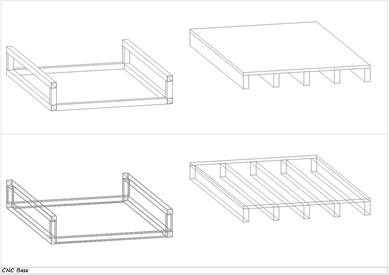

    I'm a cabinet maker by trade and have been making cabinets and kitchens for several years. I've also worked in electronics using a soldering iron etc and also in computer programming writing accounting software so I should be alright making a CNC, but I'd need help at times too I'm sure! I've never owned a CNC machine and so I've always deliberately made furniture that was hard to mass produce. So I make a lot of solid wood cabinets, from pine 8x4s mostly but also using beech for doors and faceframes,... the cabinets have 'in frame' type doors, and they're often handpainted.
    CNC wise I'd like to build a router for wood, as a hobby firstly but I'd also fully expect to use it in work once it was working. I already have some ideas for low cost cabinets made primarily from MDF but the CNC would obviously have many uses in a commercial workshop !
    The size of the CNC is tricky. I'd like it huge but that's unfeasible for the moment I think. So I'm thinking of having a working size of approx 1,100mm x 700mm, with a Z-axis of approx 125mm. (Which is tiny obviously... ) I'm not too fussy about the design and I'd happily use someones else design if they didn't mind! I'd like the X-axis to be infinite.. in other words that I can do one pass on my workpiece, and then move the workpiece using index points of some sort, and do a second pass. Working size of 2,200 x 700 in two passes in that case which would cover virtually all cabinet making jobs.
    I'm also considering mounting the CNC on a base 8x4 panel, and not on a massive base. I can make what I think is called a 'torsion box',.. which is basically two 8x4 sheets, about 4 inches apart, with bracing between them. This is pretty simple and would mean the machine could be stored or moved easily. My current workshop isn't huge at all.
    I'm more or less ready to start ordering my linear rails and ball-screws!! On the credit card of course, ha ha. Chai seems to be recommended so that's great. I checked him out and he seems very cheap. I know there may also be import charges.
    My main question is whether my size of 1,100mm x 700mm x 125mm is feasible and if there's a previous design of about that size that I could copy ! If it's bad ethics to want to copy a design then I'm sorry for mentioning it and I'll come up with my own. It's just reinventing the wheel and all that.
    My budget is what it takes, 1,500 to 2,000 I suppose.
    Cheers so
    Joe
    Hi Joe and welcome
    Jazz or one of the guys will be along shortly but don't want to rain on your parade but the base won't work, far too flexible, Jazz has a machine mounted vertically which might be something to think about but i think you are going to have to consider a steel construction.
    Mike
    Yes, a steel frame is a must if you want a good machine.

    I'm not sure at all now what to do about the base. I really wanted to use a panel of some sort as I have access to panels and tools to work with wood, mdf etc. A panel could be made very rigid with bracing. My working size of 1,100 x 700 isn't huge I didn't think, and my spindle would be 3Kw max. I'll probably have to use some wood or mdf, plywood etc in the Y axis gantry and elsewhere as I don't think I'll be able to get machined aluminum or steel parts for everything. So I don't think I can achieve the nirvana of a shiny all chrome machine and so I was thinking I could compromise on the base a bit!
    I'm still thinking about the inclined version. It was strange at first to consider but it does seem quite good alright. Like a vertical panel saw which you might see in the big hardware stores. Have people noticed any problems with vertical CNCs? All backlash might be taken up by gravity in one direction, and doubled in the opposite direction.

    I've started some drawings but it's so hard to draw the whole machine. Not that I've got much further than the base! It is 3d of course though.
    I drew up a steel base, and a braced panel base.
Name:	CNC machine-CNC-bases.jpg
    The steel on the left would need additional mounting points for the ballscrews.
    Is it usual to drill and tap holes directly into the steel frame? It must be a lot of work to make a steel frame which is ground flat and is tapped for supported rails.
    I'd love to have a steel frame but I don't think I can go for it this time. I'll definitely ring a company about it though to price it up. If I thought I could have a suitable base made up for about £300 I'd be happy to pay for it.
    The base on the right is my suggested panel base.
