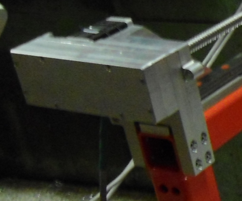

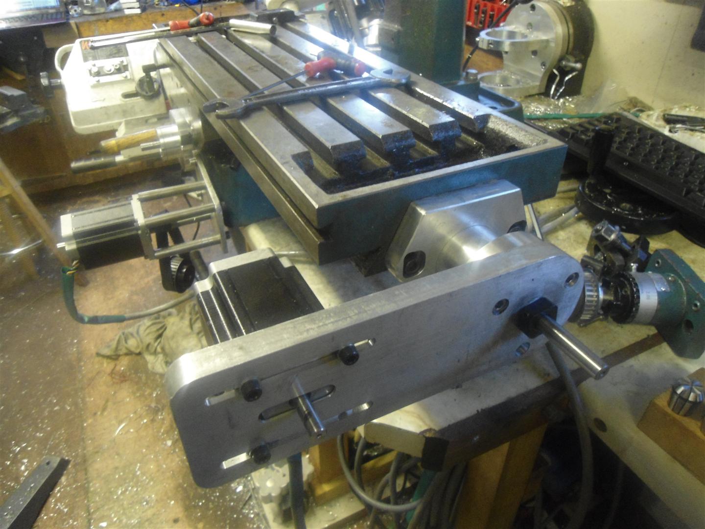

    Just wondering...why does everyone seem to mount their motors on stilts or peg legs? It seems like the worst possible way as it's both weak and (in my opinion) unsightly. Is there some advantage that I'm not aware of?
    Example (no offence meant Jonathon!):
    Quote Originally Posted by birchy View Post

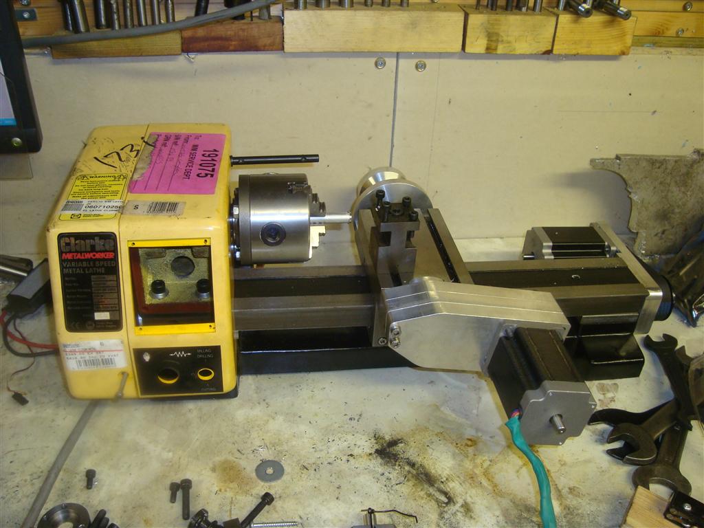

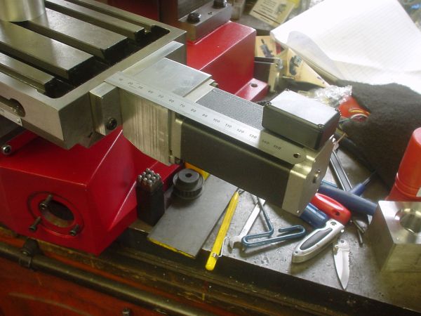

    Agreed and not everybody does, I don't.!! . . Here's some of mine. Reason they do it is because it's easy and cheap.

    Edit: Ah ah just realised motors on wrong side in this picture.!!
    Yeah, "everyone" was a bit too general, but I see a lot of motors mounted on pegs. Yours look a bit posh Jazz! Unfortunately, I don't have the luxury of a spare milling machine, so have made mine from 6mm mild steel plates...using a hacksaw, a file, a cordless drill, and a lot of elbow grease and patience.

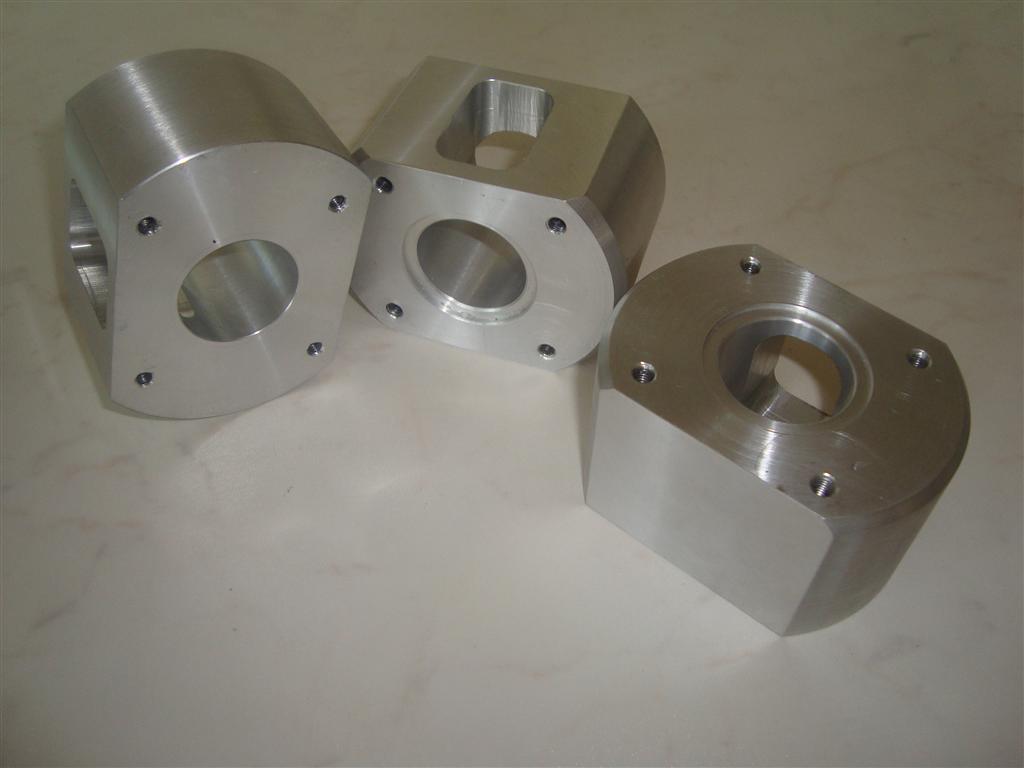

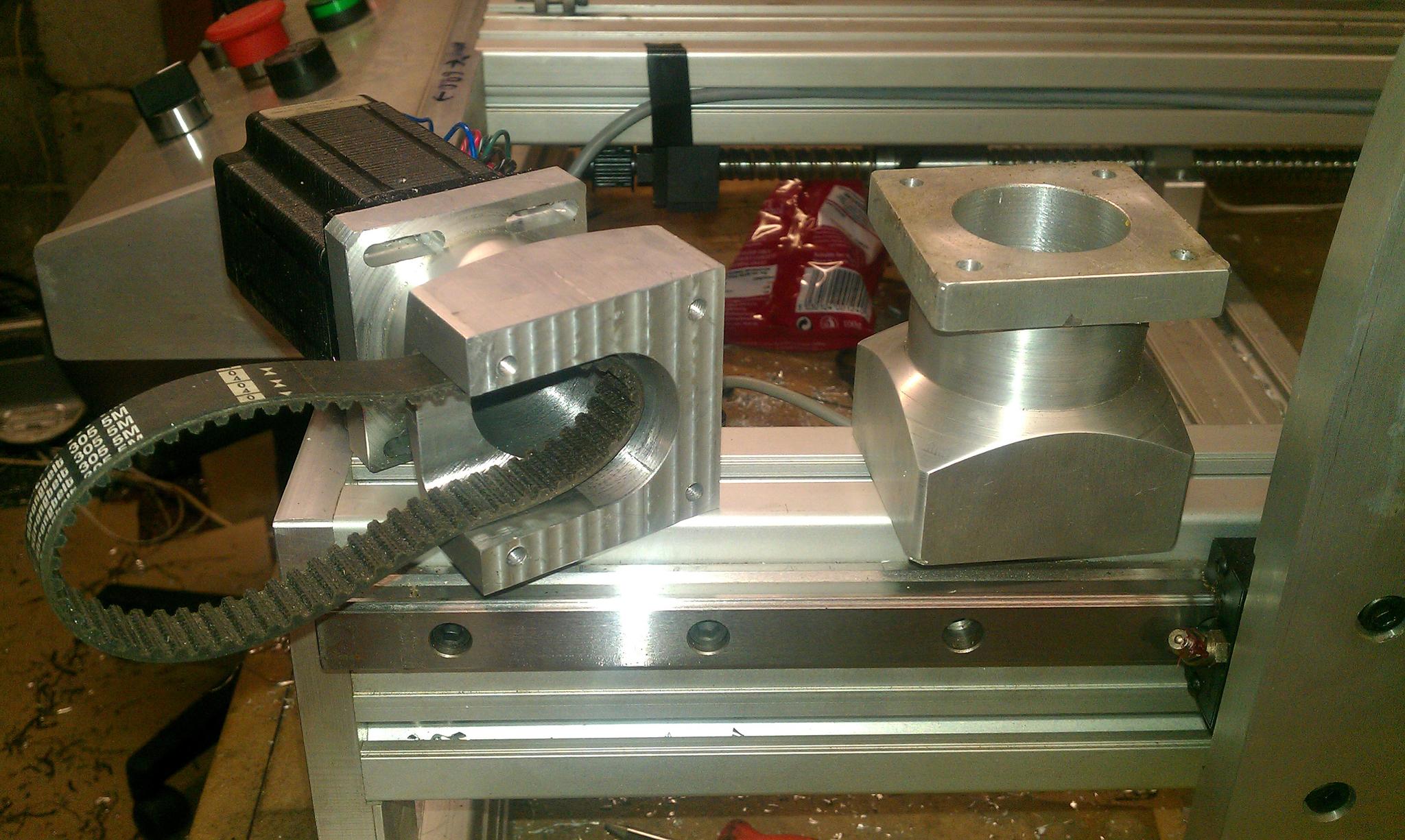

    This is one of mine.
    That alloy block contains two angular contact bearing and an Oldham coupling all in one neat package and a swap of the mounting plate means it will fit many different applications.
    John S -
    Thank fk I'm not the only one that hates those peg leg things. I see so many of them that I thought I'd overlooked something vital.
    That's a nice setup John S...care to share any more info or is it a trade secret?

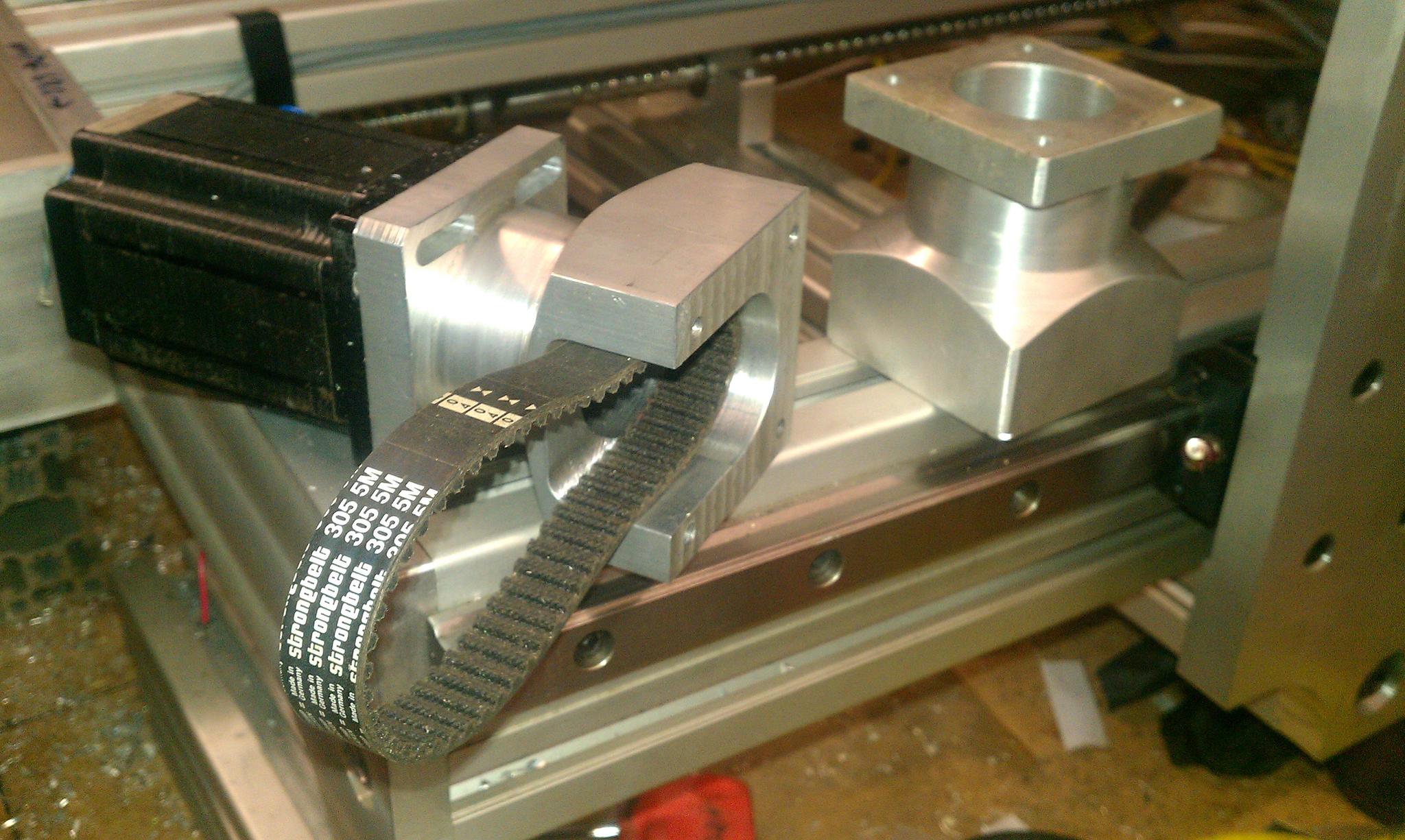

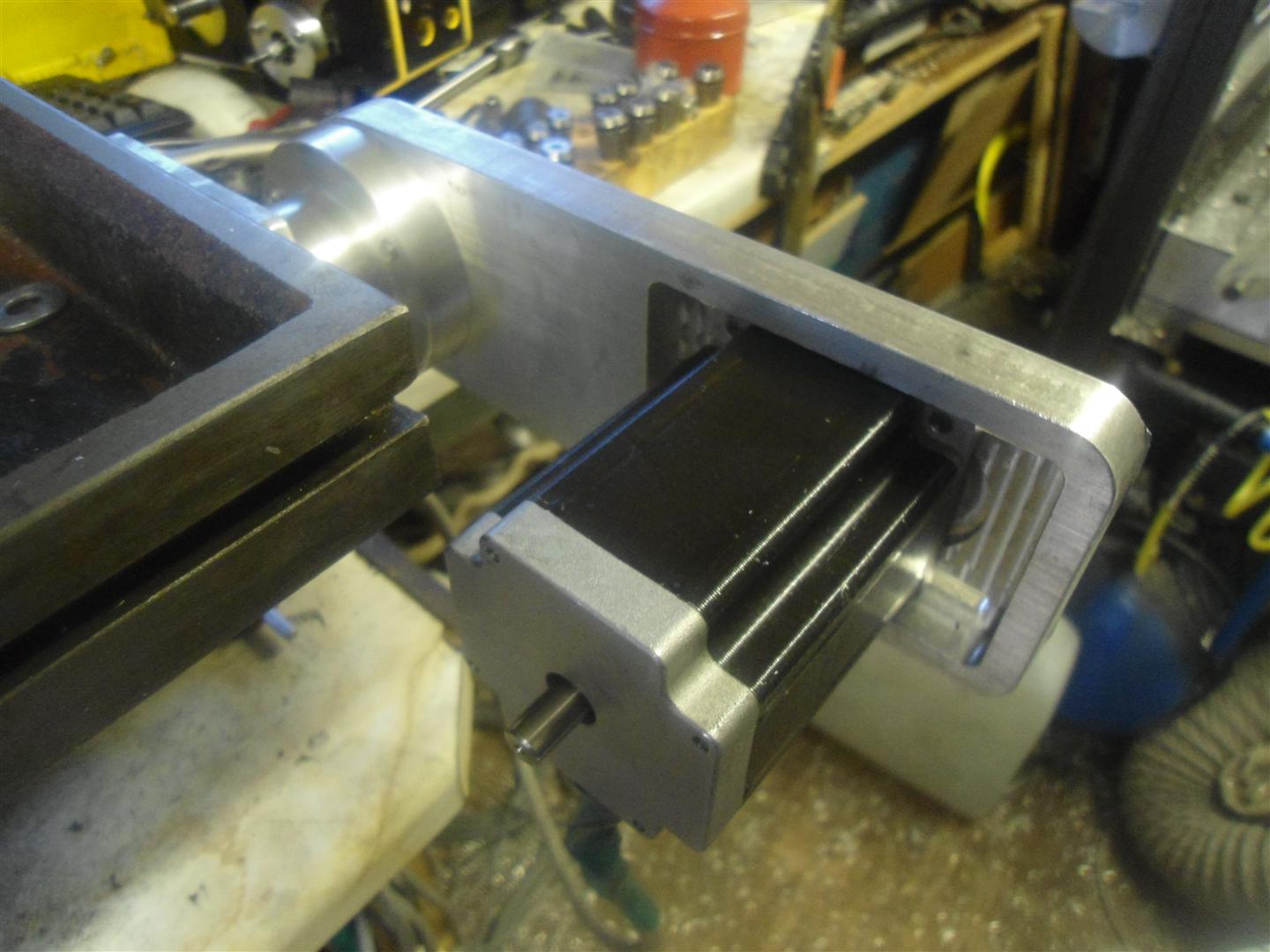

    I agree, it's a terrible idea! The photo you found is the motor mount I made when I first got the milling machine 4 years ago. At the time funds were very limited and I didn't know any better. As I mentioned in the build log it's soon to be replaced.
    My motor mounts have become have become a bit more 'serious business' lately:
Name:	DSC01671 (Large).JPG
    That's 5 pieces of 20mm aluminium thick if you include the covers...

    Here's a more average one I made a couple of years ago:
Name:	DSC08223 (Medium).JPG

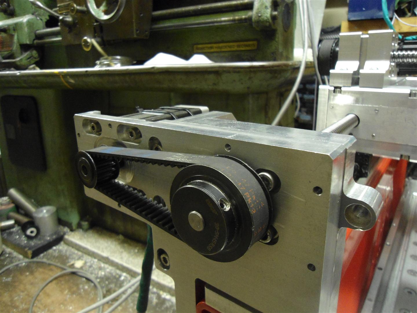

    Oh and whilst we're on the topic, here's another one which incorporates a cover for the belt:
Name:	DSC09461 (Medium).JPG
    Maybe that'll give you some ideas...

    Birchy,
    No not a trade secret, just good engineering, I'll see if i can find some exploded pics.
