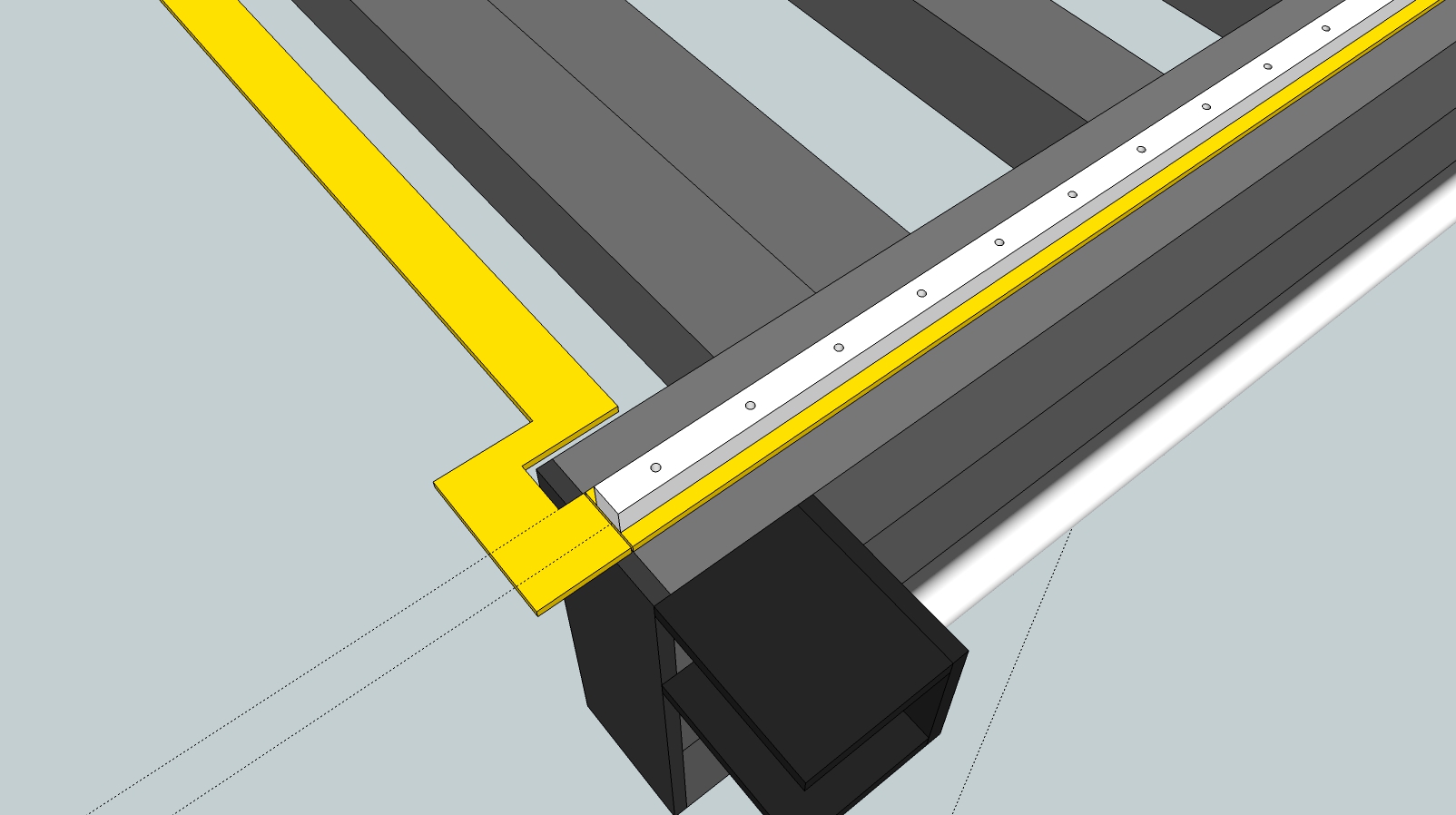

    I am starting to think of something like that:
    or
    One problem of cutting the bridge is that if i shut them off, that has to be complete, to avoid pulling. And at the same time any spill will kill the purpose.
    There must be a way to do it properly, unluckily i dont know well the material/epoxy/. Sb who works all day with epoxy will know how. cause the key may be simply to make the bridge same, wider or even more thinner to avoid the pull. But which of them. When casting aluminum i know that the hole has to be as wide as possible, cause when all shrinks, the casting holes is like a reservoir , so it pull aluminum from its core and balances the thing.
    Or may be even like this, so the rails will be thinner than the bridge and situated so that they will pull from it and play its role:
    Now the question is if i decide to shim the 0.15mm, what to use, so that when the 150kg gantry goes over that it does not change. Mix epoxy when mounting and paint the bottom, then wait to dry a bit and tighten a bit when its elastic, so it stays put in that shape.

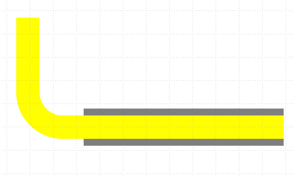

  8. #98
    Trying to balance the flow with the shrinkage while it hardens sounds like a recipe for disaster.
    Pour, flow, cut off, harden!
    Cutting the rail into equal size/shape sections should give consistent shrinkage. If you do repeated bi-sections to cut the rail (eg into 4 or 8) then (with skill/slow cut) even the slight increase in pool height should be even in each pool.
    edit:
    More likely to work and easier: One big ring of equal cross section is the best answer. Ideally you would not have a 90deg corner near what will be the final end of the epoxy rail, a radius would be nice.

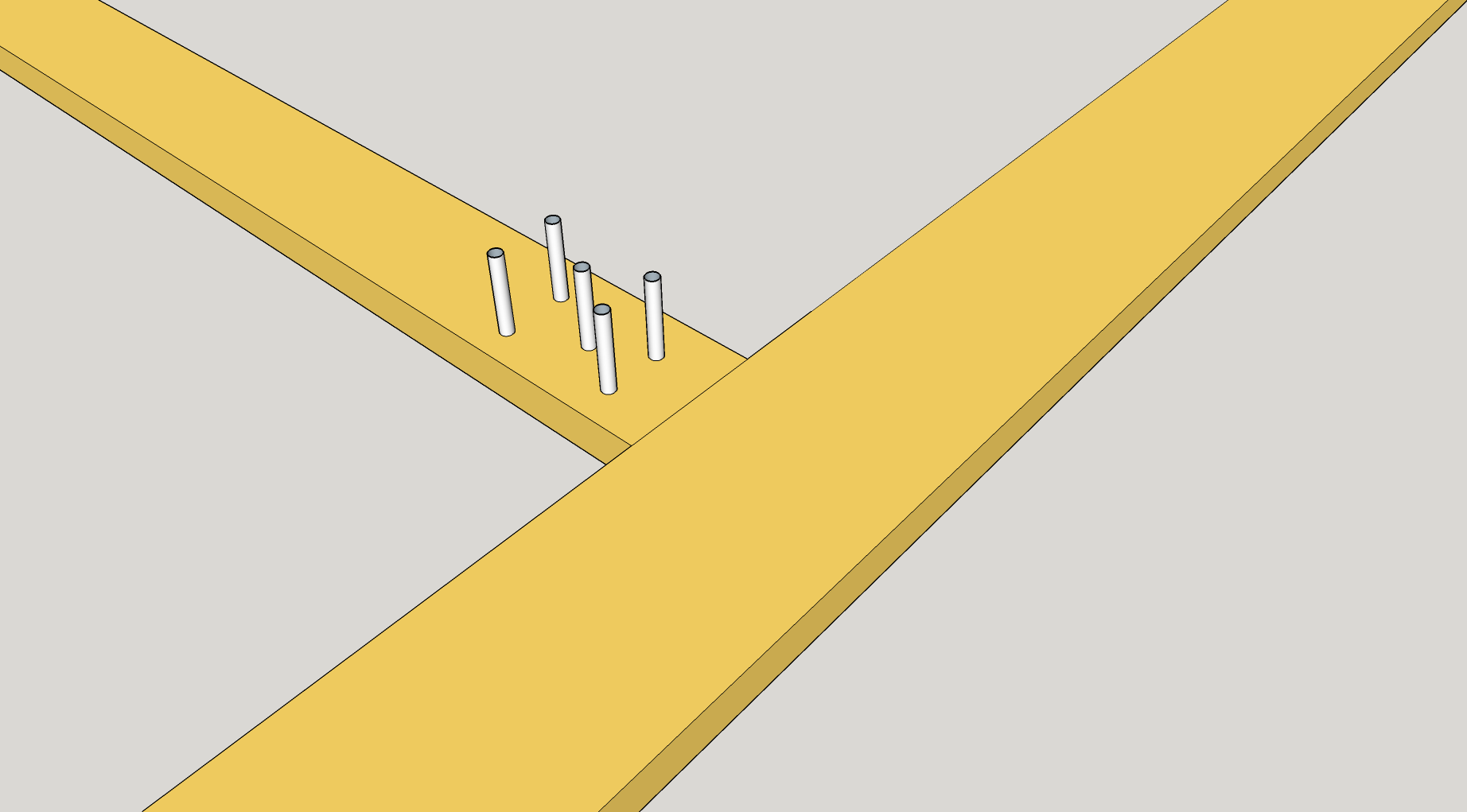

    Hi silyavski,
    Sorry to hear about your problems.
    What about adding some nails/pins to the bridge before the pore? Could this maybe help the situation?
    Jim
