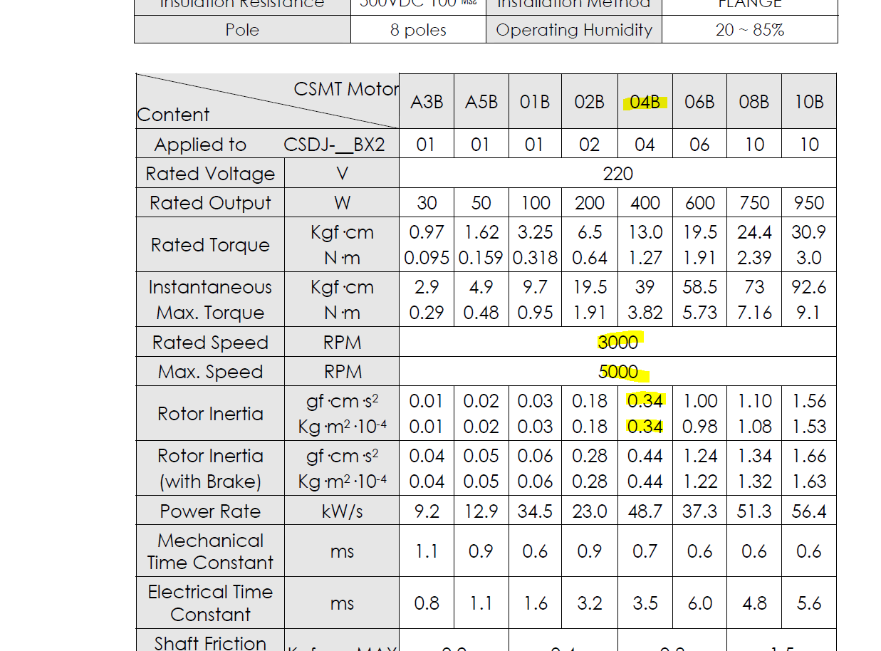

    2048 encoder on the motor, so more or less 20m/min. I see on the motor specs that it can go up to 4500rpm, just the curve is straight till 3000rpm. The resolution will be ~0.003mm on all axis , 0.001mm on the Z/ 1605 screw and 2500ppr encoder/. That without any artificial gearing or micro stepping which is not needed it seems. Thats good, cause the Galil board is not micro stepping board.

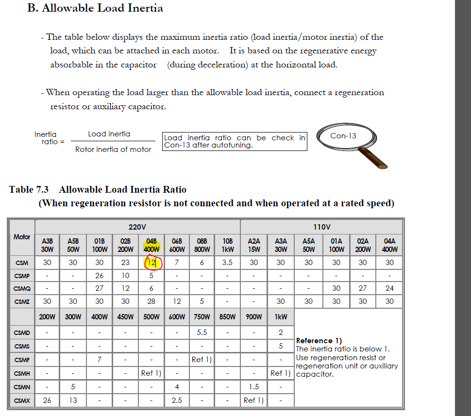

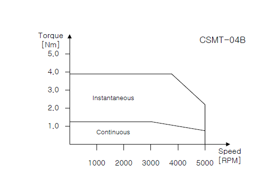

  6. #135
    Thanks Jonathan,
    i remember i calculated all this at the time of choosing, again with your help there, but as i did not understand everything very well, it was like monkey playing with the calculator buttons.
    Now i understand a little better
    It seems the actual ratio would be 12, same as the max allowed by manufacturer.
    I still have no idea about the acceleration you are talking about, what will that mean in real life, but i would like the machine to be more or less snappy as you say
    This is good example for me being similar to mine situation.
    I am wonder too what is the normal acceleration for a machine like this namely how fast would you like to reach the feed speed or the rapid speed.
    My unchecked source warn to use over sized servo -
    it says if you want to spin up to 3000 rpm a 400W motor during 10ms it require temporary 2500 W
    It did not mention the inertia ratio that is as I see very important
    factor.
    At first sight this 10 ms is to fast for me -when I put together the mosaic now -you only have to think of a corner you mill .The machine has to stop and change the direction and run up again- and the surface quality depends on the acceleration here

    It seems their limit for the inertia ratio is set by the capacitance present in the motor driver dc-bus. When the motors are decelerated, some of the energy stored in the total inertia of the system is transferred into the capacitors, since the drivers are supplied from a simple rectifier which only lets power flow one way. The problem with this is it causes the voltage on the capacitors to rise and if the energy transferred is to high (due to high inertia ratio), the capacitors will be damaged. It's actually quite easy to work out roughly how much the voltage rises, just equate the energy stored in the inertia, . to the capacitor energy, . and re-arrange for voltage. The things we can do to alleviate this problem are add more capacitance, add a breaking resistor to dissipate the energy as heat or reduce the input energy by lowering the system inertia.
    All of these seem reasonable options. Recall from my previous post that the equivalent inertia of the system depends on the square of the drive ratio, so by changing the drive ratio a small amount you can lower the inertia ratio. e.g. going to 18:30 instead of 20:30 would be sufficient. You should still be able to get 20m/min as the motor has sufficient torque at 3333rpm. A more interesting way round it could be to connect the DC-buses of all the servo drivers in parallel, as in general when one axis decelerates another is accelerating so will absorb the energy. You might still need a braking resistor to handle an e-stop event though.
