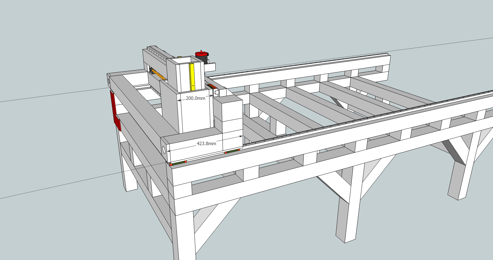

    Guys, i have to start sooner this build as everyday i change my mind.
    Now here is the deal. i have decided to make the machine with working area 1200 x 2500 and at the same time make it fast and rigid. Till now the problem was limited space and problems in moving the machine.
    Now the funny part. I bought yesterday a towbar and am looking to buy a suitable platform trailer, so i will mount directly the machine on the trailer
    I did not want to cut myself short just because i could note move it from home to home. So its decided.
    I will definitely go with the Johnathan design of a gantry just make it suit my needs and abilities. maybe even add one more beam at one side like a standart gantry, as Dean suggested somewhere.
    So here is where i need help:
    When the machine was small it was clear that 1605 screw for the z and 1610 for X and Z.
    Now some options for the gantry:
    1. make it from 2 100x100x4 = whole gantry below 50kg
    2. make it from 3 100x100x3 / 2soldered together/ - 1m=9kg, so whole gantry will be ~ 65 kg
    3. make it from 3 100x100x7 = whole gantry 80-90kg
    -So, the big question is how to move the gantry at 2600mm length?
    -What screws, what motors?
    -Servo maybe ? I know nothing about servo, can you point me to good money wise servo for the long axis?
    -What drive relation 1:1 , 1:2, 1:3
    -unfortunately i can not machine rotating ballnut. Could somebody help me here? any other options?
    So now i am a bit confused between 2 options, make a sturdy beast 1250x1250 or make a sturdy beast 1250x2500 with your help. I mean an exemplary sturdy beast for the generations to come

    If you are going to put this in a trailer you'll need to make sure you add some way so you can jack it up on sturdy legs. If it's resting on the trailer wheels I think the machine will probably shake itself to bits.
  9. #19
    Quote Originally Posted by Wobblycogs View Post
    I agree with you. i will take off the wheels and hard mount the trailer to the floor, and the machine will be hard mounted on the trailer. The trailer idea is to use it only when i change rented houses. Will not drive it around

    Hi there. Almost finishing my design.
    Basically i decided to go Big.
    I designed quite an unusual gantry and Z with the main idea of eliminating as much overhang as possible, light as possible and easy to build as possible.
    Another thing is that affected by Jonathan's build i could not help but contemplate an extreme machine with 3rd gantry beam. See picture 6. I believe Jazz sugested something similar, if i am not wrong.
    The gantry would be driven by rotating nuts/2510 ball screw/ if Jonathan or somebody is kind enough to make them for me, i know free time is an issue there.
    The gantry design as tested by me will have less than 0.01 flex and bend /twist/ and will weight 2 beams -40kg +Z weight or 55kg+Z weight if triple.
    For the moment i am very inclined to invest in the Leadshine hybrid 220V AC drives, though maybe i will start with Geckos as i have them. Depends what would cost me for rails and ballscrews for 1250x2500. Still have not decided. But if i make it only 1250x1250, definetly the 3 beam design and the AC drives.
    What worries me most is the bed, as i dont have money for 20mmm alu bed. I am contemplating how to make a strong cheap bed with strong channels.
    Now please tell me what do you think? My main idea is to build something exceptional if possible, cheap as possible where possible , and as simple as possible, so when i share the plans it could easily be repeated by other people.
    PS. The Z design is just a sketch, is not finished, will be lightened and i will try to move the ball screw further to the center without messing with the spindle. Another point is that now the plan is for 100mm diameter spindle, as i assume most people would choose for such a machine.
