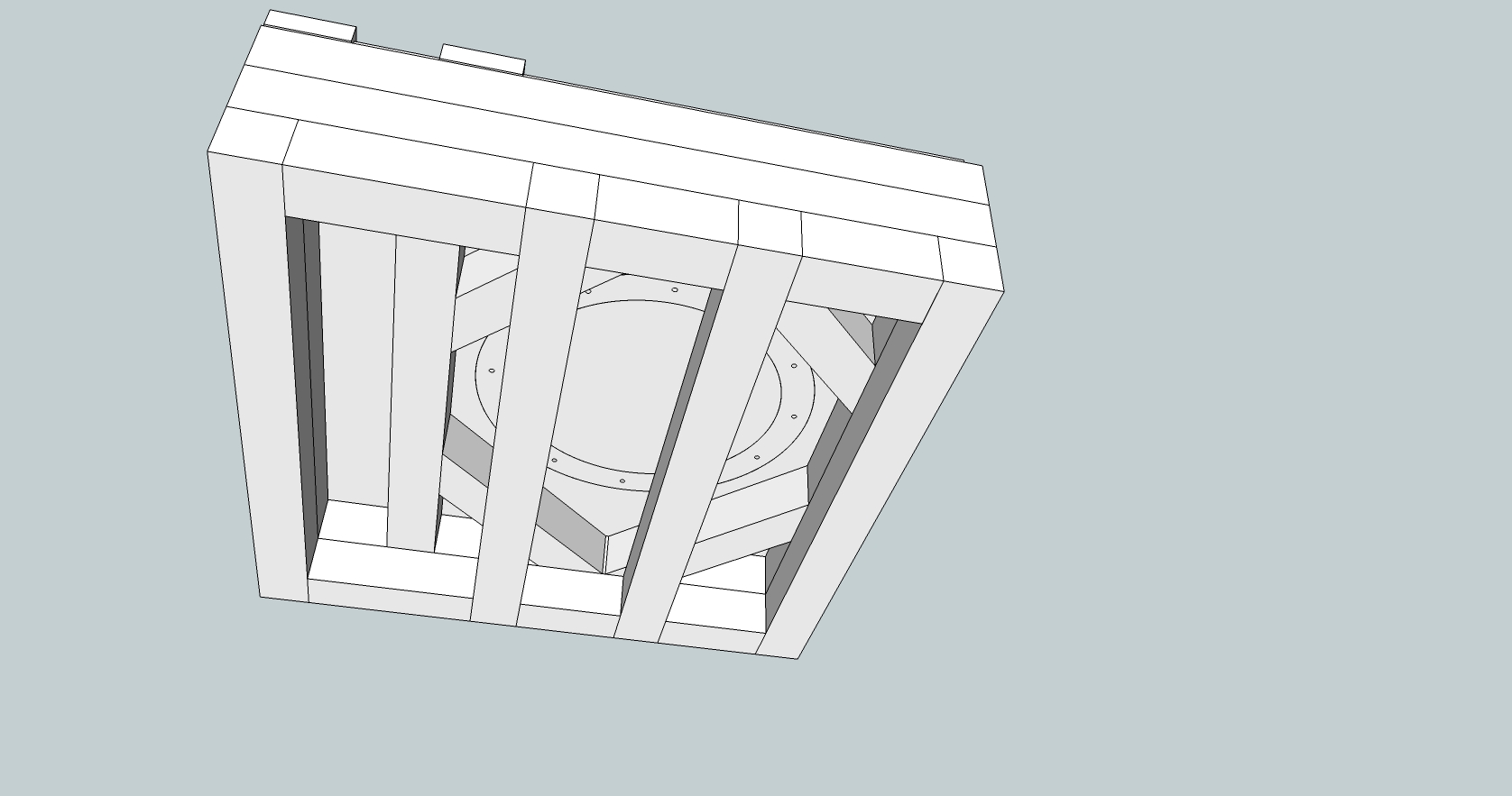

    Now the rings are meant to be integrated in the table bed. I mean the sheet would be bolted around round hole in the table bed with 12x M10 screws.

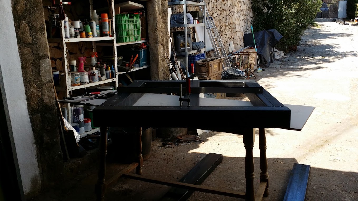

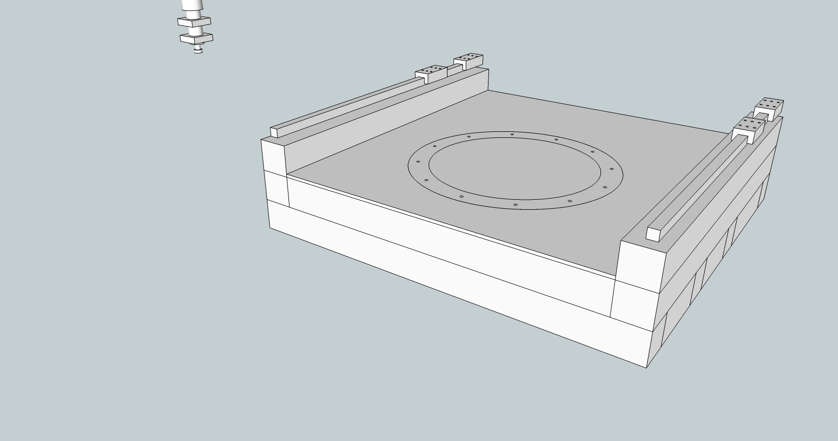

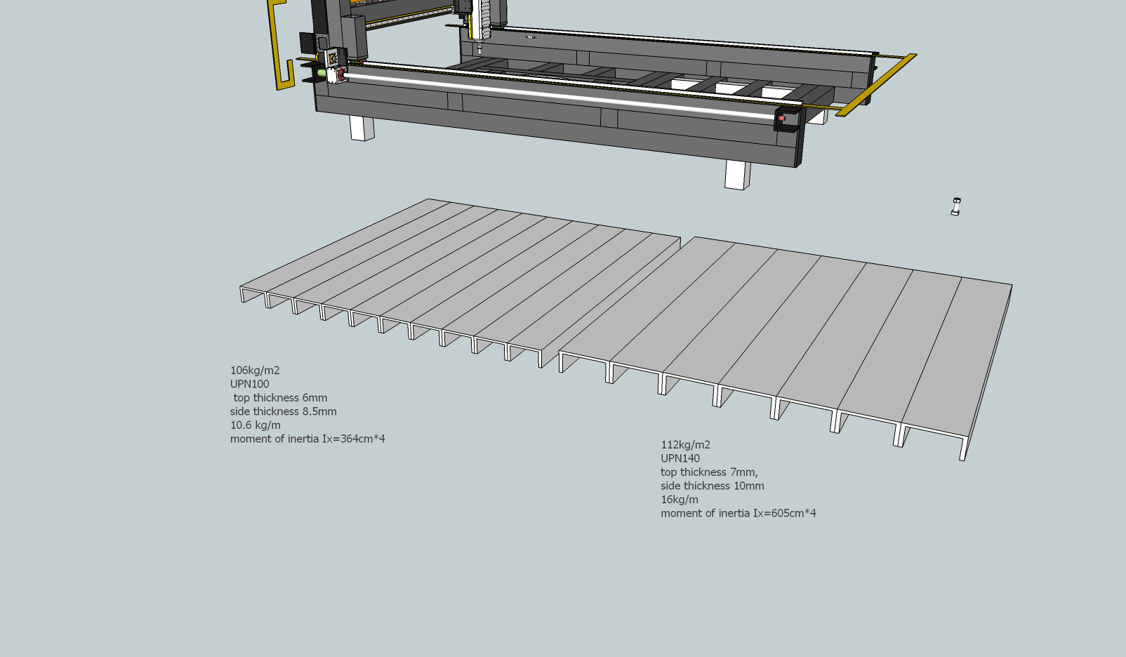

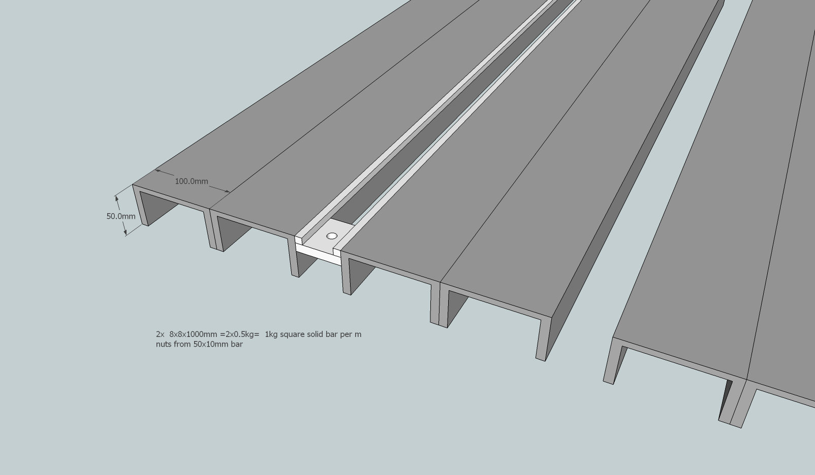

    The basic idea for the table bed made from 100x100 steel profile:

    Other than the obvious fact it will need to be strongly built then I don't think it will be difficult make this work with but from what I see for it to work properly then you need the tool 90deg to the steel has it domes.? Affectively you need 5 Axis. . . . This would rule out Z axis like Jonathan's box design.
    My approach for dual purpose machine would be to build a Sturdy gantry with something like 200x100x10. Then either have two separate Y axis one on each side each with own rails, screws, motors and Z axis or build a single double sided Y axis with Z axis on each side. My preference would probably be shared has it keeps cost and weight of gantry down but I would have rails on both sides.
    Then the Rear Y axis would have heavy duty Z axis with short stroke and attached to that would be a stepper driven Rotary table which striker mounts onto creating the 4th axis. This would enable you to keep the striker 90deg to metal at any dome depth.
    Next To hold the Metal and create the 5th Axis I would build a sturdy fixture on a Rotating table driven by stepper. Few ways this could done.? Either using standard rotary table driven by stepper and bolting Sturdy metal holding fixture onto it. . . .OR. . . . Make a Diy rotary table from an Old car or truck clutch Fly wheel and plates and bearings. Base plate would have bearing attached to it on it's perimeter and the fly wheel would sit on them and rotate on central spindle. It would be driven by stepper directly from the fly wheel ring gear. . . . . This table assembly would be removable from the main bed.
    Now strictly speaking this wouldn't be 5 Axis has you'll only ever be using 3 Axis at same time. So you could make so it shares the same drives and just swap motor connections or fit Switching system to swap over. (would need powering down drives first)
    It would go like this.!! . . Locate tool on centre of metal disc and park gantry and Y axis. These would now not move again so can unplug or switch to drive both rotary tables. Then swap or switch over front Z axis to rear Z axis.
    Should be some Food for thought there.??

    So Dean, my Big questions are:
    Will Hiwin RGH 30 HA stand up to the task?
    Will ballscrews with 2 nuts each stand up to the task and especially on Z, where additional vibrational creep has to be dealt with? Z with 2 ballscrews and 4 nuts should stand , yes? Ok, not forever, but at least for a time.
    What size ballscrews on each axis? the normal speedy ones? 1605 and 1610 respectively?

    But i don't understand in fact- what will i gain with the 4 rails on the gantry and 2 Z axis ? If i go with heavy duty preloaded roller guides i could use them at the same time for CNC and the impact hammer. if they f"""k i will just change them. or you mean to be able to do 2 things without swapping spindle with hammer? if just for avoiding swapping, then an over-sized Y could do the same job and park one of the Z out of the way.
    Yes was just to avoid swapping but if you have room for extra wide Y axis that would work OK
    Yes easily. 30mm bearings are massive things and can handle large loads.
    What size ballscrews on each axis? the normal speedy ones? 1605 and 1610 respectively?[/QUOTE]
    Don't think 2 nuts would matter or help in this instance has reducing backlash isn't required.
    Regards Z axis then Obviously two screws will take more punishment than one but single screw would just means changing sooner and less complicated.!
    Yes standard screw pitch and either 16 or 20mm should be fine.
