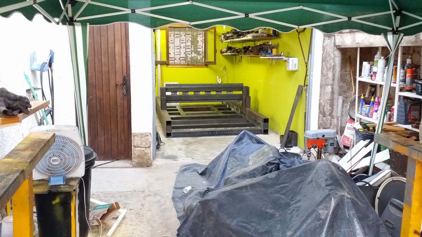

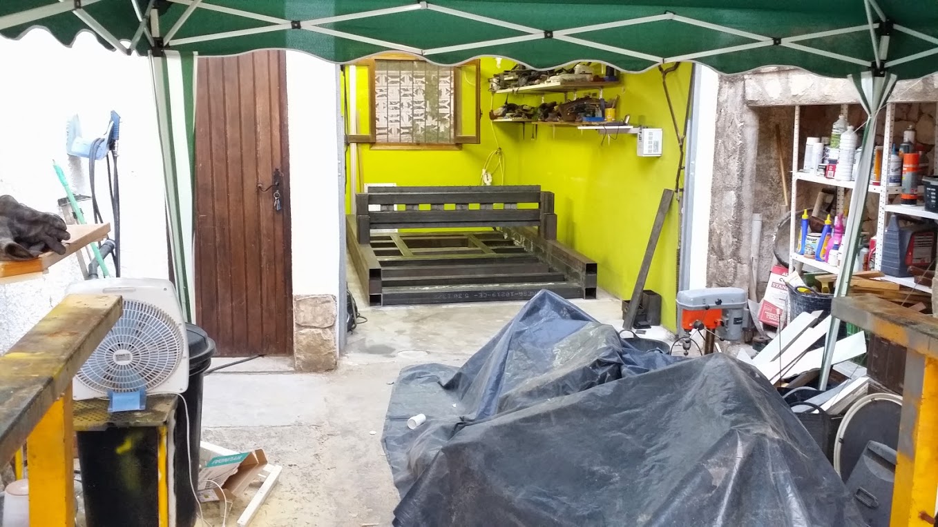

  10. #70

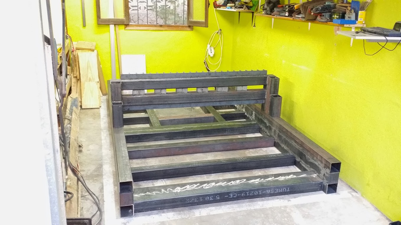

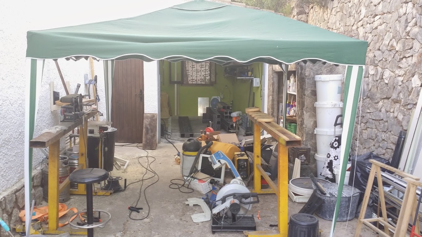

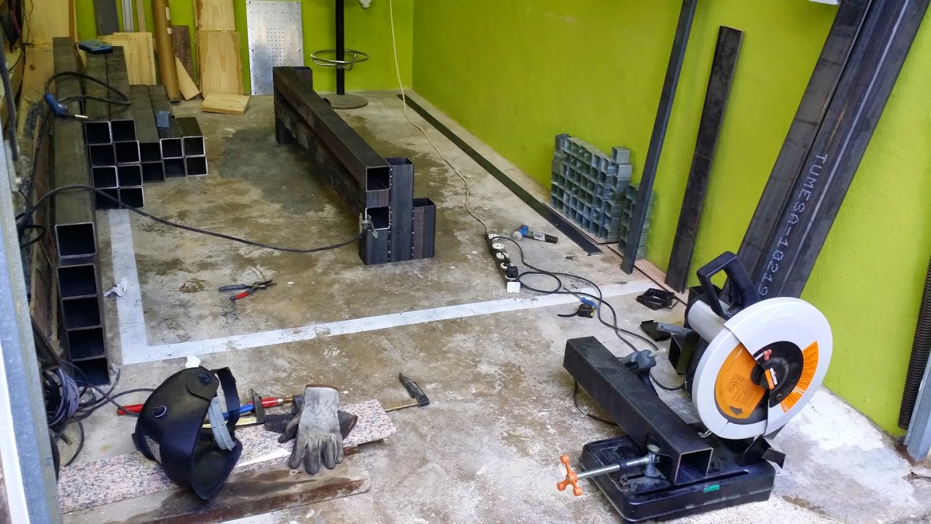

    Some updates. 2 very hot weeks, especially if you are working alone in 70% humidity, 40C temperature and soldering all day long +weekends and moving heavy stuff.

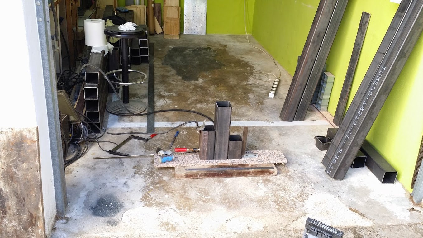

    Had to clean all stuff from the garage. Draw white lines for the footprint. This machine will take a lot of space. Of course it rained right after i took everything out, did i tell you it hadn't rained like 11 months.
    Started with the gantry. decided to keep sides square, so later could flip and support easier the gantry. Do you see the blotch further on the floor. Guess what, just before starting all my boxes with paint fell on the floor and some spilled. A little diversion :-)

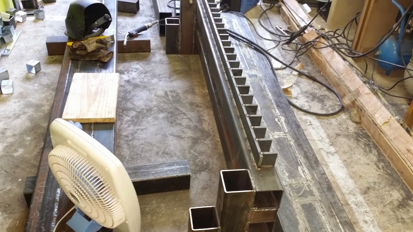

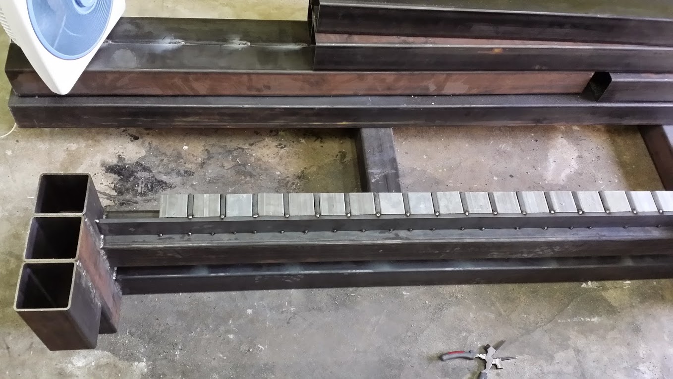

    I have mixed feelings about the Evolution saw. While the motor and blade is great/made in japan/ the saw is very very flimsy. Next project will be to throw away the base and do a new one. I wish i have bought the Makita. It was 100eur more expensive and don't come with blade- another 100, so thats why. Anyway, an essential machine for the project.

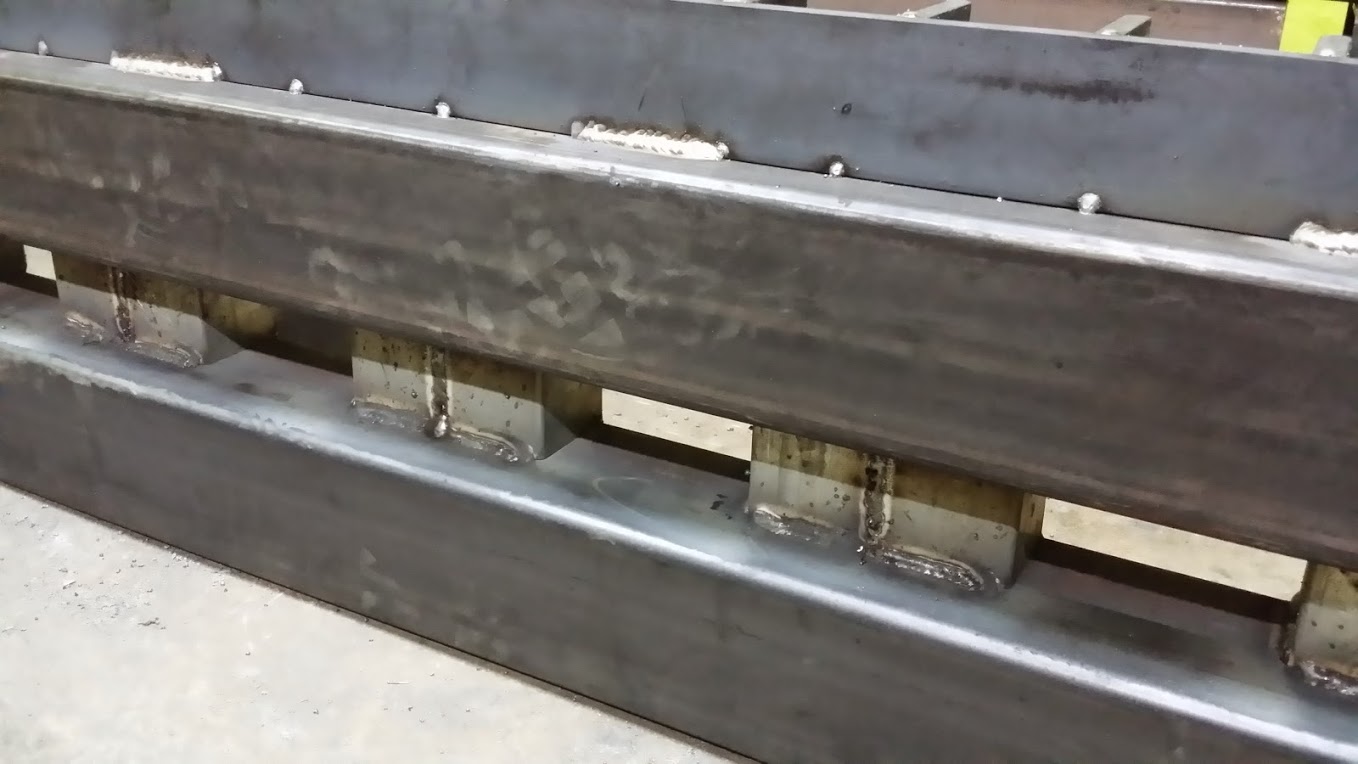

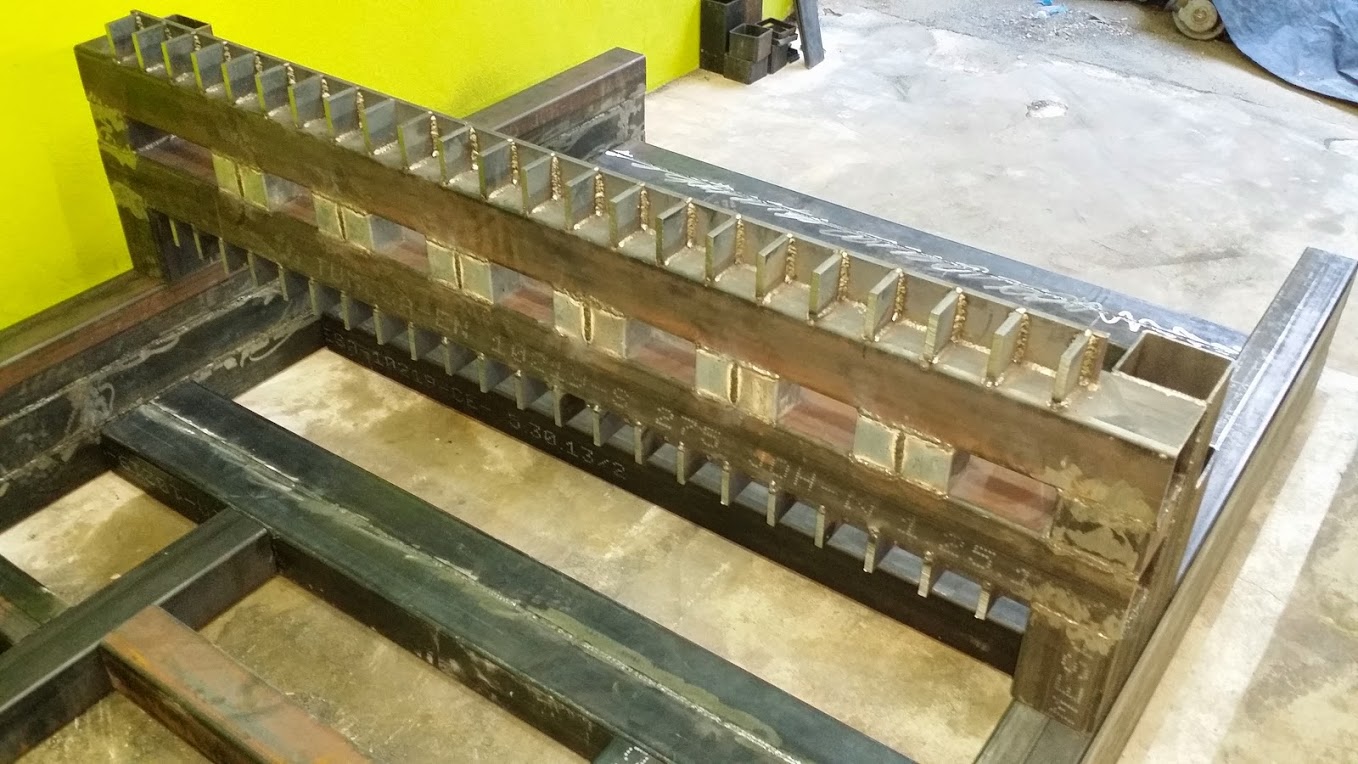

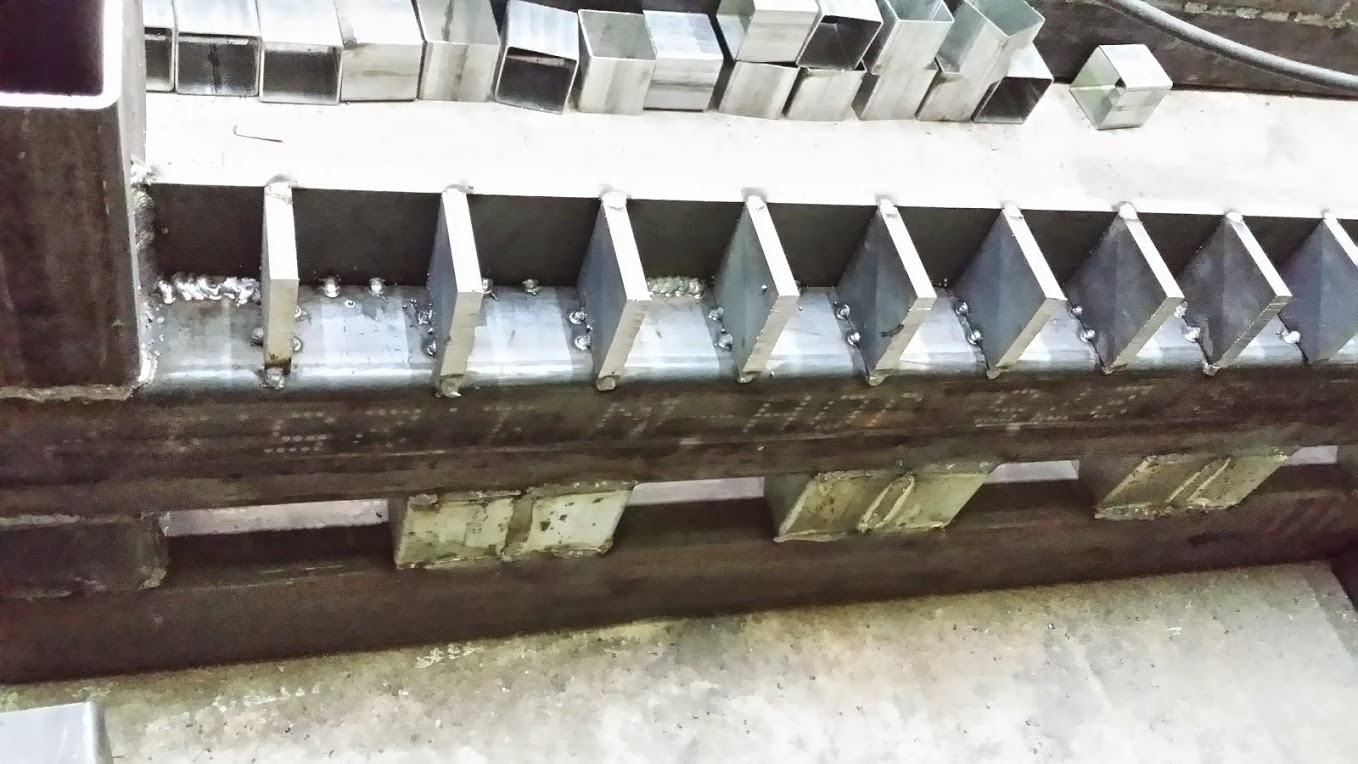

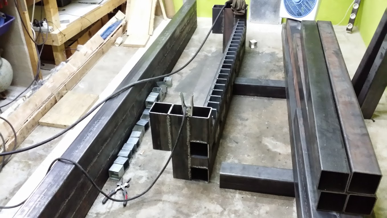

    Ventilator to cool myself and change of plans. The 60x60 profiles cut to size that were meant to support the rails were discarded. There was no way i can solder them from all sides. Instead i cut all of the 60x10 plate/6m in total/ and decided to separate them by the 60mm using at least the profiles i have already cut. Some carefull soldering from here and there. Very rigid result.

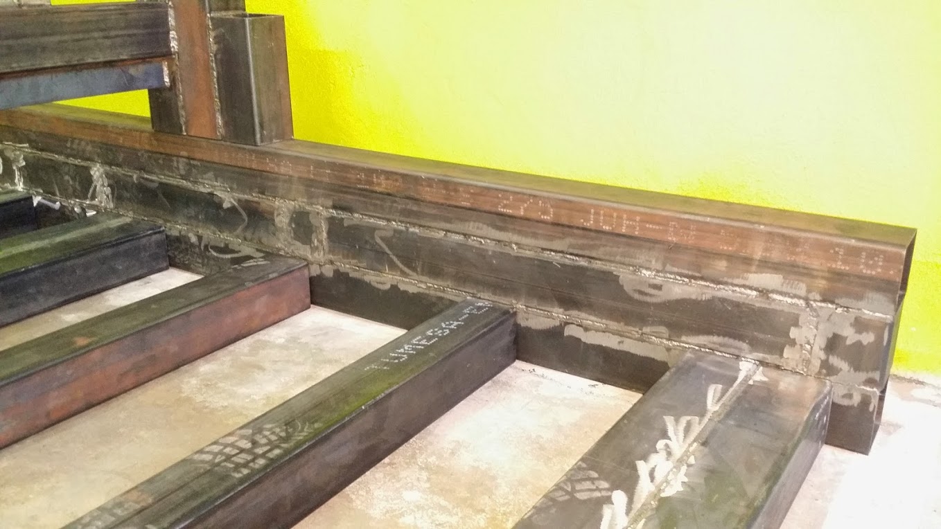

    As you see from the pictures above everything is soldered till the end. Now there was another momentary decision. No legs for now untill i decide something clever and the steel from the legs went just inside the sides of the machine. So stair like sides with no holes, there lie the rests of the profiles meant for legs.
    I cant explain how strong that machine frame feels. Including that bestial gantry. Vertical bend or twist- i did not even bother to measure it with the indicator. Its solid as a rock. starts to look like a Frankenstein thing from movie.
    So today i finished working at 20.30 and couldn't help but move all elements with last available effort, as i wanted to see how it would look. I am a strong man, no lift or whatever help, so i am becoming stronger moving all day these pieces around while soldering. Did i tell you that all the soldered pieces weight around 500kg .
    So here is my baby. Its huge. I am a bit surprised how big that is. Still has no name but i think it would be something military:
