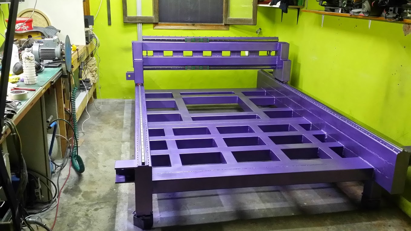

    Some updates. I a bit ashamed it goes so slow but in between other work, orders of stuff i do and working alone on the machine, it takes too long.
    This is what you are up to, if you don't have straight edge. 3m rail. you move it left right from one end and from the center onward it stays in place. Not so bendy when short lengths but look at that...
    https://plus.google.com/111571569713...ts/P5Gu6PjqftB
    A very lazy helper
    This is what the empty epoxy bottles weight, in case you wonder or you loose power when measuring:

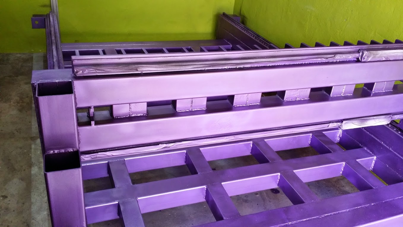

    The key to epoxy leveling the gantry rails, squaring the gantry and other was to leave the plates that mount on the gantry bearings/the leg sides/ longer 10mm at the back side. Z plate was mounted, ball screw and then rails were squared, just to make sure all would fit.
    I was impatient here, so i did all this alone. Moving the gantry up and down i mean. Starting to feel that i am training heavy lifting. Then gantry was mounted and squared again. gantry rails were checked for squareness against the long rails. Success.
    project 1 , 2, Dust Shoe ...
  4. #144
    My "favorite" part - painting.
    It took one day to clean the machine. One day to paint it 3 colors using what i had of paints meant directly over steel or oxide. A day to dry/it was cold. One day for second hand of these-white, silver and black. White looked best. One day to dry and then started the real paint.
    Violet metallic, who would have guessed what color i would choose. Why that color? It needed to be different cause the machine deserves it /money, effort, result/. So i looked and i looked... And by the way i have got new Oakley Violet Iridium sun glasses a week before . So i decided i would look cool beside it and chose the color to be the same. Crazy, yeah?

    Thanks!
    Oakley Style Switch, standard fit, clear frame,Violet Iridium/+spare black iridium/ OO9194-03. Possibly the only present i made to myself at least like from half an year ago. All else went in the machine or paying bills
