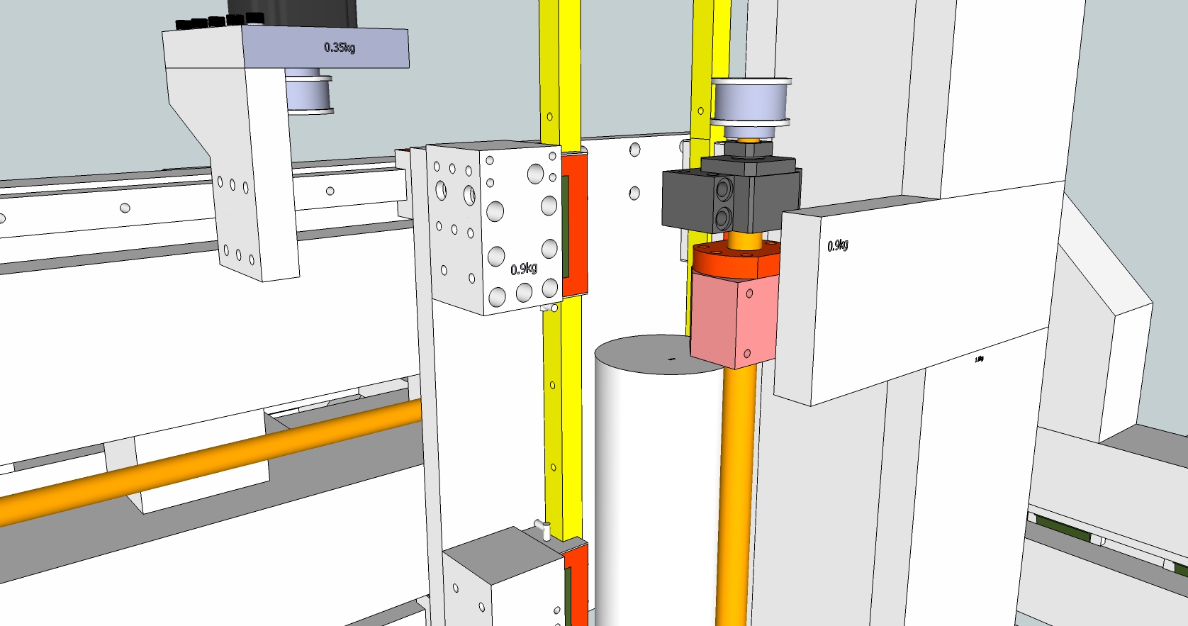

    Now back to reality. I need some help here please! With motor calculations. I read numerous threads here and at the zone, have done numerous calculations as far as i could but will shamelessly ask here again as i am stuck.Almost finished the drawings. The Z looks quite nice and now i am sure its possible, though some blocks will look like cheese due to the ridiculous hole placement
    I though i had everything clear until yesterday i calculated the weights.
    The Z weights 32kg and the gantry in total 120kg
    Part of the problem lies that i don't know what exactly i want as till now i have experience only with small weak machines.
    1. I would like the gantry and the Z to be rigid as they are in the drawings
    2. I would like the machine to be in the middle between resolution and speed. What i am not sure is what speeds i want/not rapids-cutting speed/. I will cut wood and aluminum on that machine. I chose 1610 to move the z left right and 2510 screw to move the gantry. I thought of 1:1, now i am thinking of 2:1, otherwise not only i am jumping in the so called "servo territory" but will have to jump in the "expensive big servo territory"
    I have decided on the 3kw spindle. I am not sure but i believe i will be happy with sturdy heavy machine that could do 250IPM /6350mm per min/- cutting in wood at good if not full cutter depth. The weight should help with the depth and i assume with the aluminum finish. Aluminum i will be happy if i do it at flute diameter depth. It seems the machine will be sturdy enough for this, having in mind the very extremely low overhang with my design, enclosed frame spoindle and strong gantry +the quantity of bearings.

    Now the question is:
    -do i make my machine smaller / which i would not like much, cause the money will be almost the same and missing eventual job on the long run could be very undesirable/
    or
    Keep it like this and figure how to drive it.
    So definitely i need some help in this mess in order to evaluate options and make no mistake here.
    The servos i am looking at are these: my friend Fred's BST store
    He seems to have the lowest priced servos and drivers around and as i will buy the rails and screws from him, seems quite logical choice
    Questions:
    having in mind that i don't want to compromise one axis due to small savings of $ and ruin the integrity of the machine. Obviously on the long axis i will go with servos. And here BST store llloking at the prices of servos i am almost ready to fit servos on all axis, as they are almost the price of the Leadshine closed loops
    1. The Z weight will stay the same. 10kg spindle + some aluminum, there is nothing more to do except lower the weight about 5-6kg which i believe is not worth it . That is clear. RM1605 screw . Should i stay with 3Nm leadshine Nema 23 closed loop motor 1:1, change the relation 2:1, or upgrade the motor to servo?
    If servo, what reduction and how big the servo motor?
    2. Z weight again same. RM1610 screw. Should i stay with 3Nm leadshine Nema 23 closed loop motor 1:1, change the relation 2:1, or upgrade the motor to servo? If servo, what reduction and how big the servo motor?
    3. Gantry 120kg , 2510, rotating ball nut both sides.
    options i see:

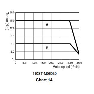

    - drive it with 2 servo motors, one each side. I am lost what power i need here. According to what i calculated if i am not mistaken could go with 2x 6N.M 1.8KW 3000RPM 110ST AC Servo Motor 110ST-M06030 + Matched Servo Driver / 310euro each . i am not sure though if the reduction here should be 2:1? Or if with 2:1 reduction i could go with smaller servos like the 4N.M 1.2KW 3000RPM 110ST AC Servo Motor 110ST-M04030 + Matched Servo Driver, where the price is 304euro, so as you see there is almost no price difference .
    -drive it with 1 big motor and 25mm belt which i am almost sure i can fit to pass through the gantry beam
    for a motor i believe the 130ST-M10025 servo motor and servo driver system 2.6KW 10Nm 2500rpm 10A / 375 euro/ would be ok. Again not sure if the ratio should be 2:1 as i assume.
    4. Or i stay with closed loop steppers, but they arent cheap, i almost decided on servos.
    5. I can not find what size in Nema are these servo motors so i could continue with the drawings, in fact no info on these cheap servos
