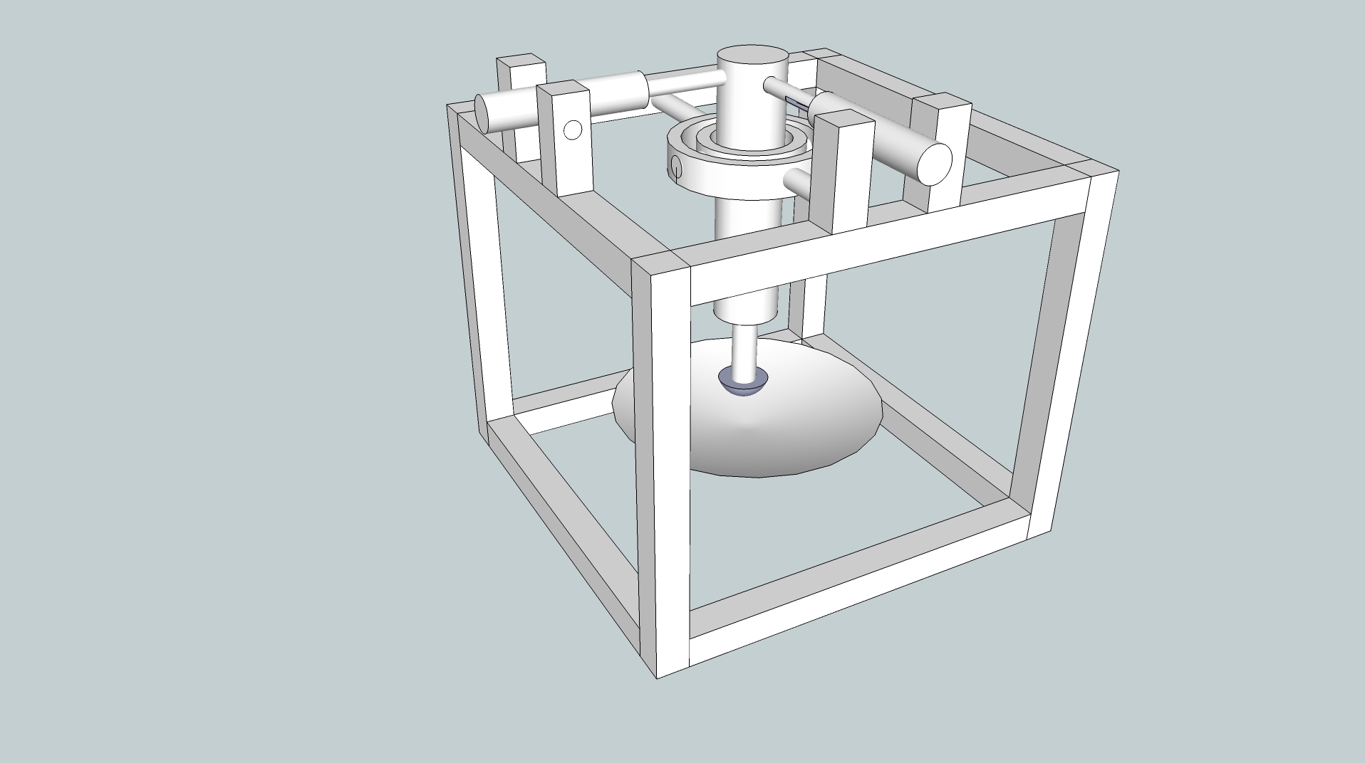

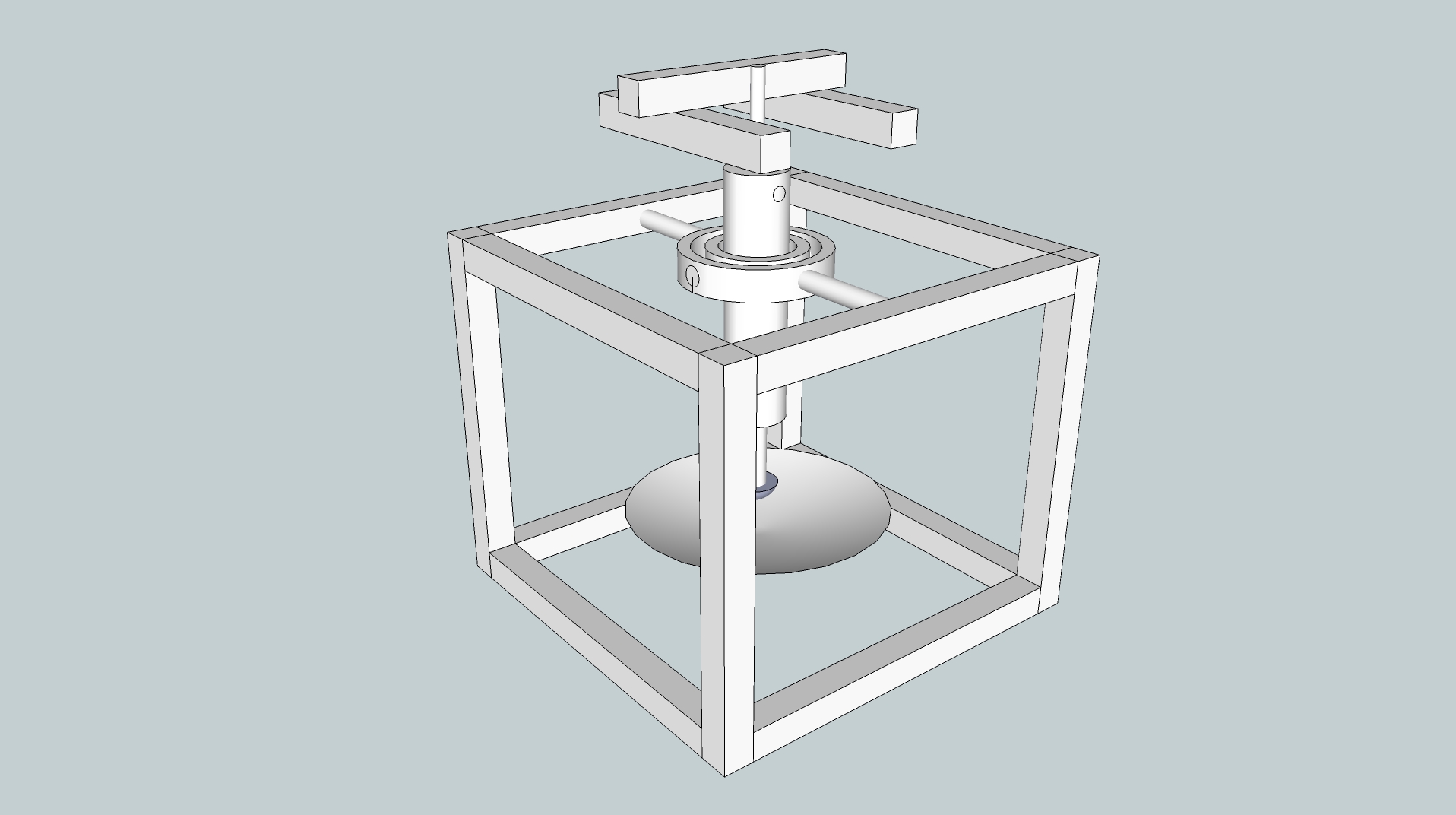

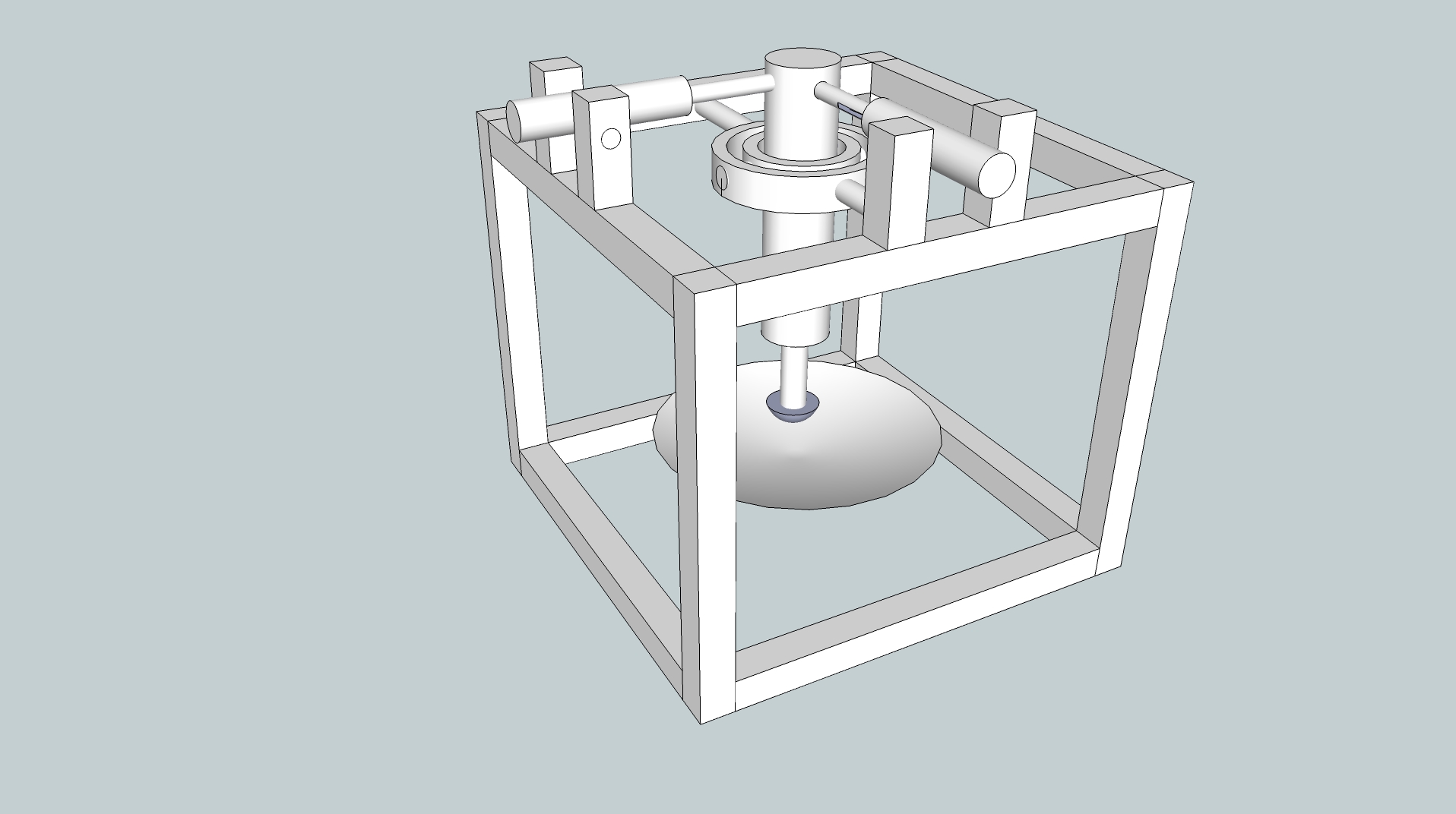

    The hammer is now mounted on a gimbal and can be made to work in a circular motion by moving the X and Y axes.
    No need for a rotating base so it can be made cheap and strong.
    Mach3 can operate the X and Y axes.

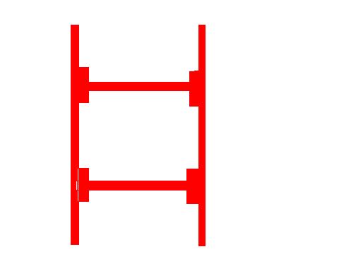

    OR easier
    A small X Y gantry mounted on top moves the end of the hammer so 50mm there would be maybe 300mm at the other end of the hammer.
    Then Mach3 could be used in the normal way where you would use a 2D software to draw a reduced size pan with the required toolpaths.
    A pneumatic proportional valve working on 0-10v (like a VFD) could be used to control air pressure to the hammer using M codes e,g, M3 to turn on the air
    then for example S500 would tell the valve to deliver 5Bar, S200 = 2Bar , etc.
    So the S codes could be put in the G code as required to change the hammer power.

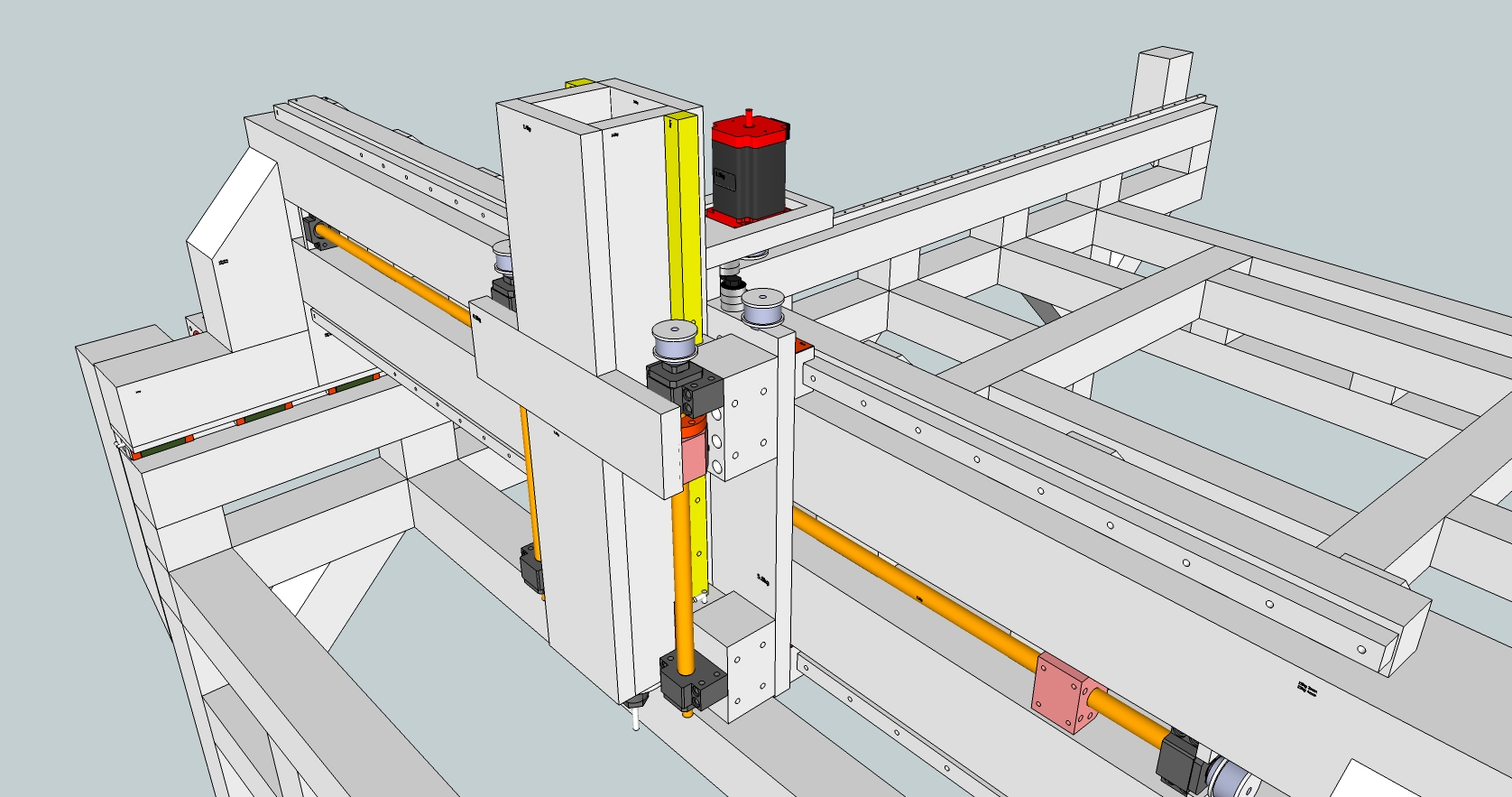

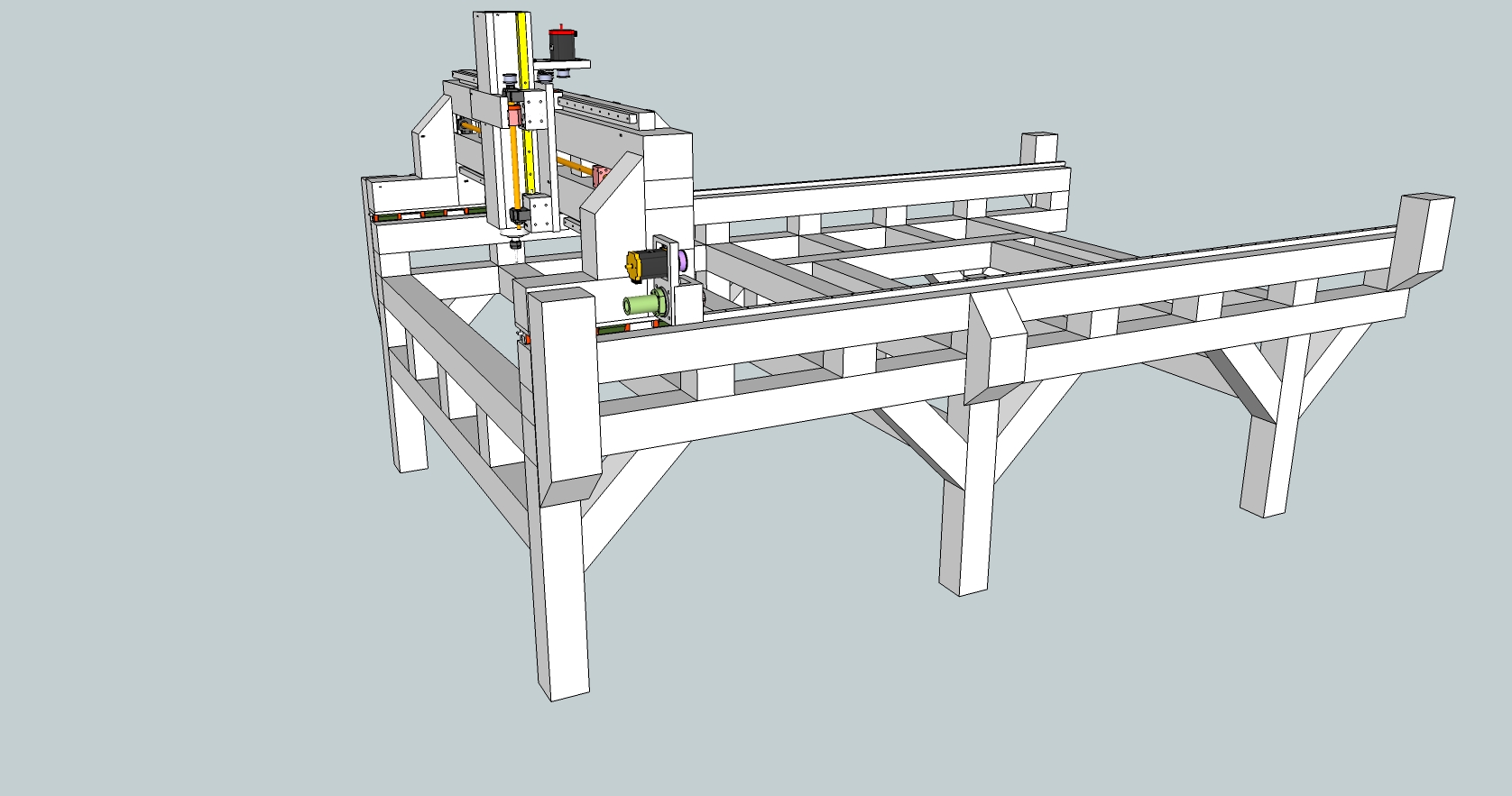

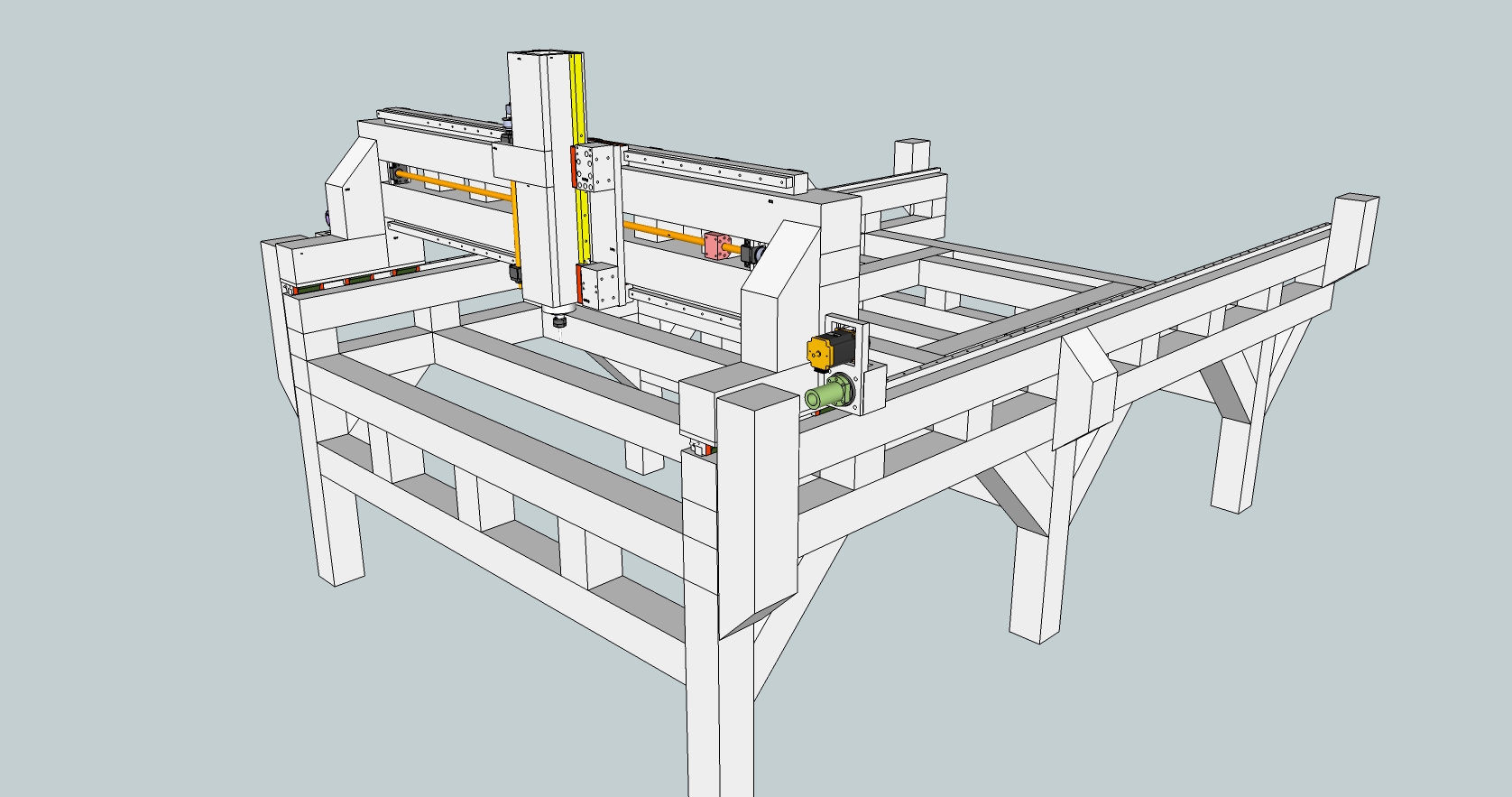

    Now back to reality. I need some help here please! With motor calculations. I read numerous threads here and at the zone, have done numerous calculations as far as i could but will shamelessly ask here again as i am stuck.Almost finished the drawings. The Z looks quite nice and now i am sure its possible, though some blocks will look like cheese due to the ridiculous hole placement
    I though i had everything clear until yesterday i calculated the weights.
    The Z weights 32kg and the gantry in total 120kg
    Part of the problem lies that i don't know what exactly i want as till now i have experience only with small weak machines.
    1. I would like the gantry and the Z to be rigid as they are in the drawings
    2. I would like the machine to be in the middle between resolution and speed. What i am not sure is what speeds i want/not rapids-cutting speed/. I will cut wood and aluminum on that machine. I chose 1610 to move the z left right and 2510 screw to move the gantry. I thought of 1:1, now i am thinking of 2:1, otherwise not only i am jumping in the so called "servo territory" but will have to jump in the "expensive big servo territory"
    I have decided on the 3kw spindle. I am not sure but i believe i will be happy with sturdy heavy machine that could do 250IPM /6350mm per min/- cutting in wood at good if not full cutter depth. The weight should help with the depth and i assume with the aluminum finish. Aluminum i will be happy if i do it at flute diameter depth. It seems the machine will be sturdy enough for this, having in mind the very extremely low overhang with my design, enclosed frame spoindle and strong gantry +the quantity of bearings.
    3. I thought of driving the Z with hybrid closed loop Leadshine Nema 23 3Nm, same the Z left right and 2x the same that move the gantry.
    That was when i did not know about the actual weight.
    Now the question is:
    -do i make my machine smaller / which i would not like much, cause the money will be almost the same and missing eventual job on the long run could be very undesirable/
    or
    Keep it like this and figure how to drive it.
    So definitely i need some help in this mess in order to evaluate options and make no mistake here.

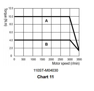

    The servos i am looking at are these: my friend Fred's BST store
    He seems to have the lowest priced servos and drivers around and as i will buy the rails and screws from him, seems quite logical choice
    Questions:
    having in mind that i don't want to compromise one axis due to small savings of $ and ruin the integrity of the machine. Obviously on the long axis i will go with servos. And here BST store llloking at the prices of servos i am almost ready to fit servos on all axis, as they are almost the price of the Leadshine closed loops
    1. The Z weight will stay the same. 10kg spindle + some aluminum, there is nothing more to do except lower the weight about 5-6kg which i believe is not worth it . That is clear. RM1605 screw . Should i stay with 3Nm leadshine Nema 23 closed loop motor 1:1, change the relation 2:1, or upgrade the motor to servo?
    If servo, what reduction and how big the servo motor?
    2. Z weight again same. RM1610 screw. Should i stay with 3Nm leadshine Nema 23 closed loop motor 1:1, change the relation 2:1, or upgrade the motor to servo? If servo, what reduction and how big the servo motor?
    3. Gantry 120kg , 2510, rotating ball nut both sides.
    options i see:
    - drive it with 2 servo motors, one each side. I am lost what power i need here. According to what i calculated if i am not mistaken could go with 2x 6N.M 1.8KW 3000RPM 110ST AC Servo Motor 110ST-M06030 + Matched Servo Driver / 310euro each . i am not sure though if the reduction here should be 2:1? Or if with 2:1 reduction i could go with smaller servos like the 4N.M 1.2KW 3000RPM 110ST AC Servo Motor 110ST-M04030 + Matched Servo Driver, where the price is 304euro, so as you see there is almost no price difference .
    -drive it with 1 big motor and 25mm belt which i am almost sure i can fit to pass through the gantry beam

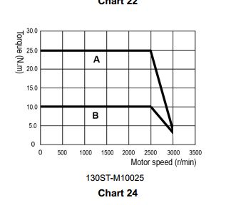

    for a motor i believe the 130ST-M10025 servo motor and servo driver system 2.6KW 10Nm 2500rpm 10A / 375 euro/ would be ok. Again not sure if the ratio should be 2:1 as i assume.
    4. Or i stay with closed loop steppers, but they arent cheap, i almost decided on servos.
    5. I can not find what size in Nema are these servo motors so i could continue with the drawings, in fact no info on these cheap servos
    PS. Found the documents at last for the servos PDF specs
    it seems they are Xinje Servo drives and motors here PDF for the drives

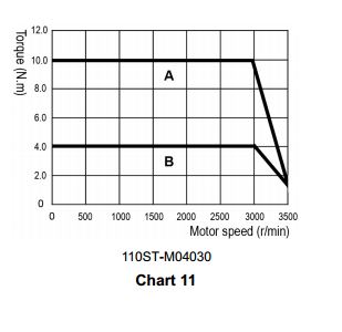

Name:	4N.M 1.2KW 3000RPM 110ST AC Servo Motor 110ST-M04030.JPG
ID:	11053Click image for larger version.
Name:	6N.M 1.8KW 3000RPM 110ST AC Servo Motor 110ST-M06030.JPG
ID:	11054Click image for larger version.

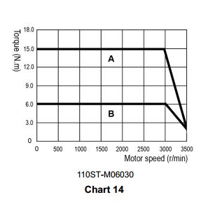

Name:	130ST-M10025 servo motor and servo driver system 2.6KW 10Nm 2500rpm 10A with cable.JPG

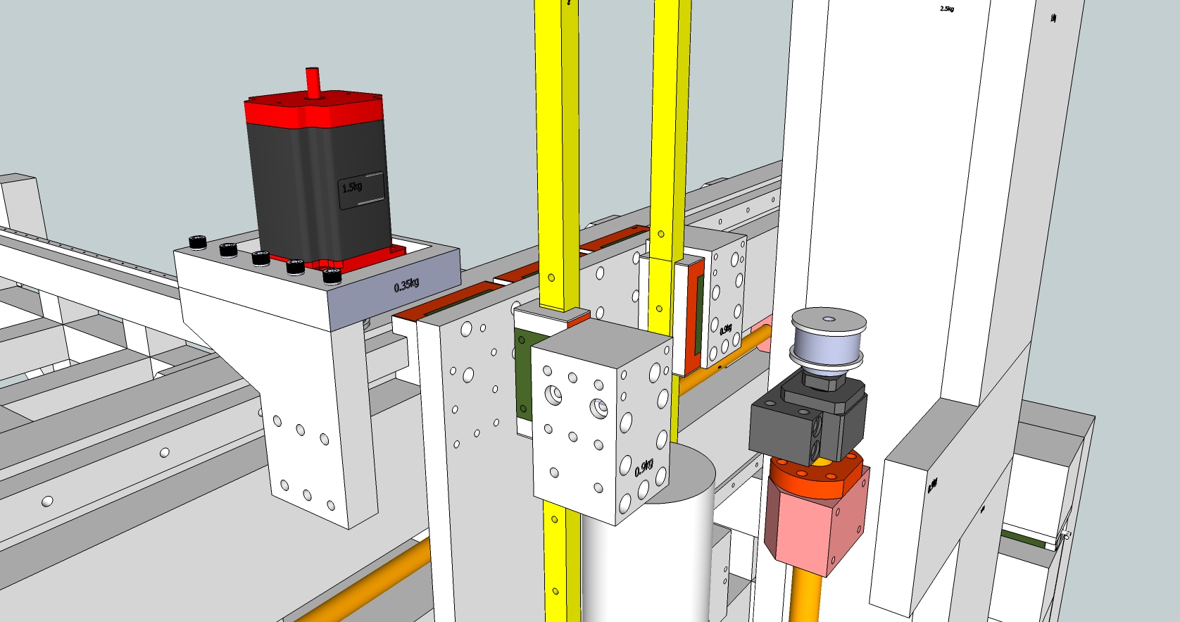

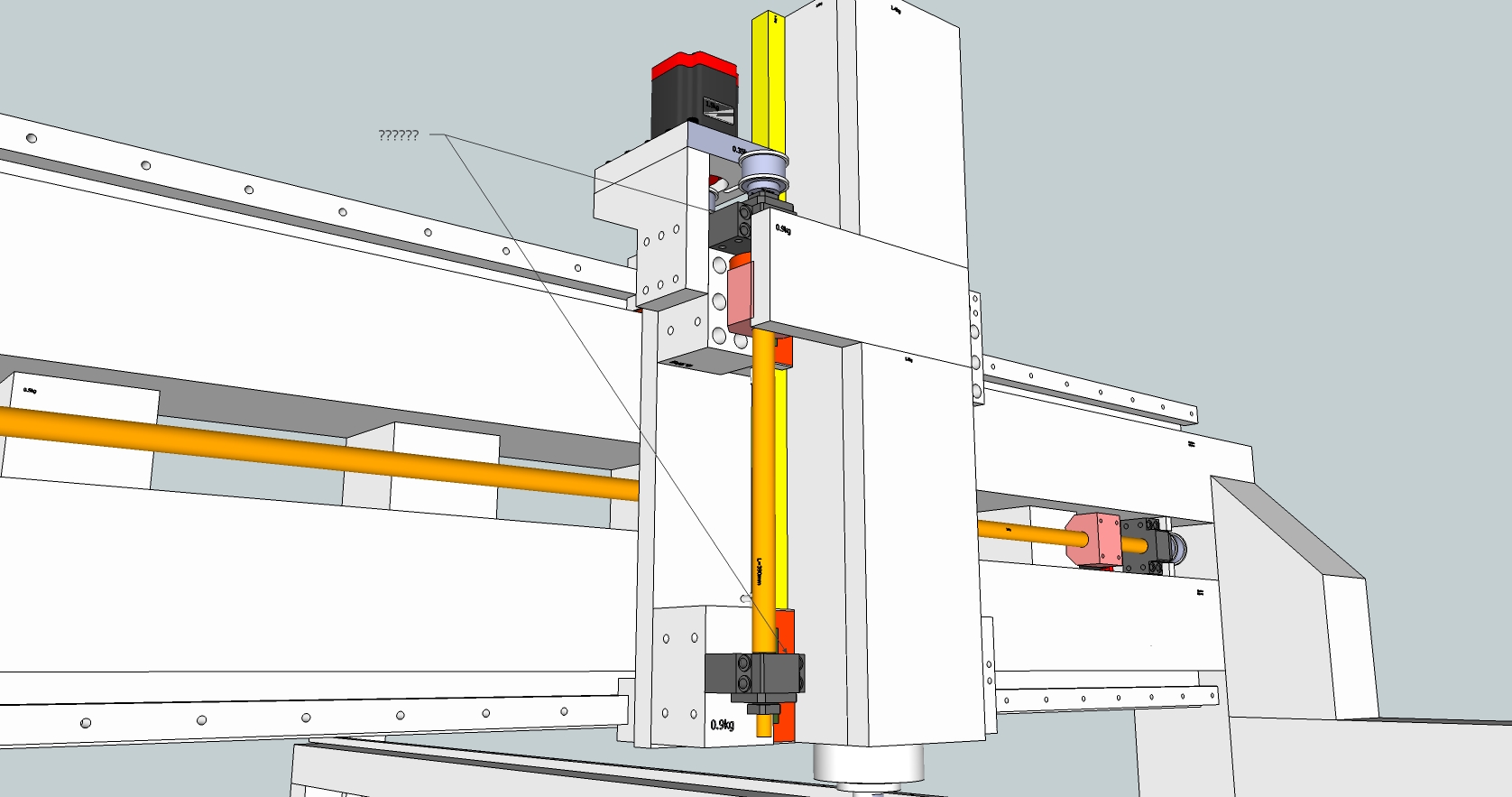

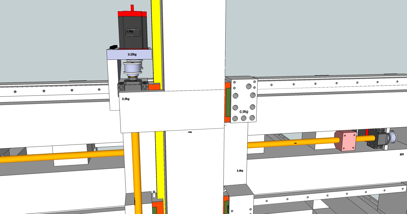

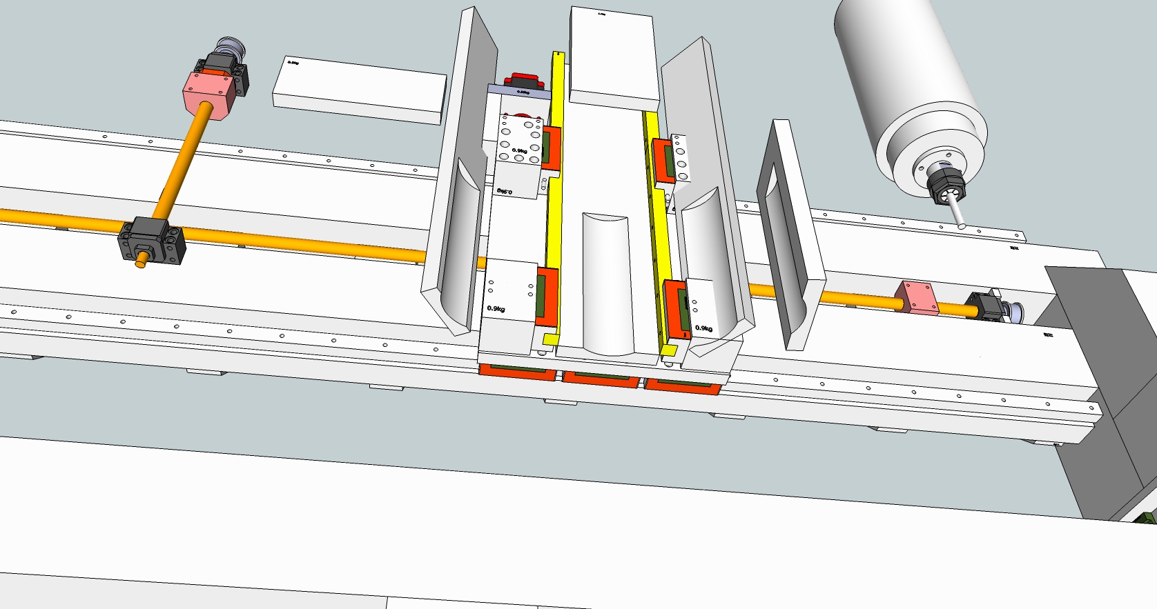

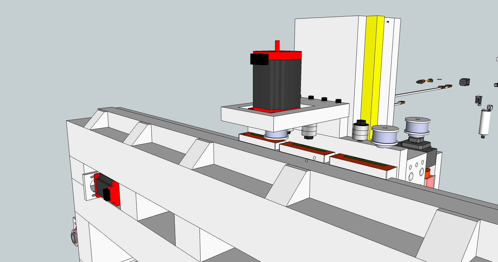

    here are some updated cheese drawings:
ID:	11047Click image for larger version.
ID:	11048Click image for larger version.
ID:	11049Click image for larger version.
ID:	11050Click image for larger version.
ID:	11051Click image for larger version.
    Last edited by Boyan Silyavski; 20-12-2013 at 12:48 PM. Reason: found servo motors and drives pdf
  3. #33

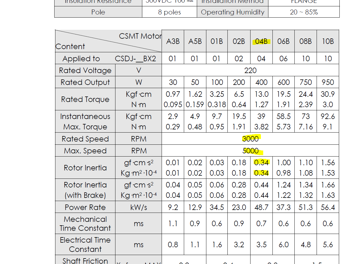

    Answers to questions:
    1) Ballscrews give a very large mechanical advantage. You do not need to worry about the weight of the Z-axis so much. See here. You'll be fine with a generic 3Nm motor and 70V stepper driver. The closed loop ones are a good concept, but cost a huge amount more for little gain.
    2) Don't use RM1610 - it doesn't gain anything.
    3) I wouldn't go with the long belt idea, especially when using servos as servos work best when they are rigidly coupled to the load - i.e. without a long stretchy belt.
    You may well be fine with two stepper motors - have you tried putting the values in this spreadsheet?
    If using one servo, the formula you need is this:
    Je=M*(L/(2*pi))^2
    Je is the equivalent inertia, L is the pitch of the screw (so 0.005m with 1:2 ratio) and M is the mass of the gantry.
    Next find the inertia of the servo motor rotor (Jr), e.g. it says in the datasheet for 110ST-M04030 is 7.61kg-cm^2. You then need to find what 'inertia ratio' the motors will tolerate - typically it might be Je/Jr<5. So just use the above formula to calculate Je, divide it by Jr (7.61kg-cm^2) and if the result is less than 5 the motor is probably suitable.
    e.g, M=120kg, L=0.5cm (1:2 ratio):
    Je=120*(0.5/(2*pi))^2=0.76kg-cm^2
    Je/Jr=0.76/7.61=0.1.
    0.1 is much less than 5... so that servo is plenty big enough. Another way to look at it is rearrange the formula to find the mass a particular servo will drive, e.g:
    M=Je/(L/(2*pi))^2
    Je=Jr*5=7.61*5=38.05
    M=38.05/(0.5/(2*pi))^2=6000kg(!)
    Or if the ratio is 1:1, that's
    M=38.05/(1/(2*pi))^2=1500kg
    (So note the quadratic relationship - if you double the ratio the drive-able mass goes down by a factor of 4)
    The rated speed of that motor is 3000rpm, so the gantry would go at 3000*0.01=30m/min with 1:1. You need to check the Je/Jr ratio - Je=Jr gets the most efficient energy transfer, but the drives do tolerate a mismatch so you need to find how much, as going with them equal generally results in an oversize motor. You should also include the inertia of the pulleys in the system - just work out their inertia (assuming cylinders is near enough) and add them to the Je value, remembering to take into account the drive ratio.
    Either way, you can see that that servo is far bigger than you need... so I suggest you put the formulas in a spreadsheet and find which motor is best. Also try the stepper motor spreadsheet I linked to earlier, as I expect you'll find that there are suitable stepper motors available.
    4) If you use stepper motors, and select the correct size motors, then they wont stall unless you crash the machine. The only time the closed loop servos help therefore, is if the machine crashes. For the same amount of money as the closed loop stepper you could get a much higher torque standard stepper motor and be certain that it wont stall.

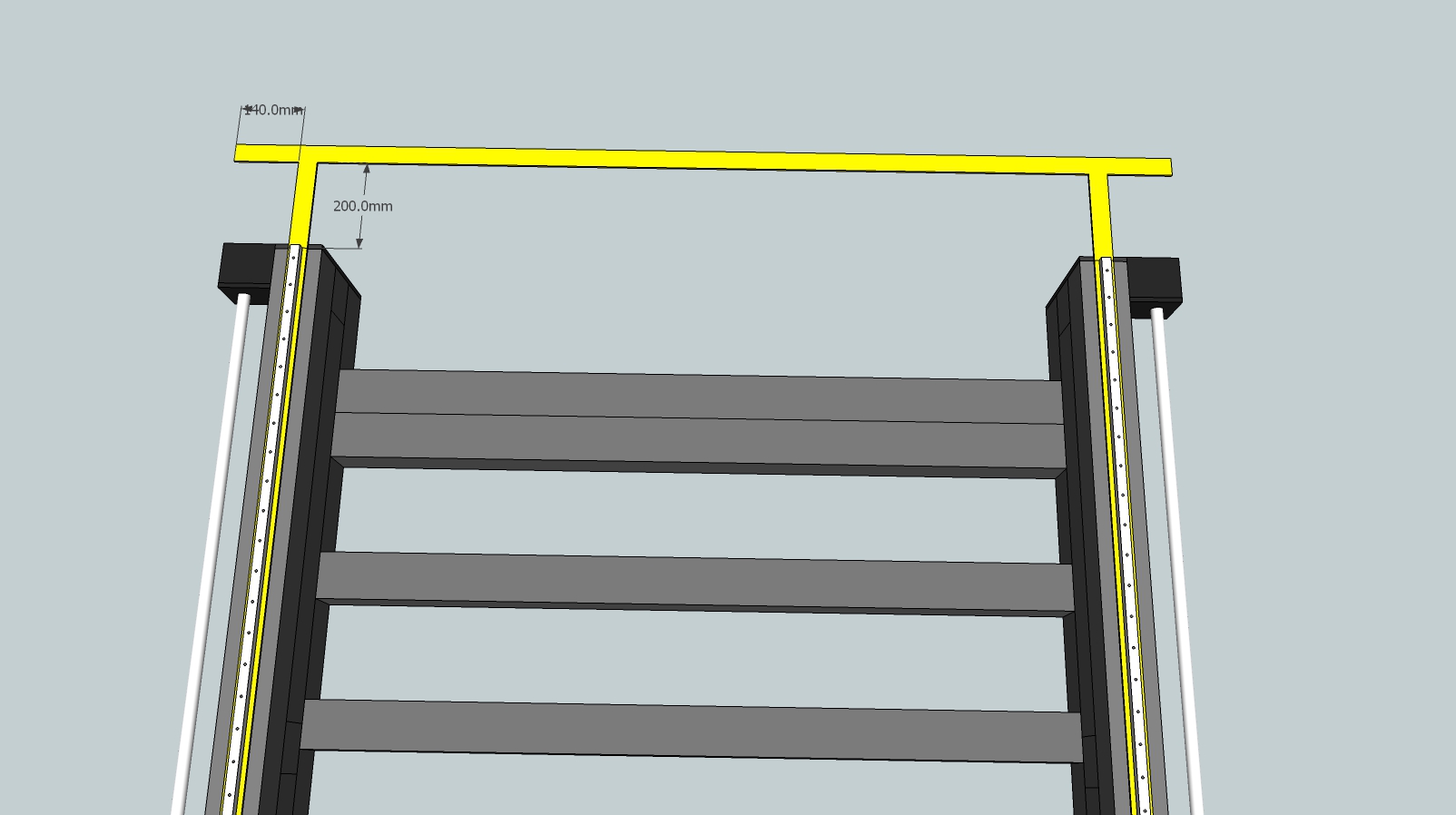

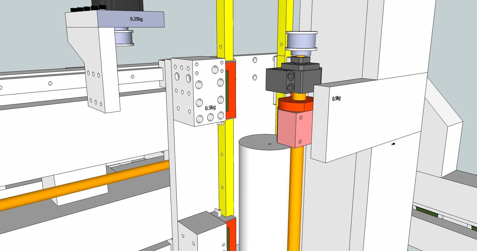

    I forgot to mention...I'm not keen on the placement of your Z-axis ballscrew. If a large force is applied parallel to Z, the axis will begin to skew (i.e. rotate in the Y-Z plane), due to the ballscrew placement being off center. The effect can be reduced by increasing the spacing of the Z-axis linear bearings, or go back to two ballscrews, or get the ballscrew closer to the center. That's why on the new machine I placed the ballscrew intersecting the Z-axis ram - it got it closer to central, but admittedly still not ideal.

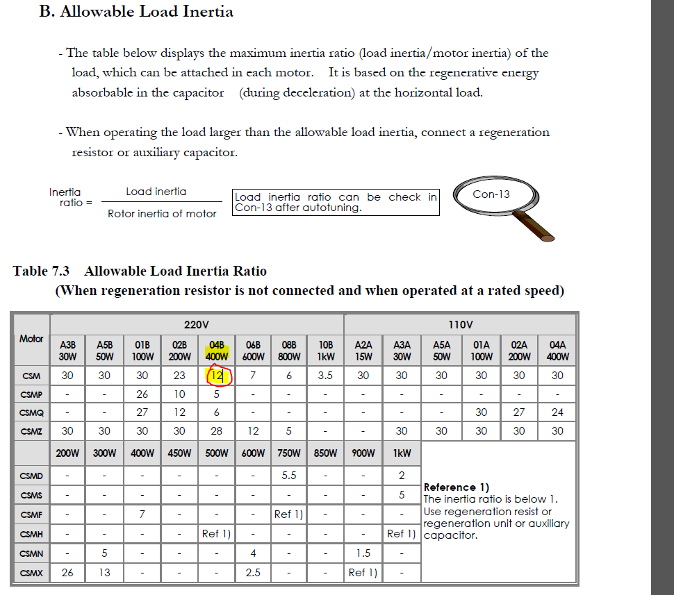

    Some updates:
    Motors:
    Thanks for the help! Now things are more clear there.
    The main option i will go most possibly is 4 servos x 400w or 2x400w +2x750w.
    Obviously from the calculations if 2:1 then 2x200w+2x400w will be sufficient, but as the price difference between 200w,400w and 750w is merely 5-10 euro, i dont see a reason why not going properly bigger.
    The Hybrid stepper option i discarded due to price similar to servos.
    DC Servos and motors from Leadshine are almost the price of AC servos and motors , so 220v seems a lot better choice
    Steppers are still an option, except for the long axis that moves the gantry. However i would like the Z also to be closed loop, due to the vibrations. Plus the price of decent driver and motor and PSU is almost as the price of AC servo, hence the servo decision.
    Another point there is i am starting to doubt about the cheap servos, so i am trying to get for the same price 4 x ACH750 Leadshine AC Servo motor drives + motors. Bargaining with Chinese people takes time :-)
    The Z axis
    The single screw design i am almost 99% sure will be without a problem. Hoewver i decided not to risque due to the impact hammer head and changed the design. Lost something of the beautiful simplicity and acquired annoying amount of pulleys and idlers, but i could not design it better for now. Best would be with 2 stepper motors on 1 drive, i know,not a very good idea, but works/my flimsy cnc is that way on the gantry without any problem, but is flimsy, not rigid like this design/
    So, for now that's how it would be:
ID:	11072Click image for larger version.

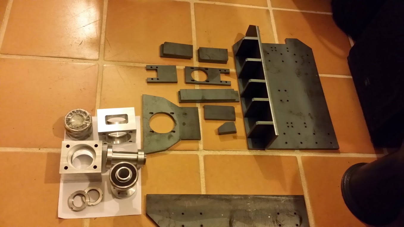

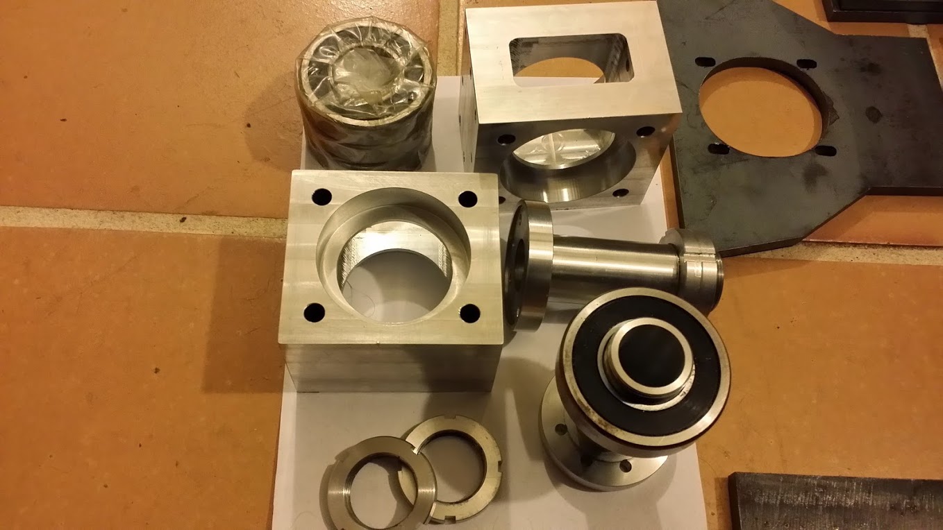

    Rotating ball nut
    At the end i found somebody help me with making it. Jeff, from the forum, who happens to live very near, here in Spain. Wow, what a work shop and machines he has, especially compared to my garage.
    Now as i decided on Servo, may be even will go with double ball nut/all over the machine also/. 1.450kg said Fred yesterday, weights the 2510 double nut. I wonder what the inertia will be, he he.
    I thought of integrating it into the gantry, but at the end decided to fix it aside, due to the possibility to lower significantly the screw length+ avoiding an accidental hit of the gantry to the screw mount
