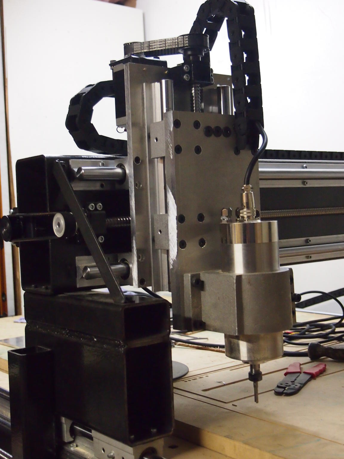

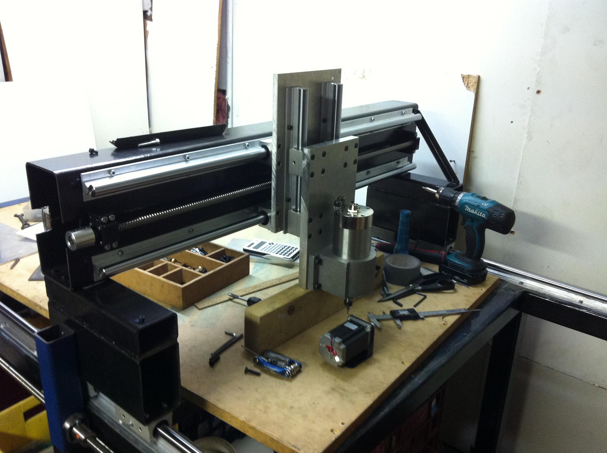

    Here's where the machines at. I finish exams tomorrow so will be working on it full time now
    Nice and pretty now all painted.
