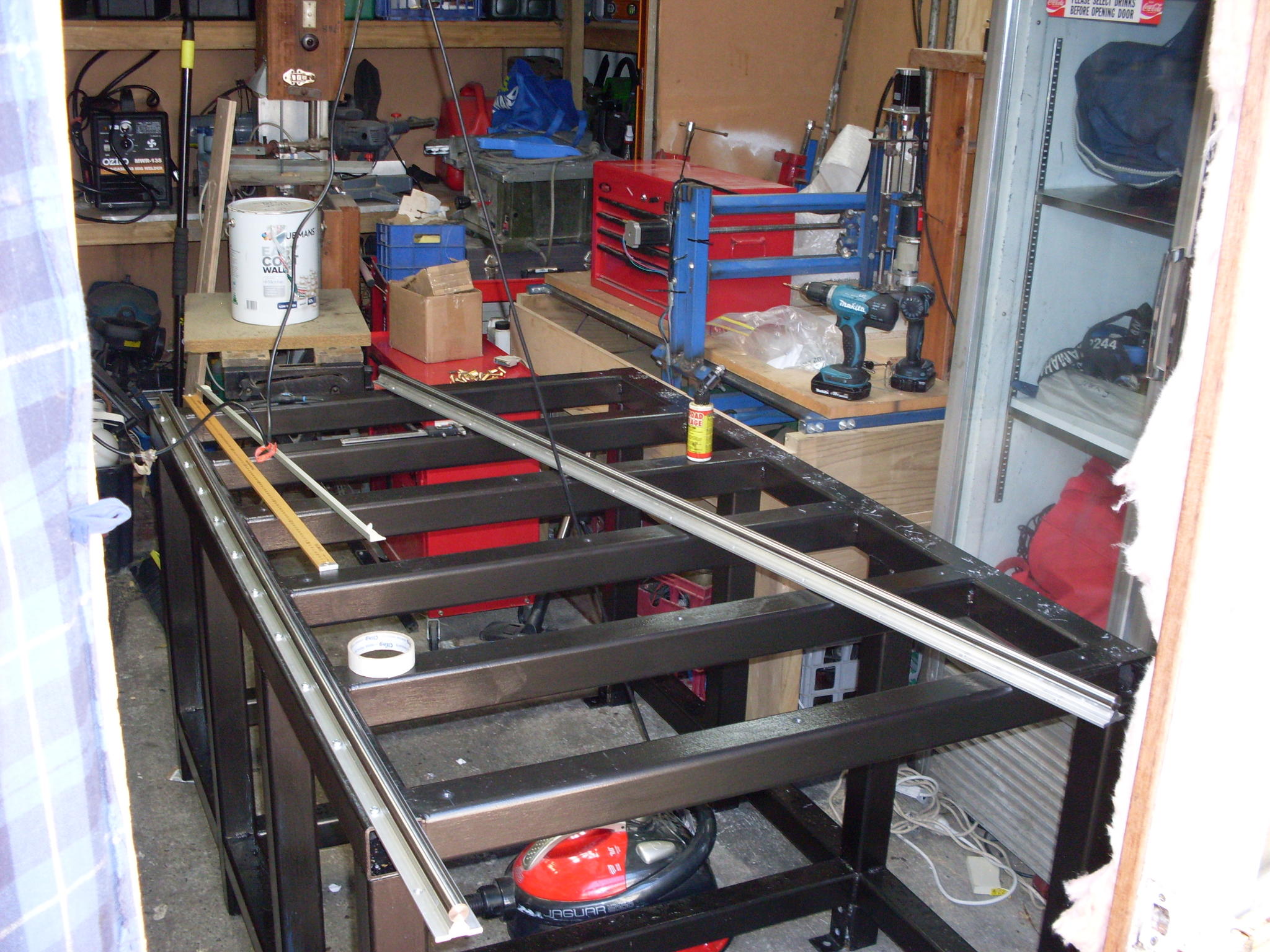

    The frame is made out of 65x65x4 mm box section steel. I think I may have gone a bit over board in this department, I'm sure you'll be able to tell me if its too much or too little. Originally the rails being used (all 20mm fully supported round rail) were going to be 1600mm for x 1000mm for y and 300mm for z. When I went to buy them there were no 1600mm in stock so I got the 1800mm for the price of 1600mm. This also forced me to get 1600mm ball screw instead of the planned 1400mm ball screw. The thing is I had already built the frame so now the x rails overhangs one end by 200mm. Instead of just cutting the rail I thought it would be good to leave it and modify the frame to accommodate it by adding a triangular section under each rail. This will allow me to do cuts that otherwise wouldn't be able to be done.
    To level the table I will be using the self leveling resin method. I've already drilled and tapped all the holes for the x rail so these holes will obviously have to the bolts in them when I do the resin. What do I do to stop the resin from sticking to the bolts?
    Cover them in a little oil?
    I was thinking of using fiberglass resin. Anyone had any success with this? Other options?

    To protect the bolts from resin I just covered them in grease and they came out easily. For the resin you want something with the lowest viscosity you can find and a long setting time, to maximize the chance it has to self level. I'm not sure if the viscosity of polyester resin will be low enough, probably not? The resin I used is west system 105 with 209 hardener.

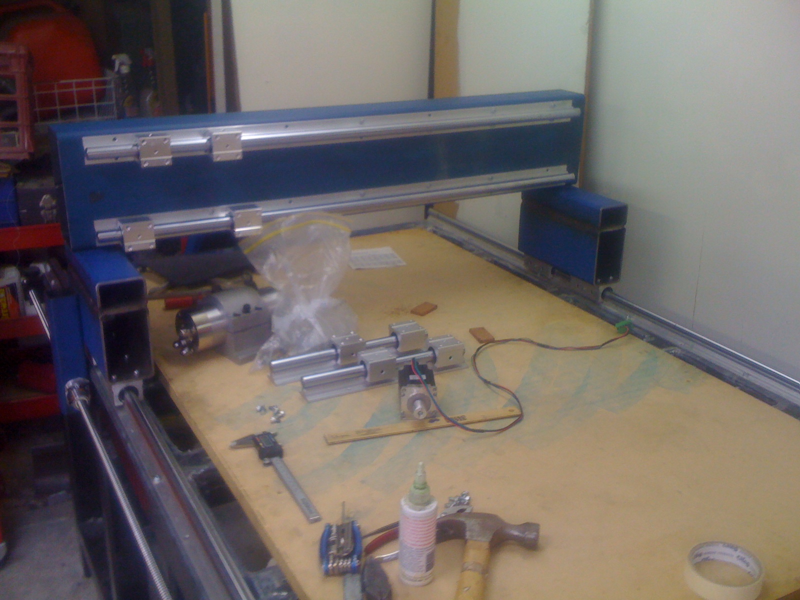

    So the build has been coming along slow as uni is getting in the way.
    I used the west system resin recommended and it worked really well. However it could have been a lot better if i had of sealed the edges better as quite a bit dripped out so there were some low spots.
    The x axis is nearly complete, I'm just waiting on the belt and pulleys to arrive. I ordered 20 tooth pulleys and a 2525mm long 5mm pitch 15mm wide htd timing belt. Belts will also be used for the other two axis.
    I had to use steel for the gantry as no one would supply the aluminium I needed. I could only get aluminium if I brought a 6m length.

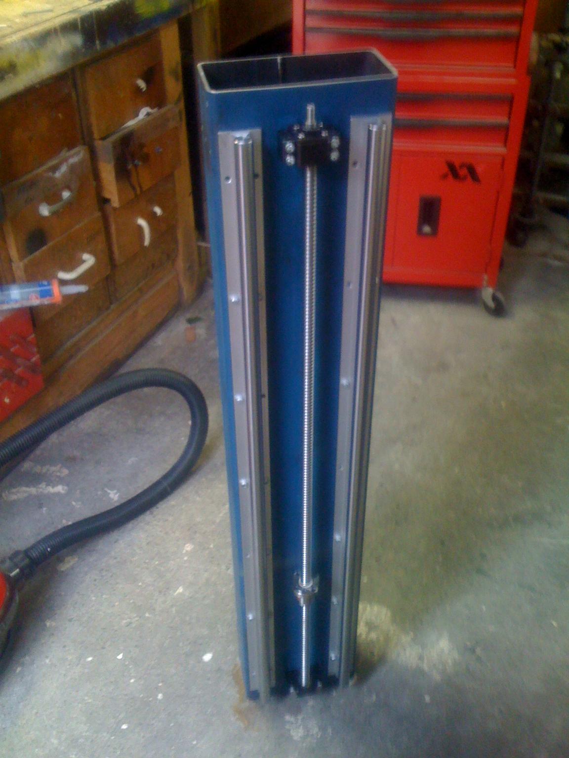

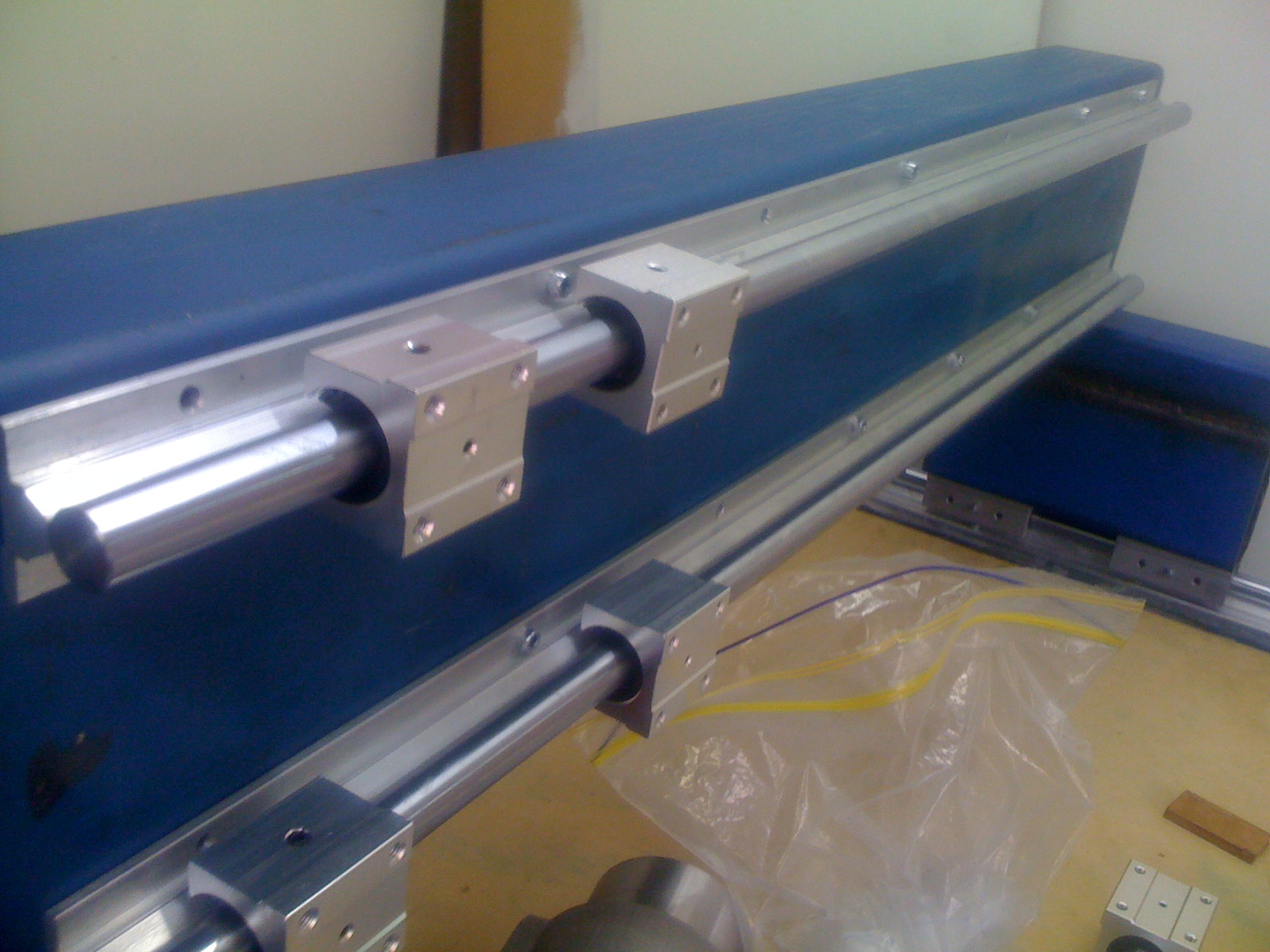

    I'm having a bit of trouble with working out how to arrange the bearings for the z and y axis. I know I asked in my first post about mounting the supported rail so it moves with the spindle but I want to know how important this is?
    I ask because it will save a lot of mucking around if I can mount it the other way with the bearing blocks on the spindle.
    Thanks again

    I think another reason for putting the Z rails on the moving plate is to add stiffness to the plate, you could argue that the rails should not be used to add strength but undoubtedly they will. There are plenty of machines with the rails mounted both ways and likely it will work both ways, it's just that one way is slightly better than the other.
    Machine is looking good by the way, I can see the frame is well put together but I don't see any triangulation such as diagonals. Will you be fitting adjustable feet ? or maybe your floor is flatter than mine. As Jonathan says the 2.2kw ER20 spindle would have been so much better and I suggest you should go this route to have the 1/2" capability.
    I found the round rails to be a bit bulky for the Z axis but they do allow more space for the ball screw.
    I could have done that but a bit meh with the fuss involved.
    I think I will mount it with bearings moving with spindle. It just makes everything a lot easier. I'll take into account the lost rigidity of spindle mount without the rails. 20mm thick aluminium seems to be the standard isn't it? I think it should suffice. And yes having some hywin type rails would be nice but the ballscrew is the limiting factor at the moment as I can't machine into the aluminium so their profile could be lowered. Hmm maybe a project after this is complete is to make a new z axis with hywin rail.
    The table is bolted to the ground in 8 spot(one each leg) so I'm guessing this might mean I don't need triangulation?? Will wait and see. The epoxy leveling was done after. This means that I can never move the machine(as it would have twisted when I bolted it down), at least without redoing the epoxy each time.
