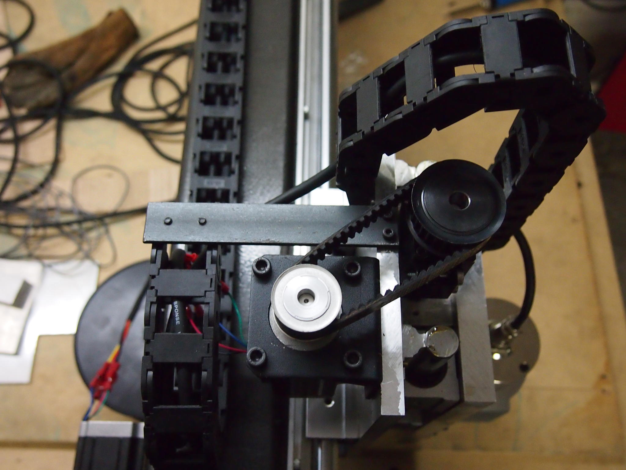

    Sorry maybe I should have been clearer. The belt is too big, i.e. tensioner is needed and have made one. Just not sure how tight to pull it. Is it weird that if I pull the belt tight the ball screw bows inward a little bit? Is this normal. It's 1.6m long. Bows in a few mm.

    Also with the pulleys the length of the bore is about 29mm and it has two set screws. The shaft for the pulley on the end of the ball screw is only 15mm long. Should I be concerned that the shaft isn't long enough? Is tightening down the set screws onto the round shaft fine or should I grind down two flat areas on the shaft for the set screw to tighten onto?

    Yes Grind one small flat the other is fine on round shaft.
    There is another option but requires a lathe to do easily. Bore and Thread the Boss end of the pulley the same diameter has the threads on Ballscrew and use this to replace the Locknut on the Fixed end. This then gives full engagement on shaft and combination of grubs screws and threads lock it solid.!
  5. #14
    Jazz thats a great idea, will look into it, thanks.

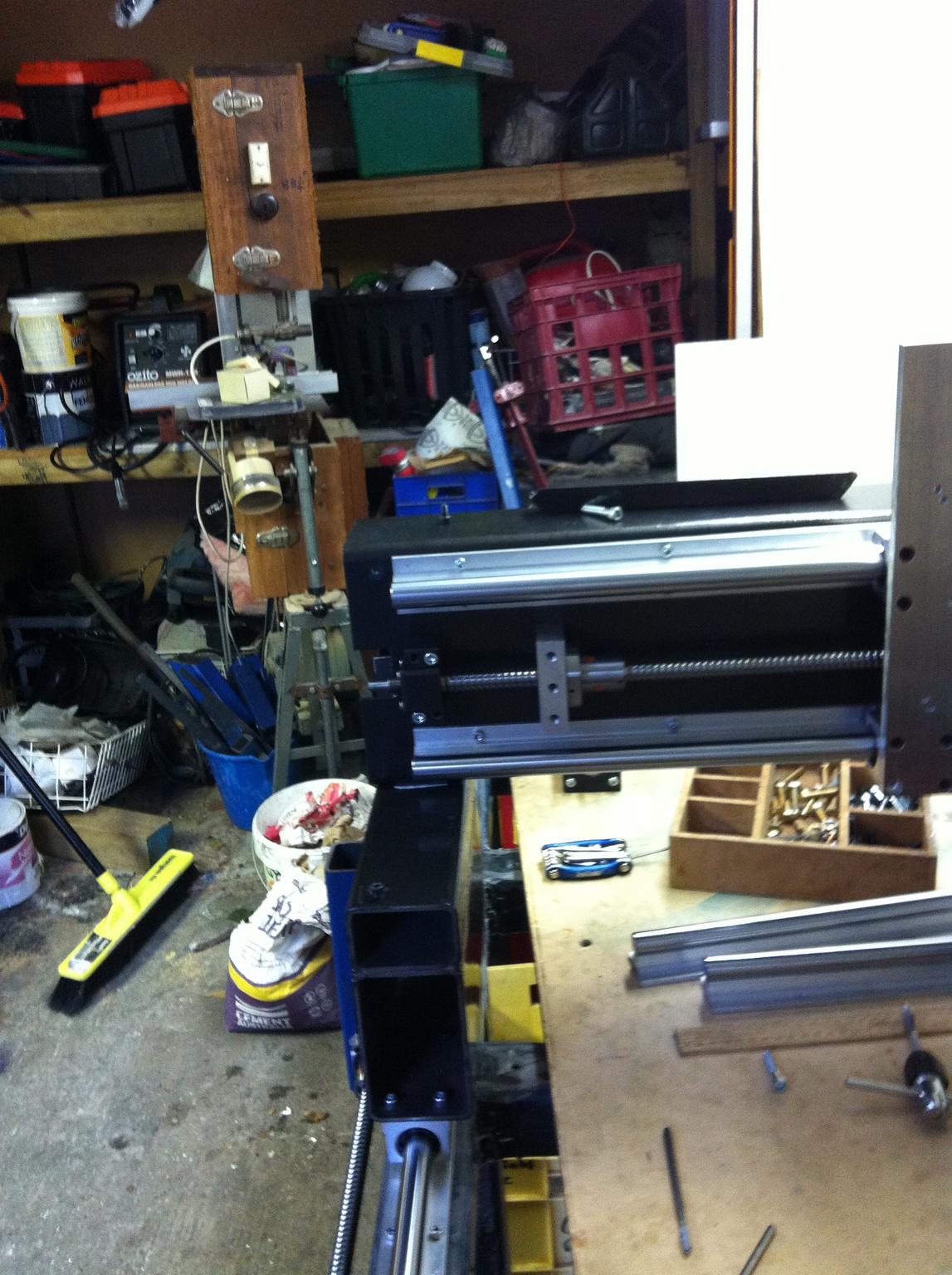

    Thanks for the info, makes sense. I'm located in the south eastern suburbs, Caulfield area.
    Here's where the machines at. I finish exams tomorrow so will be working on it full time now
    Nice and pretty now all painted.
