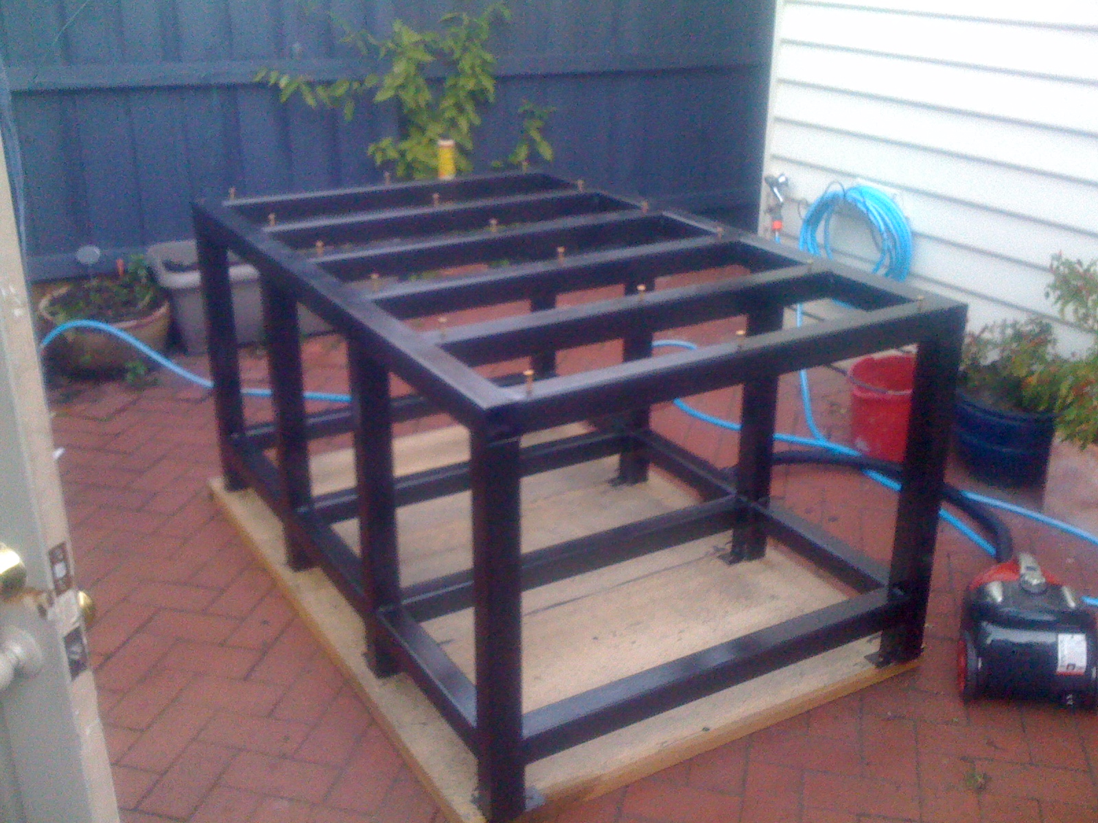

    Been a bit of a dweller and thought I better introduce myself and show my build, asking lots of questions in the process.
    I'm from the land down under, Australia, it seems pretty much all of you are in the UK!
    The Build
    The frame is made out of 65x65x4 mm box section steel. I think I may have gone a bit over board in this department, I'm sure you'll be able to tell me if its too much or too little. Originally the rails being used (all 20mm fully supported round rail) were going to be 1600mm for x 1000mm for y and 300mm for z. When I went to buy them there were no 1600mm in stock so I got the 1800mm for the price of 1600mm. This also forced me to get 1600mm ball screw instead of the planned 1400mm ball screw. The thing is I had already built the frame so now the x rails overhangs one end by 200mm. Instead of just cutting the rail I thought it would be good to leave it and modify the frame to accommodate it by adding a triangular section under each rail. This will allow me to do cuts that otherwise wouldn't be able to be done.
    To level the table I will be using the self leveling resin method. I've already drilled and tapped all the holes for the x rail so these holes will obviously have to the bolts in them when I do the resin. What do I do to stop the resin from sticking to the bolts?
    Cover them in a little oil?
    I was thinking of using fiberglass resin. Anyone had any success with this? Other options?

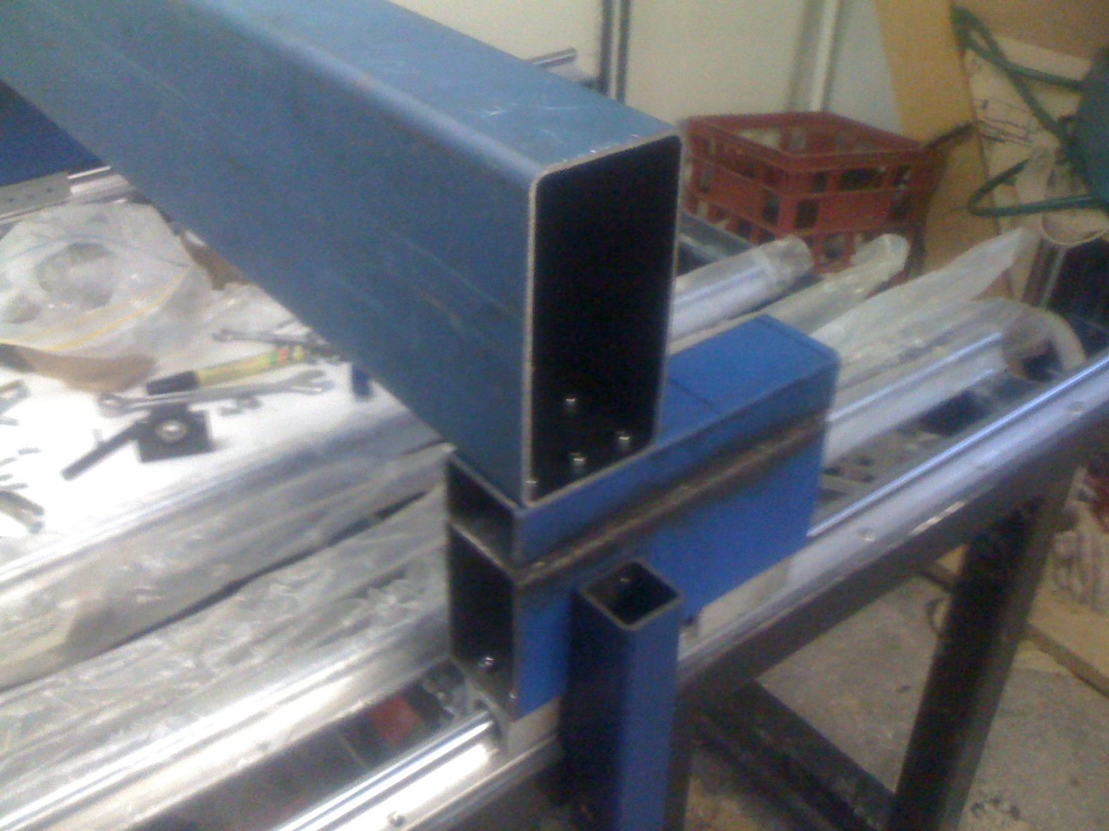

    Now the gantry.
    I really cannot find anyone that can supply any suitable aluminium section for the gantry. This means that I have to use steel. For a length of 1.2m do you think 200x100x3 mm will be sufficient? I'm a bit worried about the weight of it. That section just mentioned will weigh around 12kg. The two sections that will hold it above the x rail come in around 13kg. Thats around 25 kg with nothing else added or accounted for. The x axis is moved by a 425 oz-in nema 23 motor. Will this handle it? It will be run with 1610 ballscrew, one on each side with belts. 5mm pitch 15mm wide htd belts and pulley will be used. Thinking a ratio of 1, can be swayed either way though to change this ratio.

    To protect the bolts from resin I just covered them in grease and they came out easily. For the resin you want something with the lowest viscosity you can find and a long setting time, to maximize the chance it has to self level. I'm not sure if the viscosity of polyester resin will be low enough, probably not? The resin I used is west system 105 with 209 hardener.
    Don't concern yourself too much with the weight of the gantry. What's more important, to have a strong machine or a fast machine? Your answer is almost certainly the former, so make it as strong as you can and then worry about possibly needing a bigger motor. Since you've already got the motor you might as well try it, but 3Nm is a bit on the small side. If you got another of the 425 oz-in motors and drivers, then connected one to each X-axis screw you would have enough power to move (at least) a 50kg gantry at a decent feedrate and acceleration.
    Shame you got the 1.5kW spindle not the 2.2kW one. The 2.2kW spindles come with ER20 collets, so instead of holding up to 10mm tools they can hold 1/2" tools. That's useful if you want to use cheap router cutters.
    Generally putting the rails on the part of Z that moves up and down reduces the overhang, i.e. the distance between the tool tip and the linear bearings.
    Have you done a drawing of the gantry? It's a bit late now but it would have been easier to make a strong machine if you'd gone for an adjustable height bed and had the Z-axis working below the level of the X-axis rails, like in my build logs. Still, if you're not planning on cutting metals then you'll get away with it.

    I think another reason for putting the Z rails on the moving plate is to add stiffness to the plate, you could argue that the rails should not be used to add strength but undoubtedly they will. There are plenty of machines with the rails mounted both ways and likely it will work both ways, it's just that one way is slightly better than the other.
    Machine is looking good by the way, I can see the frame is well put together but I don't see any triangulation such as diagonals. Will you be fitting adjustable feet ? or maybe your floor is flatter than mine. As Jonathan says the 2.2kw ER20 spindle would have been so much better and I suggest you should go this route to have the 1/2" capability.
    I found the round rails to be a bit bulky for the Z axis but they do allow more space for the ball screw.

    I'm not an expert on cnc (yet ) but from your pictures, my past engineering life and what I've learned from this forum, I'm thinking the square tube bracket down to the x axis ball screw is not strong enough. It would be better if there was a triangular fillet each side to prevent flexing, I can imagine it vibrating causing tiny oscillations.
