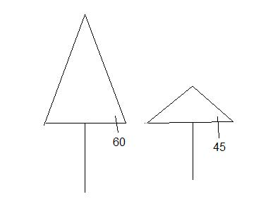

  7. #6
    With Excel you have to remember that the TAN() function uses Radians for the angle so the PI()/180 is to change the angle into radians.
    So if you use just a calculator it would be (requiredDiameter/2) X tan(angle in degrees)
    These are the angles reffered to.
Name:	v cutter.JPG

  10. #8
Name:	v cutter.JPG
    Just spotted your diagram with the angles, I think i had the wrong angle in mind...
    So...if my cutter has a 45 degree angle at the cutting head (top of your diagram) that would mean the angle I need to use with the formula would be 67.5?
    (180-45)/2 = 67.5
    Is that correct?
  11. #9
    V-cutters are generally specified by the included angle, i.e. the angle at the tip. In that case the formula is:
    Z=d/(2*tan(a/2))
    Where:
    Z=depth of cut
    d=diameter cut
    alpha=tip angle, as above.
    So for example, lets say you have this cutter:
    4x40°x0, 1mm V-type Solid Carbide Engraving Tool Cutter f. CNC Engraving Machine | eBay
    The angle is 40 degrees, so suppose you want to cut 1mm wide:
    Z=1/(2*tan(40°/2))=1.37mm
    However, there's an error since we've assumed the cutter has a sharp point when in reality it's got a flat, which makes things marginally more interesting, hence why I decided to make this post.
