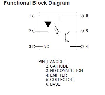

    Birchy - Errm. Yep. A thorough lack of understanding would probably be the main one... I'm right in thinking that a 3 wired switch can be used NC and NO and the only detrimental effect in my application is it being a bit untidy..?
    Irving - Sorry mate, you're speaking to an electronics Dunce - I sat there looking at those circuit diagrams and all that happened is that I began to sweat... There's zilcho documentation with my BOB so I'm not entirely sure which of the diagrams applies to me. I know that it (my BOB) does feature optocouplers, but have read that they're best ignored (very slow apparently). Dunno where that leaves me. Let's say I do eventually find BOB documentation - are you just using a resistor to limit the voltage going into the BOB.
    Any chance of a layman's explanation of the theory of how this is achieved..?

    Wal I believe that your switches have a 10k inside them already and if I am not mistaken there is a 330r on the bob I am sure Irving will come along and draw you a diagram ..Clive

    Right, I think I'm beginning to see a bit through the fog of stupidity (thankfully not the magic smoke...)
    This (thanks go to lateAtNight):
    Attachment 9903
    Along with this:
    ...have made things a bit clearer..!
